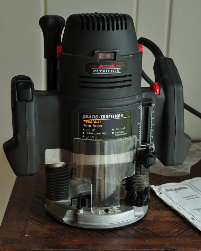

/ Squaring up rough cut oak boards #10
I didn't know that about a router, and never thought to try it.
Thanks,
Eddie

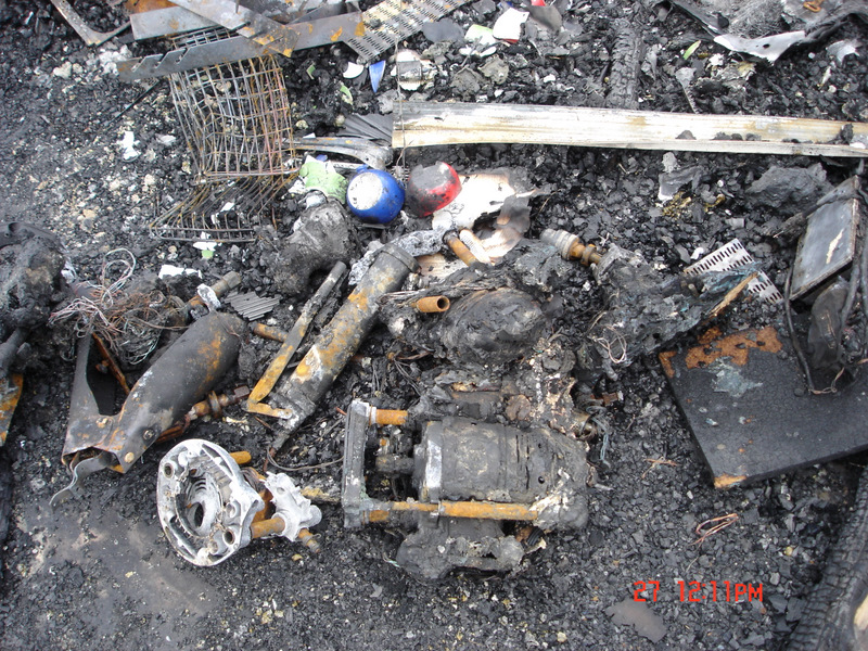

I had 9 of these that I bought as junk for $6 each. :eek:
After I fixed them I had to scratch my head come up with ways to use them. :D:D
I no longer have that problem:( There 5 of them in the second photo:eek:
/ Squaring up rough cut oak boards #11
Steve C
That is a very sad picture there. Turns my stomach to look at it, and what it represents. Hope your outcome was just a bit fair to you in recovering some of your things.
