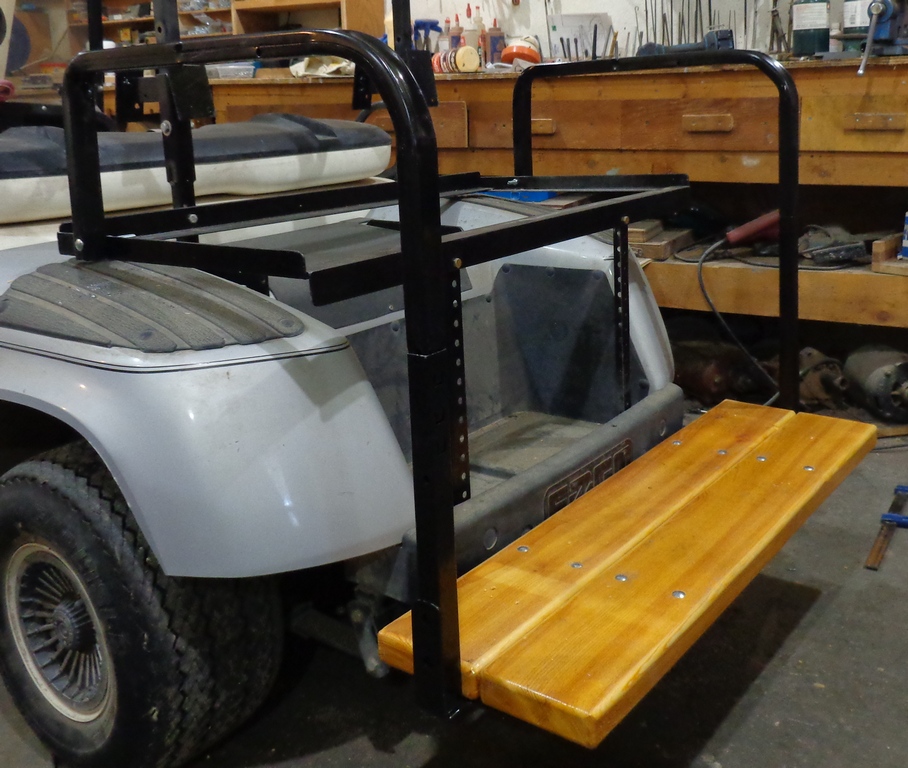

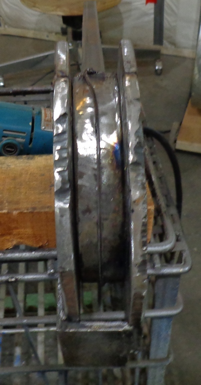

I made myself a bender just the other day . The tubing I was bending was very high tensile ( top rail for a garage dr. opener) but it's what I had and I didn't want to spend any money for the project just putting in time in the shop where it was warm.
You don't want any more than a 1/16" tolerance over the width of your tubing I used a 5/32 welding rod centered to collapse the inside of the tube which is necessary to keep the sides of the tube from flaring & splitting.
Only had 4 bends to make so didn't spend a lot of time being fancy making it but had good results.
/ Square tube bender #7
Billrog....those bends really came out nice...
/ Square tube bender #8
VERY NICE JOB.. all the way around.. I really like the foot rest too.!!!
What are u using for the back seat..?? factory seat?
Mine came w/ the back seat but my MAIN seat frame{wood} has rotted.. IF u were "making" the rear seat, I'd be interested in the process.{pics}
I went to a g.cart dealer & asked if they ever heard of a "poly" frame.?? They said no, just wood.. I think they just wanted to sell me a used 1 for 80.00.??
I find it hard to believe that NO ONE has come out w/ a "plastic" front seat frame to build off of.. They have them for boat seats..
Anyway> GOOD JOB..

Nice job on making your own dies to work with those pipe benders.
Hats off to weldingisfun and billrog.
