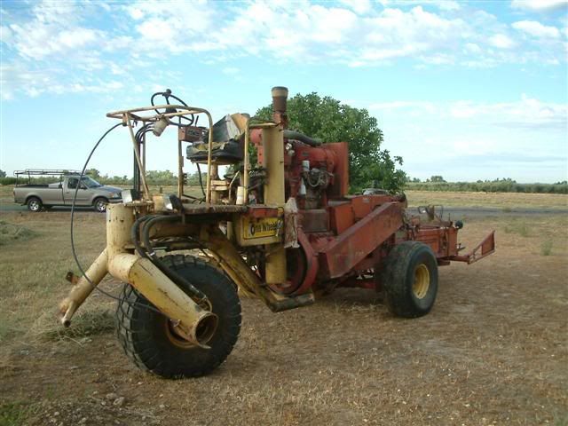

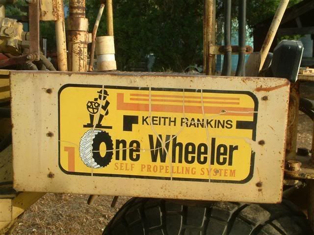

Regarding your second question. My neighbor bales his alfalfa with this old self propelled NH 500 3-twine baler
IRRC, he paid about $2500 for this setup. I don't think that One Wheeler gizmo is still being manufactured. Too bad. That baler is really neat and it moves like a ball bearing pussycat.

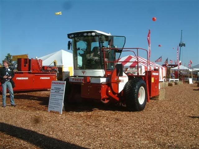

I saw a new Freeman self propelled baler at the World Ag Show in Tulare last month. I didn't bother to ask the price for fear of cardiac arrest.
Freeman Self-Propelled Hay Baler
