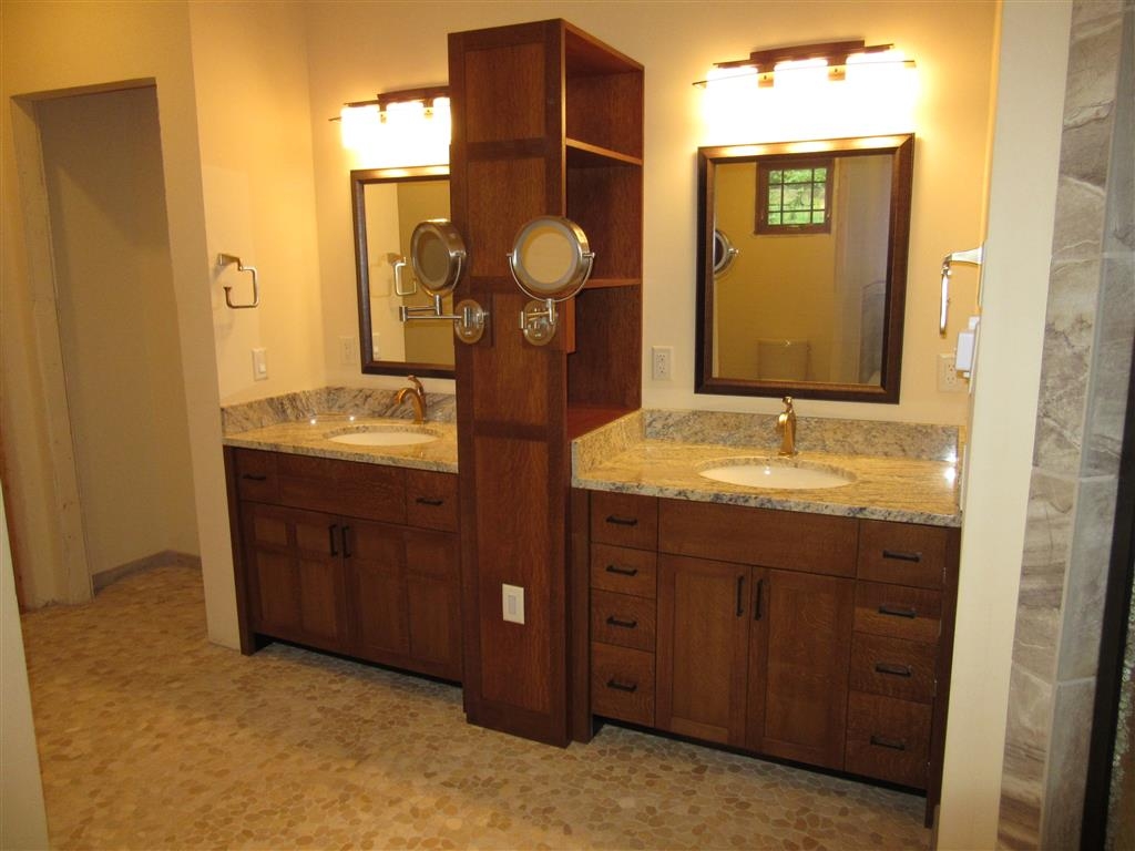

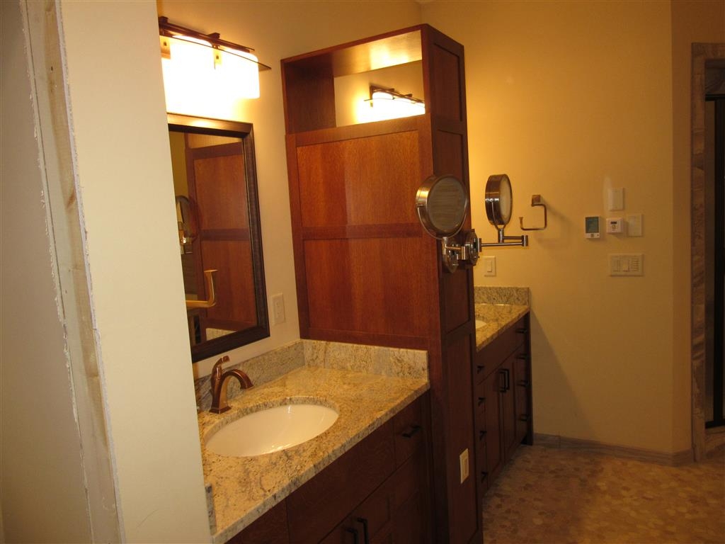

Eddie made many great points, as usual (y) But - On the door size, to correct his one minor error, 36" is the ADA min width, not 32". And trust me, that is a MINIMUM. My wife broke her femur a few years back and was totally off her feet for 8 weeks in a wheelchair. I made all the main doors on the main level 36" for this very reason (future ADA needs). A wheelchair barely fits through them and you need to be pretty precise going through or you are going to lose some fingers too. I was surprised how tight it was as 36" doors are pretty darn big for most houses.
For the master BR, I made ours a bit smaller, like Eddie suggested, as I made a huge master closet with upcoming built-ins (kinda that last thing on my construction list these days) instead of dressers and such in the MBR.
MBath - I hate looking at my wife's pile-o-crap so I split the sink area in 2 like this. You can guess which side is hers with all the shelves.... I put in 2 lit mirrors as shaving/make-up mirrors. Very handy as my eyesight gets worse with time. They are magnified on one side.

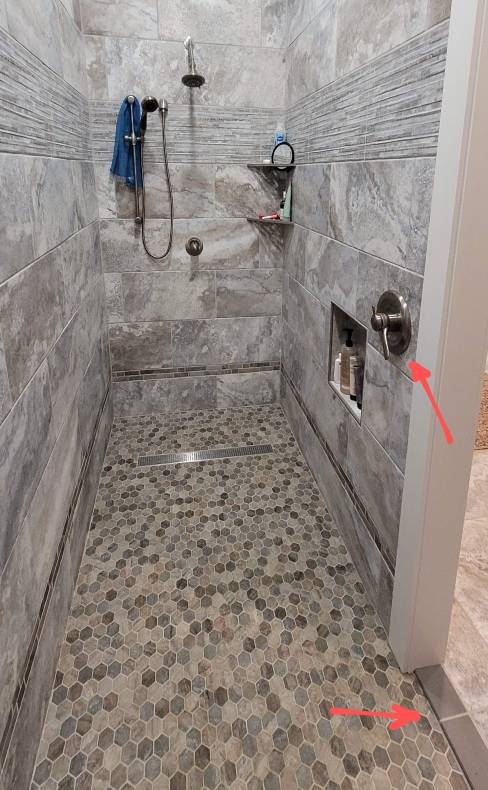

We did the 36 inch doorways...primary layout with master on a single level.
Also designed the master shower as curb less and walk-in, plus big enough to turn a wheelchair. It looks narrow in the photo, but it's 4' wide.
The other thing that had my builder scratching his head was asking for the shower controls to be plumbed by the doorway, not below the shower head. Now we can turn on the water and let it get hot without getting wet...(but it's really for the future should I ever need to help my wife shower without me getting all wet!)

Bathroom layout has to be done extraordinarily well for it not to be a problem for wheelchairs.
Love the cabinets!!!
We did the same thing for our house that's in construction.
