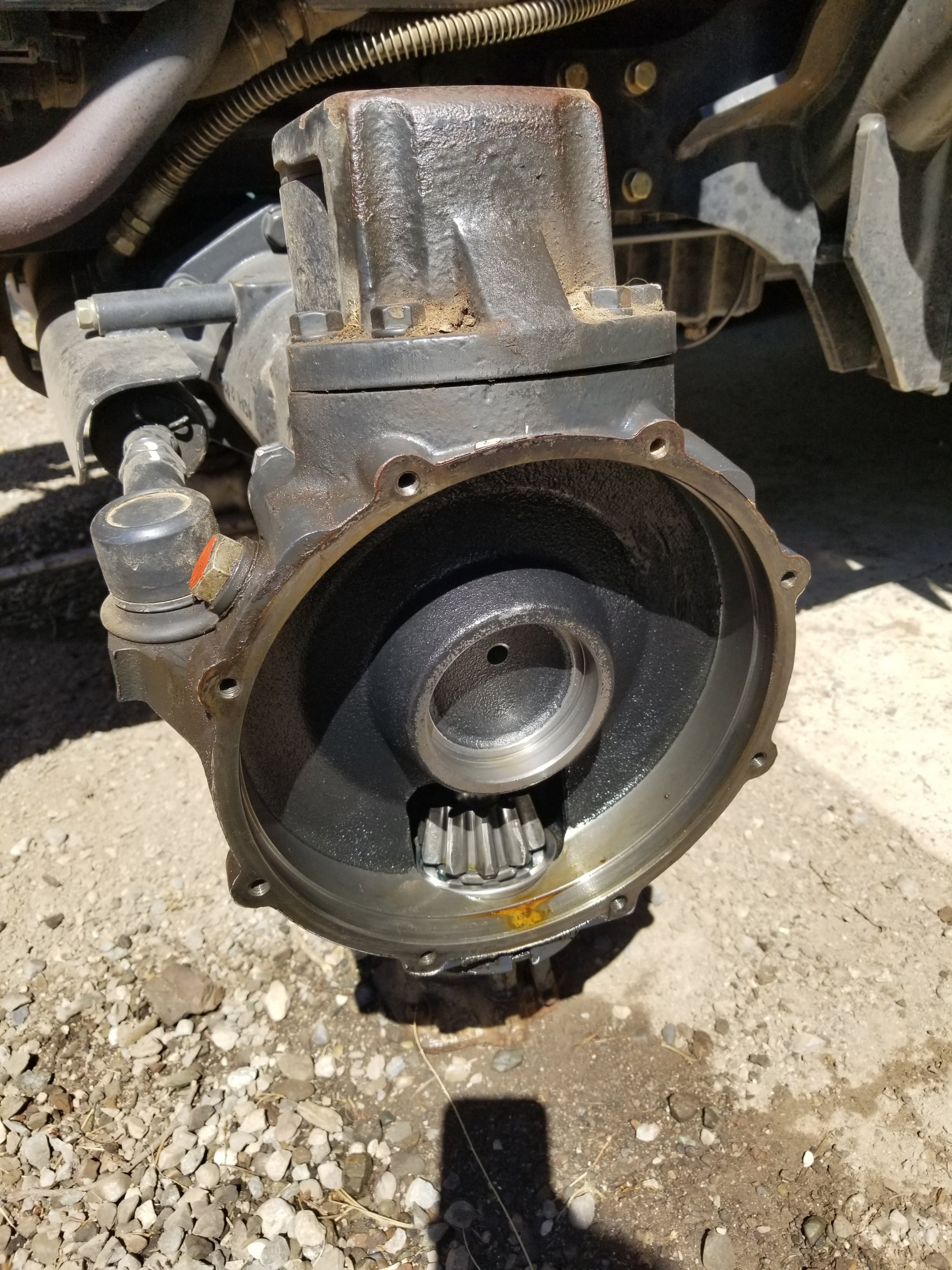

cra*..... was out moving some simple logs and i felt a grinding up front end. immediately shut it down and went to look. oil pouring out of left front axle.

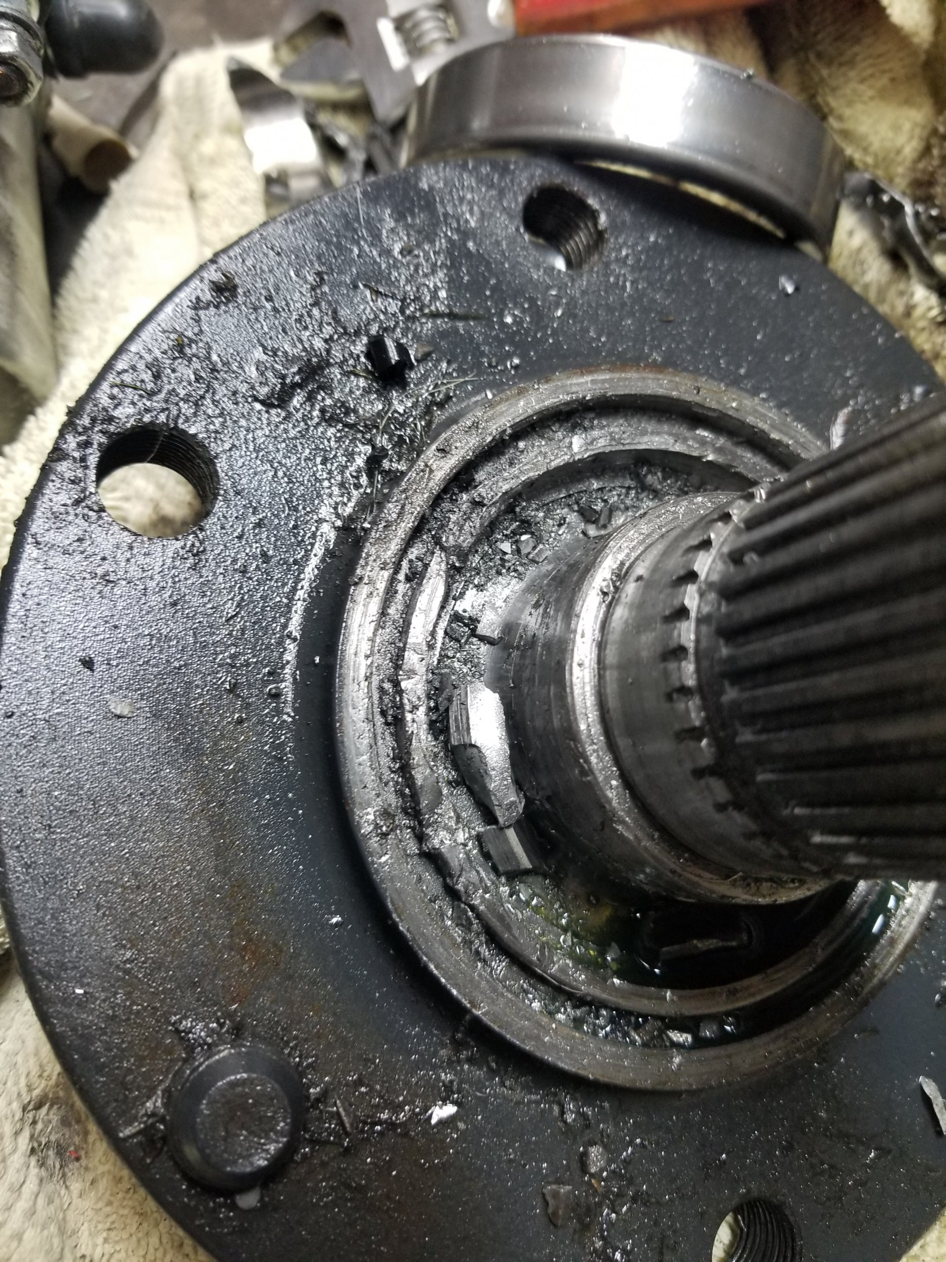

pulled wheel and removed axle housing. broken bearing took out outer cover and axle itself. no damage to bevel gear or anything on the inner axle thank goodness. inner bearing looked fine.
had no inclination anything was amiss. no leaking or anything. have 1400 hours on machine.

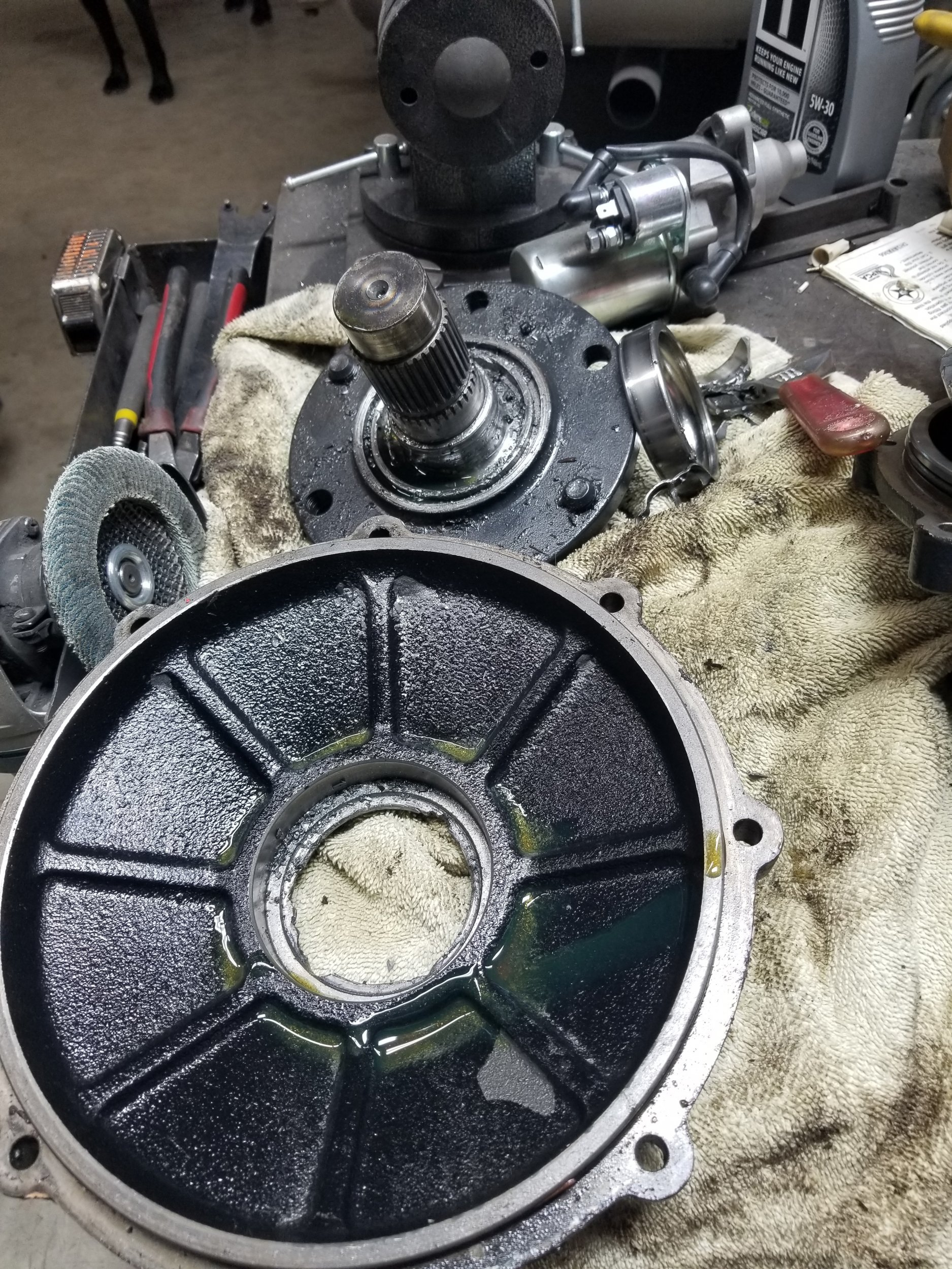

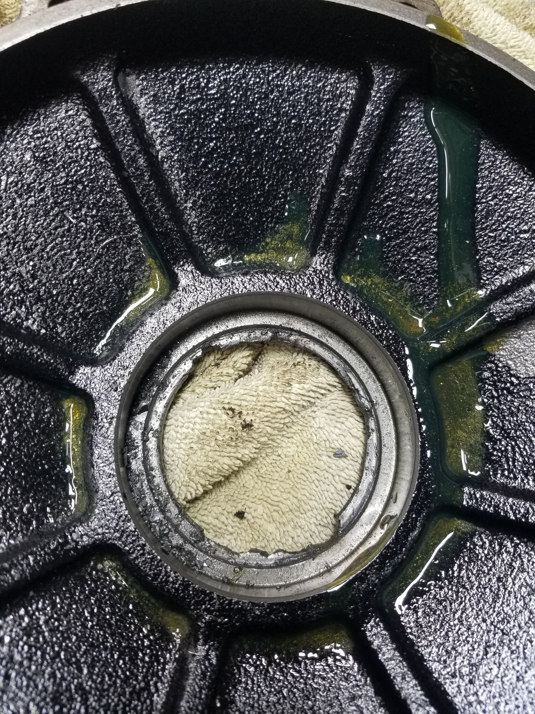

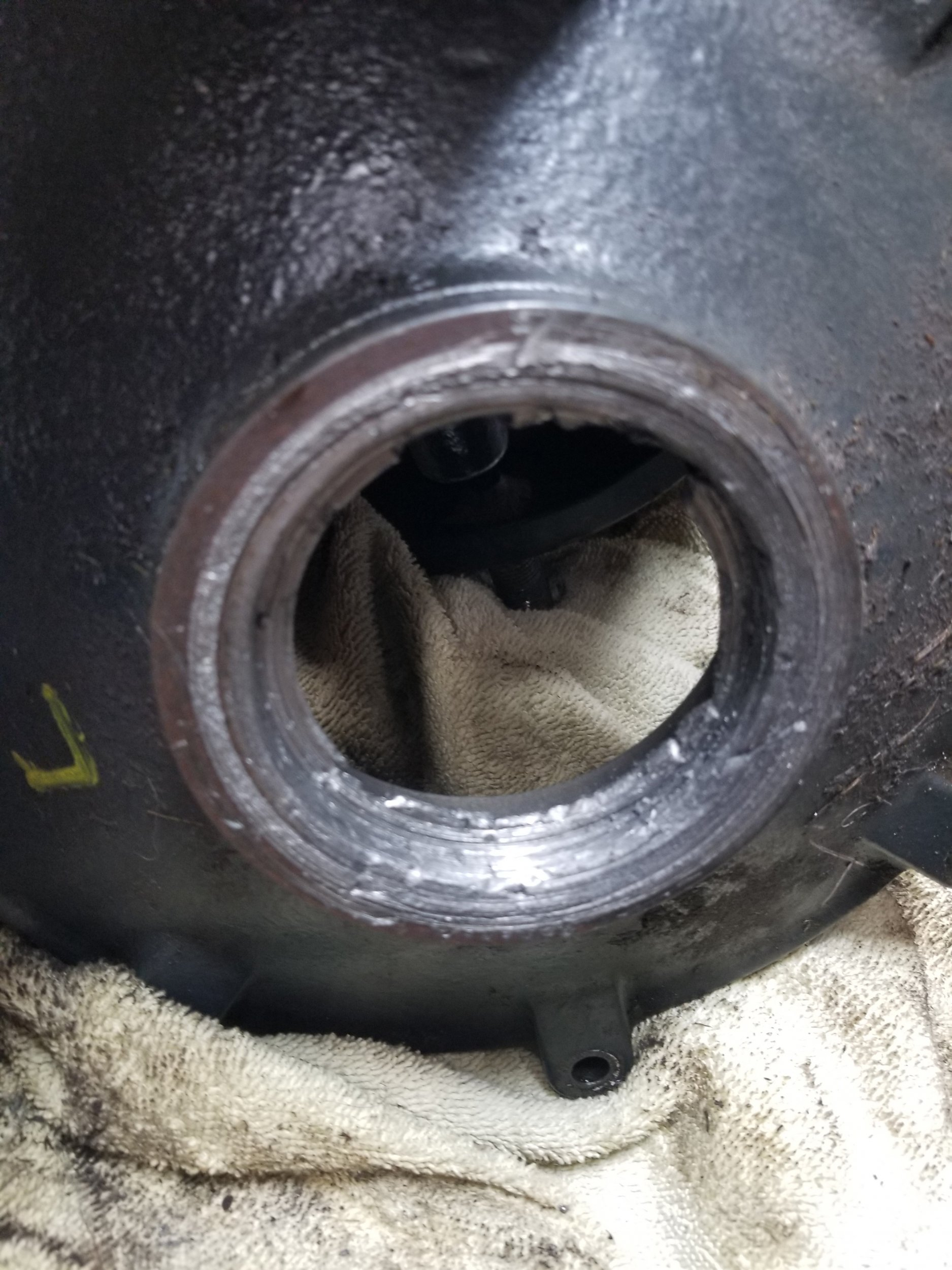

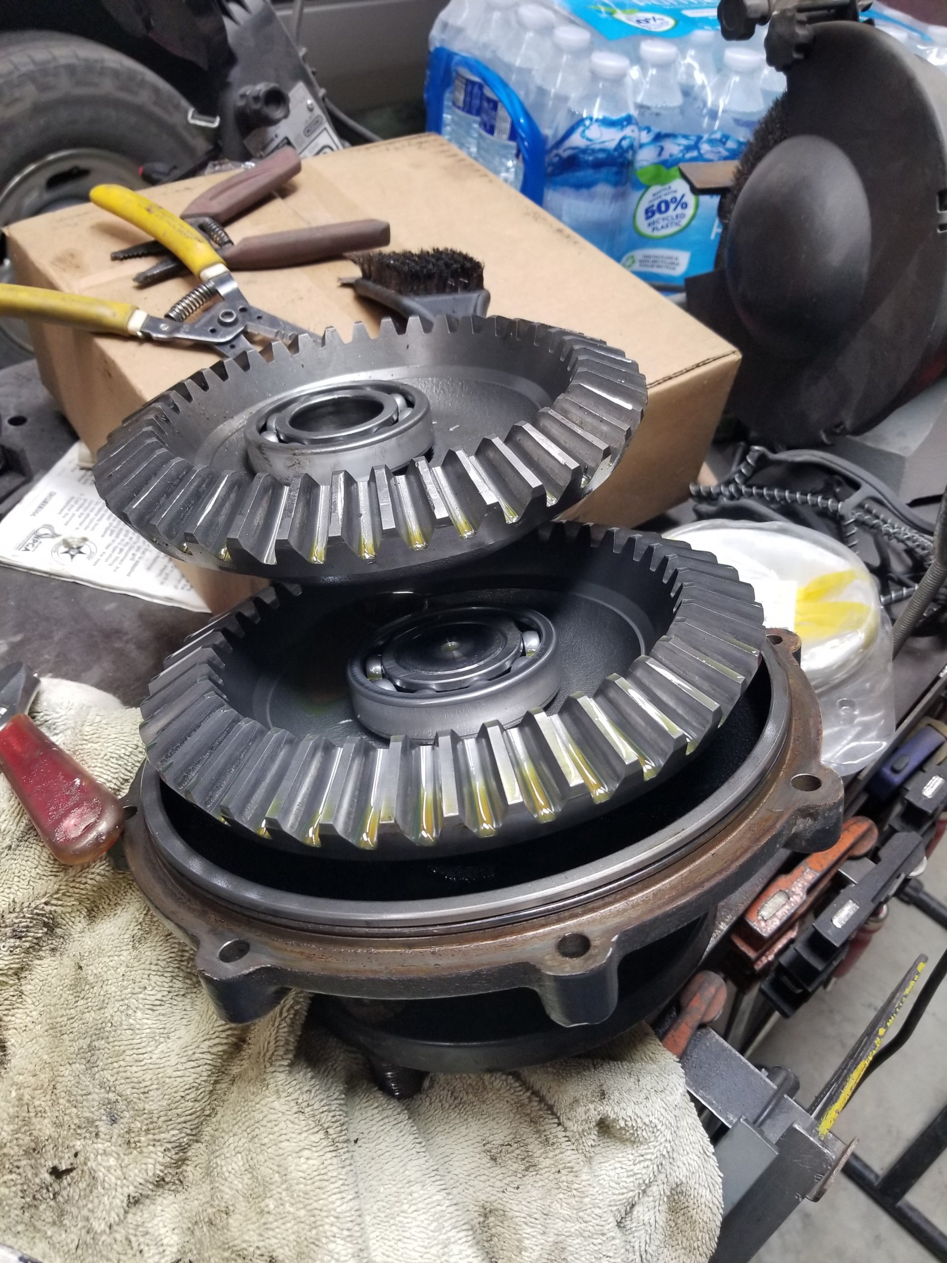

not really sure what happened. judging by the amount of 90 weight that spilled out, it wasnt low on fluid. i changed fluids last summer. when parts come ill split the other side and take a look. it could jut be a freak occurrence, but im not taking a chance with other axle. im replacing bearings and seals. ive owned this unit for 11 years now, and this is the worst thing that has happened. no other bad issues. guess im just glad it didnt happen in middle of winter.
its not an issue with the axle or cover, it was a bearing failing. i have no idea who manufactures the bearings kioti uses.
i had my JD870 do the same thing as happened to this tractor at about the 700 hour mark. dealer told me it was just a freak occurrence. now i wonder. that repair cost me close to 2 grand.
here are some pics of the kioti

There is some damage to your bevel gears. I'd look closely for cracked teeth. If you find no cracks, take a file or grinder and dress off any high spots and burrs. I trust you are replacing all of the bearings on that side as they are likely contaminated with metal.
   / spun bearing in front axle
Planning on touching up gear. Replacing ALL bearings and seals both sides. the large gear has no cracks, very minor blemish. Service tech said he wouldnt replace it.
   / spun bearing in front axle #7
another thing I see is damage to the seal fit area. If you don’t get that dressed up (or perhaps you are replacing that completely) you will have leaks down the road.

Well, you have some mildly chewed up gears and the bearing loos like it's seen much better days.
I don't know why Kioti and Kubota (and I assume other builder as well) use ball bearings in the outboards instead of tapered roller bearings. Tapered rollers can withstand higher loading much better than ball bearings as the contact surface is much greater. Big ag tractors all use tapered rollers.
I worry about mine all the time but so far no issue. I personally believe the use of ball bearings in the outboards is a ticking time bomb.
