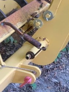

Looking for a source or ideas for replacement springs for a Gannon H120 Box Blade. There are two springs on each side, one which operates in a radial manner on a rod, housed in a tubular housing with a second traditional pull spring attached to the extended arm of the first spring. I haven't had any luck searching online, hoping someone here might have run into this issue before.

Have you already tried Woods since they own Gannon now?

Not yet, I did find an old thread on here that did fortunately have the part numbers that I need! It should make the search that much easier!

Thats a hefty spring. Usually smaller ones i can come up with more possible replacements. One that size, only thing that comes to mind aside from the actual correct replacement part, is maybe some trip springs from a small snowplow. Or.. tensioner springs from large belt drive mower decks. Or maybe ‘porch spring’ / ‘screen door spring’ / ‘storm door spring’? Not sure best term for that one.

Woods did aquire Gannon, but has since dropped the line.
There is a dealer in California that may have the springs, but not sure what happened to the Gannon line.
Alternately, both Gearmore in California has copied a lot of the Gannon scrapers and may have springs.

These guys have a lot of different springs in stock and I've actually had them make custom springs for projects before

I didn't know it either and not sure why, but if you look at Woods site, the only thing left is a downloadable manual for hydraulic scrapers. No Gannon parts come up. There has been a lot of realignment in the Woods company if you poke around on their site.
The Demo PowerSports has all the parts books online, but not sure what the deal is with parts. These guys are located not far from where Gannon was produced in California. I am going to call them Monday to see if they can shed some light on Gannon, but Deere bought the plant in Thibodaux. LA that makes box scraper knockoffs for them and companies like Gearmore in California have made a copy for years now.

There's a company called Demo Powersports that stocks them under "Woods H-120 Manual Landscaper"
Part numbers H056A, H056B, H013, E013
