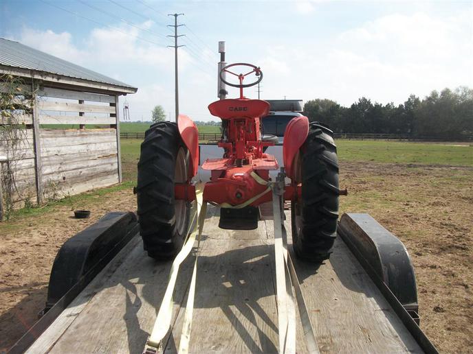

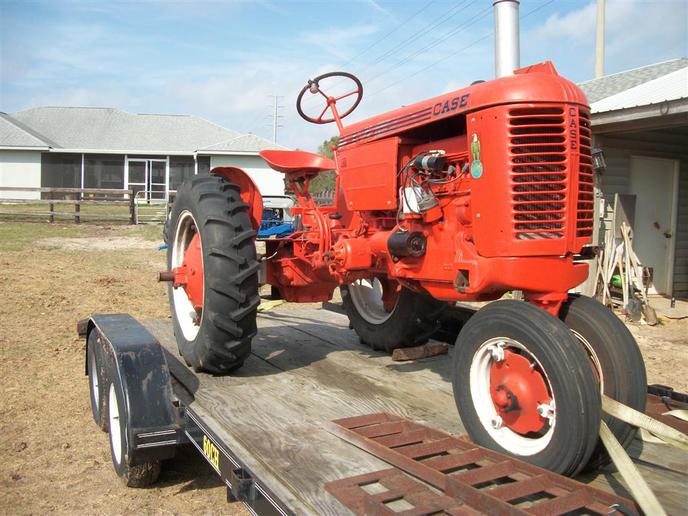

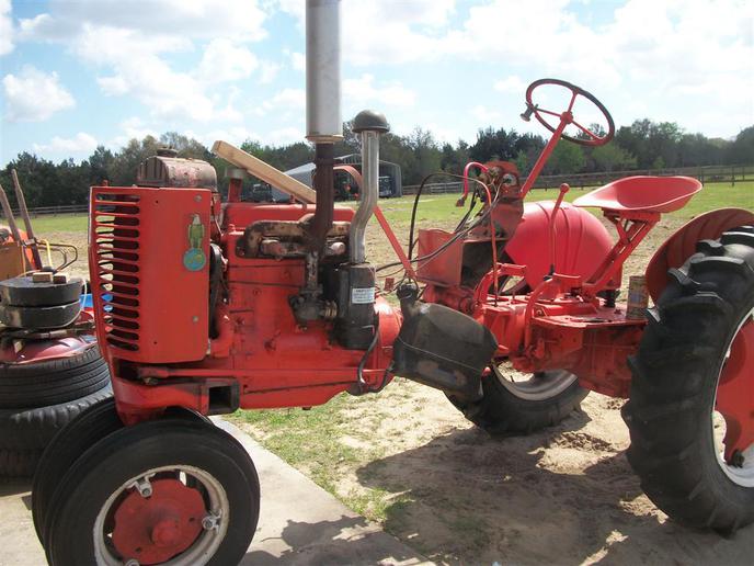

here's my spring project.. a late 40's ( 49? ) VAC

Nice looking VAC..!! Is that the reservoir, for some sort of hydraulic add on, there on the left side, by the fuel tank..??
/ spring project, VAC
What's wrong with it?
holy fuel tank
25+ leaks :)
lowish oil pressure
NO generator or alternator.. just an empty spot on the block :)
a few body and maintenance issues...
tires 100%
soundguy
that's a lawnmower gas tank feeding the carb.. :)

They weren't exactly known to have a lot of oil pressure. When working on my old 310B, I read where 12 to 25 lbs. can be the norm, after warm up. Note the partial flow oil filter... Kinda' scarey seeing just a few those big coarse threads... I bought a case of 12 through Fleet Filter, and split them with a buddy of mine for his small A-C's. Quite a savings that way.
Always wondered about torqueing the heads on the right side. Never had to remove one, but sure doesn't look like room to get a socket, and head of a torque wrench on there.
So is the upside down spinner for steering from the ground..??

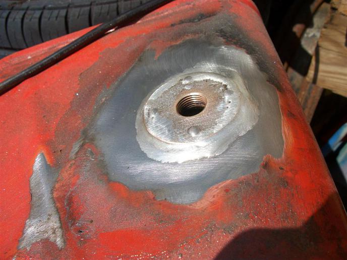

got home from work ealy and pulled the gas tank out of the soapy water vat, wire wheeled the flange at the bottom where it joins the tank.. i can see a ban solder joint there, and a bad old reapir.
fluxed it up, and ran some plumbing solder around it... cleaned it up with the wire wheel and a red rotary disc, flipped her over and filled with water and let er' set.. no leaks...

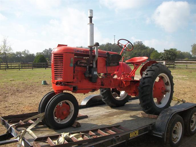

got some more of the tin pulled off.. she's all but naked now.
cut some patches for a couple small pin holes inthe side panes and noste i found.. stitched those in.. they are now ready for bondo.
havn't even touched the hood yet.
repacked the front wheel bearings..
cleaned up the fuel tank tap and it's read you reinstall after paint and whatnot.
bought a couple quarts of perimer in anticipation for a painting day .. soon maybee..
here's a pic of the solder joint and naked tractor so far..

Lookin good. How much rust (if any) came out of the fuel tank? The tank on my BF was loaded with interior rust and had a few pinholes.
#17
no rust.. is shiney and bright inside.
when the prev owner stopped using it due to the leak, it looks like he put a couple ounces oil in there.. looked like 80w, and then closed the fuel petcock, and put the cap on... preserved it 100% just had a cracked solder flange at the bottom somehow.. was easy to celan up and resolder..

well, today got eat up by busy work. lots of sanding and buffing and bondo . hood side panels are primed. hood is rough sanded, and still has a couple spots of glaze putty that needs sanded.. then needs finish sanding. same with nose.
tank is ready to be sanded.
all i had time for before work.
thank goodness for heatguns. used them to strip decals last night after work.. to help me get to sleep..
