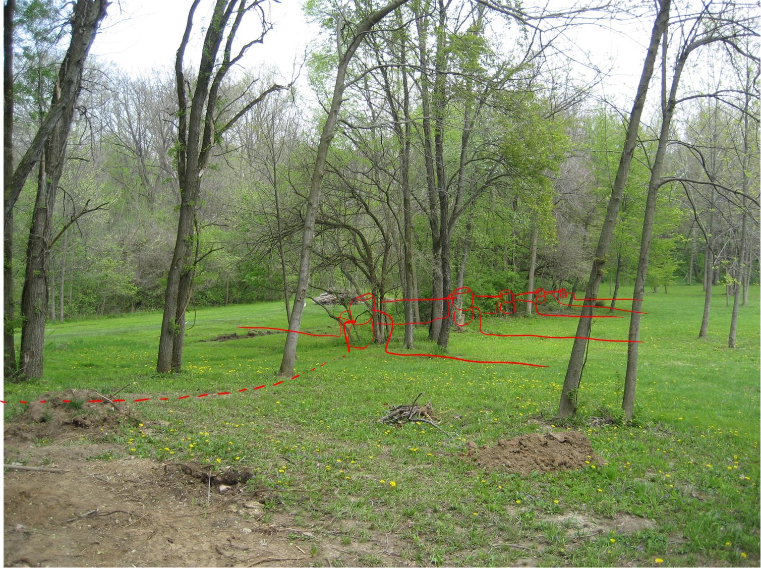

I'm looking to add a no cost operation drip irrigation system to my back two acres for a start up of small tree farm/plant garden and food plot, hobby for the most part. I have a natural spring that currently feeds into a very small pond at about a 25' higher elevation than this field. The field runs about 300'-400' beyond the pond and is about 150x200 wide. The lower field drops elevation farther you go back. I know there are more efficient ways that will allow for a higher pressured system but I think this would be pretty cool and add character. I'll be utilizing .5 psi drip emitters so this is a very low pressure system. I have attached a ruff illustration of what I have in mind. I'm looking to put in approximately 6 water stands consisting of one wood barrel stacked on top of another, the bottom one will most likely be filled with sand. The barrel heights will be approximately 4' to 5' above finish grade as these also will sit on a high point in the center of the field. I will add more stands as necessary. My question is, will this concept work? I would hate to spend my summer and dollars to setting this up and not have it work. Let me know what you think.

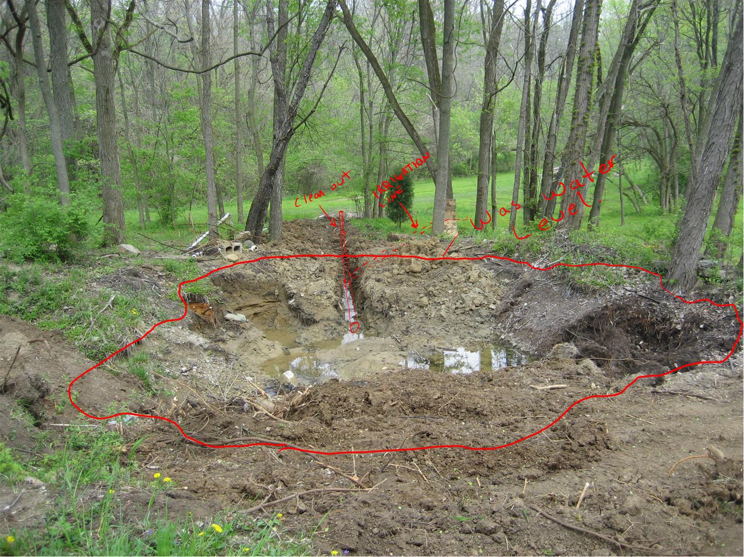

   / Spring Feed Irrigation Project
Nope, pipe didn't exist, I'm putting one in. This is my first step. Started my process yesterday and dug out the back of the pond and dug my drain line trench. That was fun, watching all that water come gushing out was really cool. I'm going to first start out with putting in the main clean out. This will keep the pond empty while I do some cleanup work. I just purchase a bunch of stone for a large retaining wall around the pond for esthetics and creating water bog planting areas. This clean out will be connected with a shut off valve and on normal operation it will come from a skimmer and route via stream or to the barrels via another valve. I think I will utilize a solenoid valve for this one. I'll continue to post as I move along.

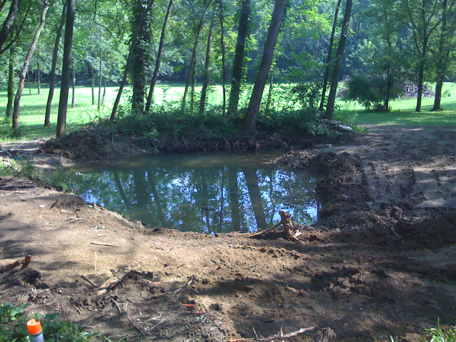

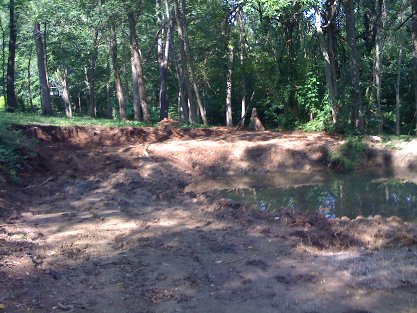

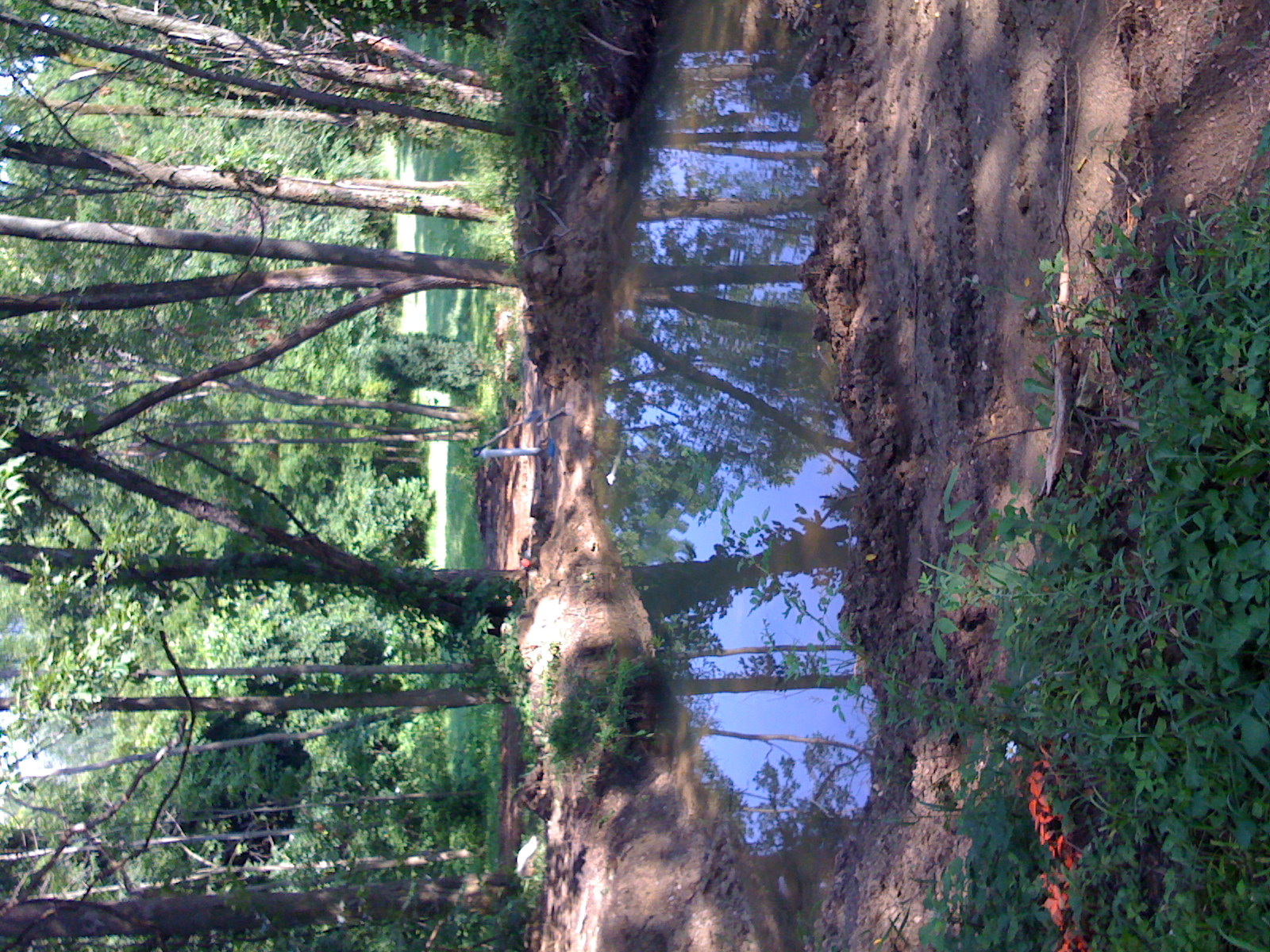

Here is my progress at the moment for my pond/irrigation project. At this time I'm doing a fill durration test and spring discharge elevation test. It appears that there are no leaks and the water discharge on the skimmer has remained constant. I still have a bit to go on the excavation and construction of the dam and then I start bringing in the rocks. It amazes me how fast this pond fills. More to follow.
