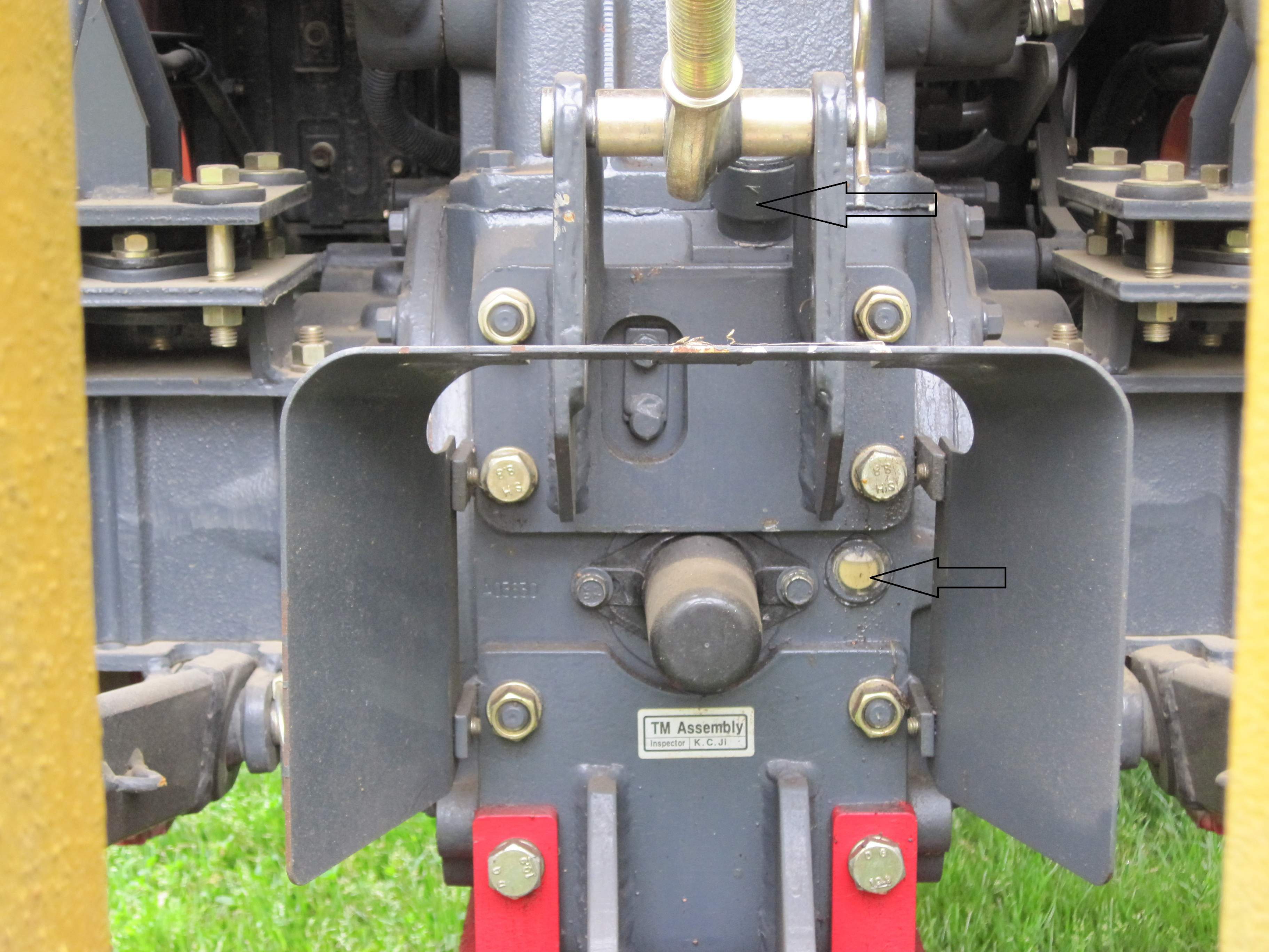

Grut Thanks - sadly, neither of us see anything that looks like a site glass anywhere back there! WE've looked in the manual and it is not where it is pictured.
CAn anyone post a picture of what you are looking at?

Remember I have the gear model not sure if they are going to be that much different, but mine is on pg. 63 of operators manual.
Here is a pic top arrow is fill tube and cap bottom is site glass.
Hope this helps.

Thanks! A specific area to look in and your great picture resulted in finding it! It was occluded by dirt! Seems we did not lose much in the drip. Weather in Reno goes from 104 in summer to minus 10 in winter. The manual suggests several fluids - what would you recommend?
