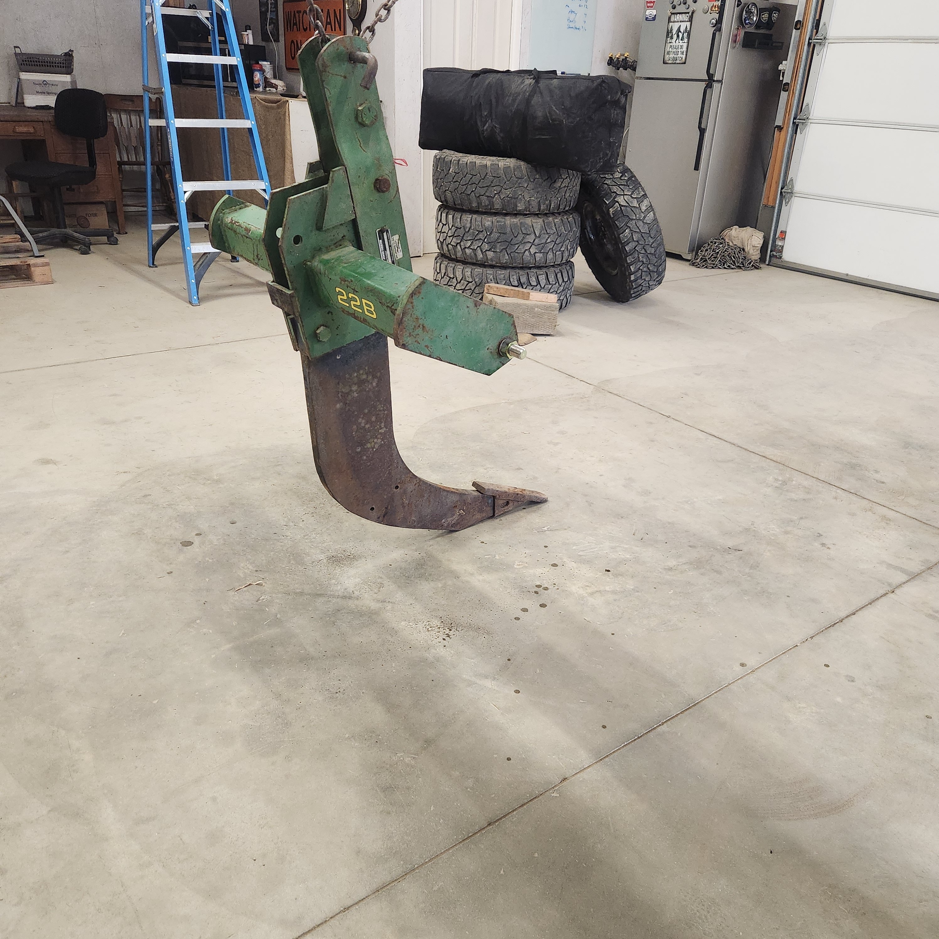

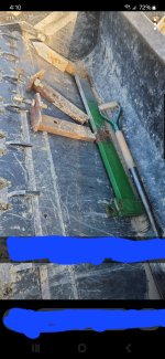

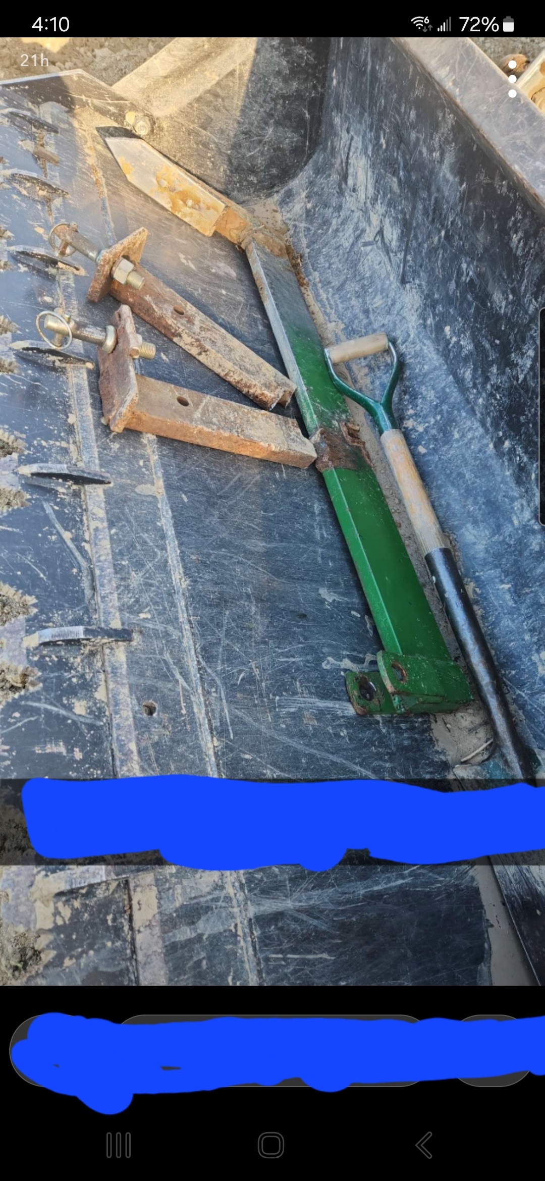

Next, i was sub-soiling with the LS to break up a field small field that had not been worked in 5 or 6 years. Right at the half way point of being finished a 'feel' it threw the tractor, resounding heavy 'clunck' sounded. I instantly stop and see the one inch thick hitch beam lof the sub-soiler completely broke in two from the sub-soiler.
Out of all of this malarkey, the LS just was plain reliable threw it all. Did not get a pic of the busted danish tine, was not in the mood... blue line in sub-soiler pic is blotting out 'desciptive' words

Well, fixed the sub-soiler....
