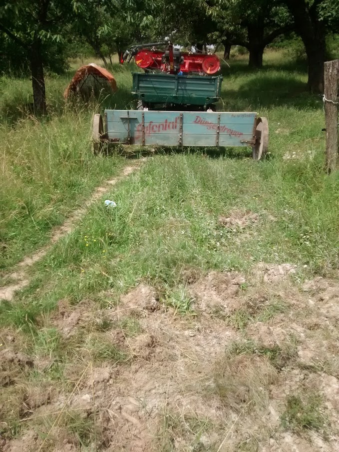

The spreader works great for the powdered lime. It is OK for granulated stuff as well.
/ Spreading powdered lime? #11
It looks like a classic spreader. I would enjoy more pictures of it if you have them.

Here is a gallery of some more.
Drop spreader - Google Photos
The red machine is the Czech Vari two wheel tractor. Because converting the green Goldoni to be a rotary plow from being a powered trailer takes so long, and I had to use it to plant the potatoes, I struggled around the field pulling the spreader with the Vari, just standing on the board on the spreader. Otherwise, I hitch it to the back of the Goldoni trailer-- I added a tow-ball there. The tow ball is also great with hauling hay-- I can attach my cars trailer and haul twice so much.
