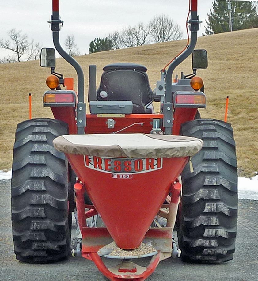

I replaced the 540 rpm driveshaft with a hydraulic motor on my 3pt ag spreader. That way, I can vary the amount of material and spread path by adjusting the motor speed. I also removed 2 of the 4 rotary spreader blades to further reduce the material spread rate.
By varying the tractor speed and the spreader rpm, I can sand / salt a 3' sidewalk or a 16' wide road.

Forgive my ignorance, but, how do you vary the hydraulic motor speed? Are you varying your engine speed?
Am I right to think that hydraulic remotes and accessory hydraulic motors do not have any way to adjust speed unless you change the speed of the tractor engine?
   / Spreading just a tiny amount of road salt? #75
Yes, the hyd. motor speed is controlled by varying the engine RPM. With a HST transmission, the tractor ground speed can be controlled independently of engine RPM. This makes it easy to adjust the material flow rate and ground coverage area.
The hyd. motor speed can also be varied by "feathering" the valve control lever for the remote if necessary. This isn't possible for solenoid operated valves, such as a third function valve, which is either on or off.
