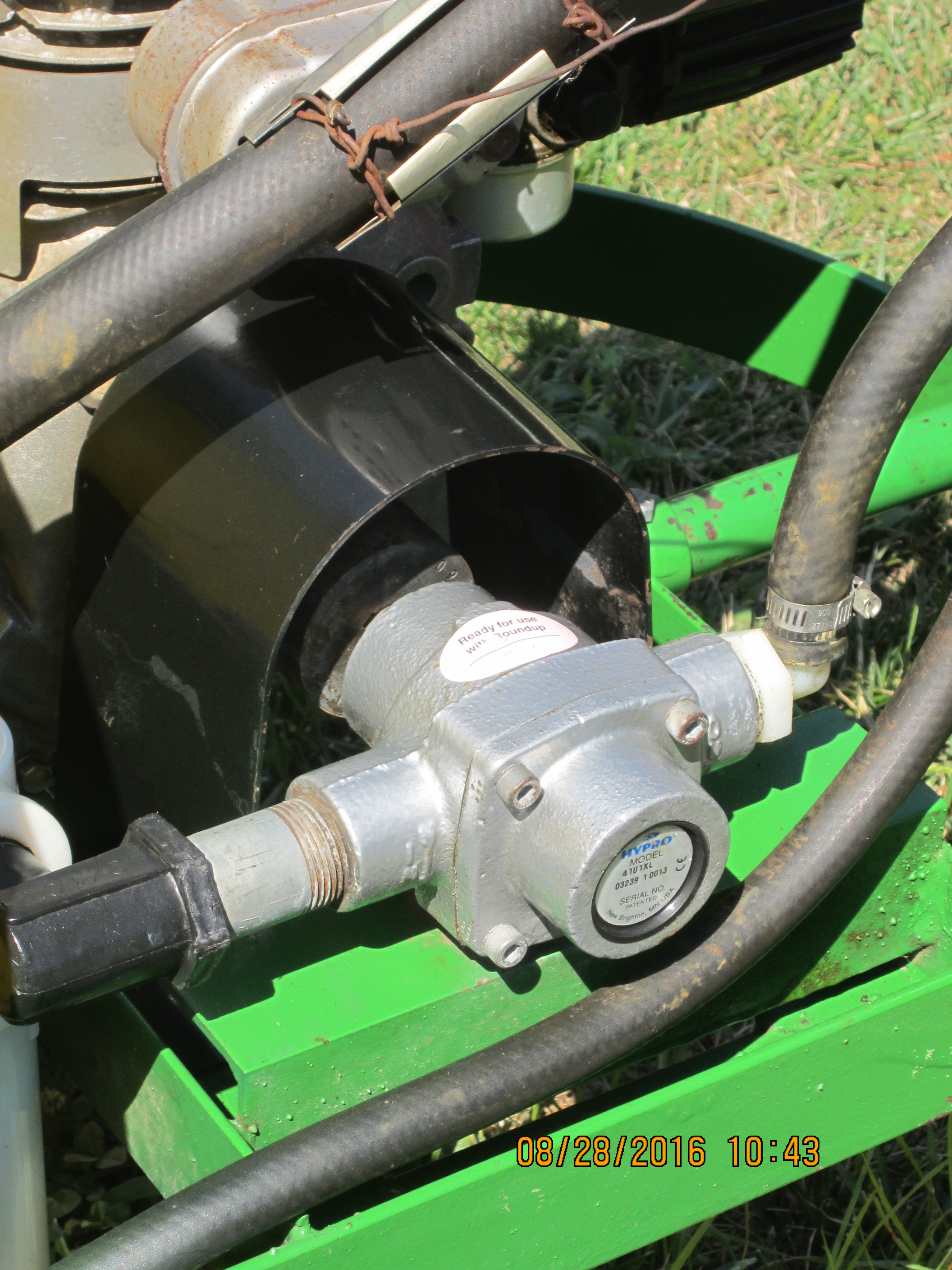

I would be using round-up occasionally. If I went with a roller pump, would I need a special roller pump, or are they all pretty well set up for round-up?
Hy-Pro has a pricey pump body called Silver-cast meant for Round-up; but I use plain Jane cast iron without problems. As others have said, put oil or antifreeze in the pump to protect it after use. I use antifreeze since it's water soluble. I also run antifreeze through all the hoses, nozzles and wand after each use.

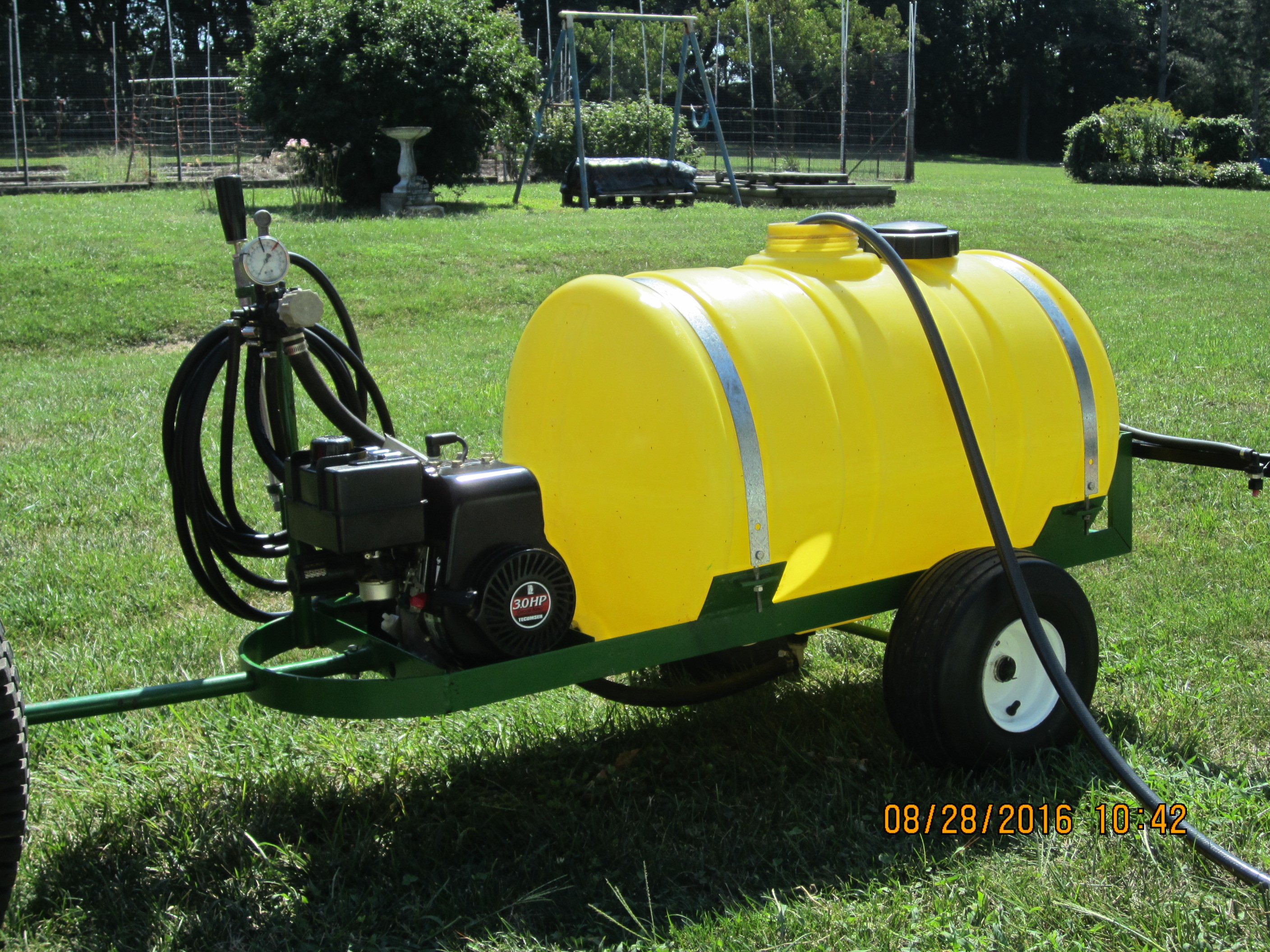

I've had both a 50 gallon spray rig with a 12 volt Shurflo pump (actually belonged to my brother) and a 25 gallon rig with a Hypro roller pump, but powered by a Briggs & Stratton engine instead of the tractor PTO. I agree with what the others have said, and in addition, another big difference that may or may not be important to you is the maximum pressure they pumps are capable of. The 12 volt was a maximum of 50 psi, and while I normally ran my roller pump at 100 psi, it was actually capable of more than twice that pressure.

I clean my system out with a neutralizing chemical (e.g. All Clear, Neutrasol) and water before I leave about 1 - 5 gallons of water/antifreeze mix in the tank and system. I pour pure antifreeze in the pump. My sprayer and pump live outdoors as I have no indoor space for them.
It seems that I spend more time cleaning the system than I do spraying. My next sprayer modification is to add a quick dump outlet to drain the tank quickly. Currently it drains through the strainer, and that takes a while.

I have a 25gal 12v tow behind and a 15 gal 12v spot sprayer. The 12v pumps need regulation through the bypass valve to keep them from cycling when running them constantly.
