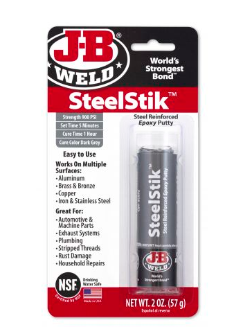

I'm in process of repainting the outside of a 1909 cast iron bathtub for the misses. It's is pretty much stripped and it is not necessarily a smooth surface. Some pits in the casting , seams etc. I find that I can blend the seams a blemishes with flap disc pretty well, but would like to smooth out a few of the pits. Would I use something like spot putty to fill them or is there something better? Fill and then prime? Any thoughts would be appreciated.
/ Spot putty? #2
I've had success with JB Weld putty epoxy. It's malleable, sandable.

If you are going with porcelain I don’t know that process. But if you are doing “normal” paint you would treat it like a car and use body filler like Bondo and then block sand it.

I initially ordered the JB putty from the big a figuring that I'd always have a use for it after filling the pits. I still may need to smooth parts out. But, then again- it adds character... My auto body skills are- horrendous. We'll see what is really visible. Why a woman in her 60's needs a clawfoot tub,.,

To the OP--Go to an autobody supply shop and get Evercoat Polyester Gazing Putty. It's super smooth, sands easily and doesn't shrink. It's a 2 part system. I've used it on car restorations for decades.

I also used it in the body shop all the time. It's a good product, although it's not a cheap option.
If you don't need a lot, and you are not real great at applying filler smoothly, Evercoat Metal Glaze sands like primer, and is the best option.
If you need to do large areas, a decent body filler is going to be much less costly. Evercoat makes Z-Grip, which is pretty good, and not crazy expensive. It's almost as creamy as the metal glaze, and you get a gallon for about the same price.
We would also often mix both products together for the last coat of mud, to make it easier to smooth it out, but still cost effective.

A closer look and a bottle of the Evercoat glaze is on order. Can't wait.
