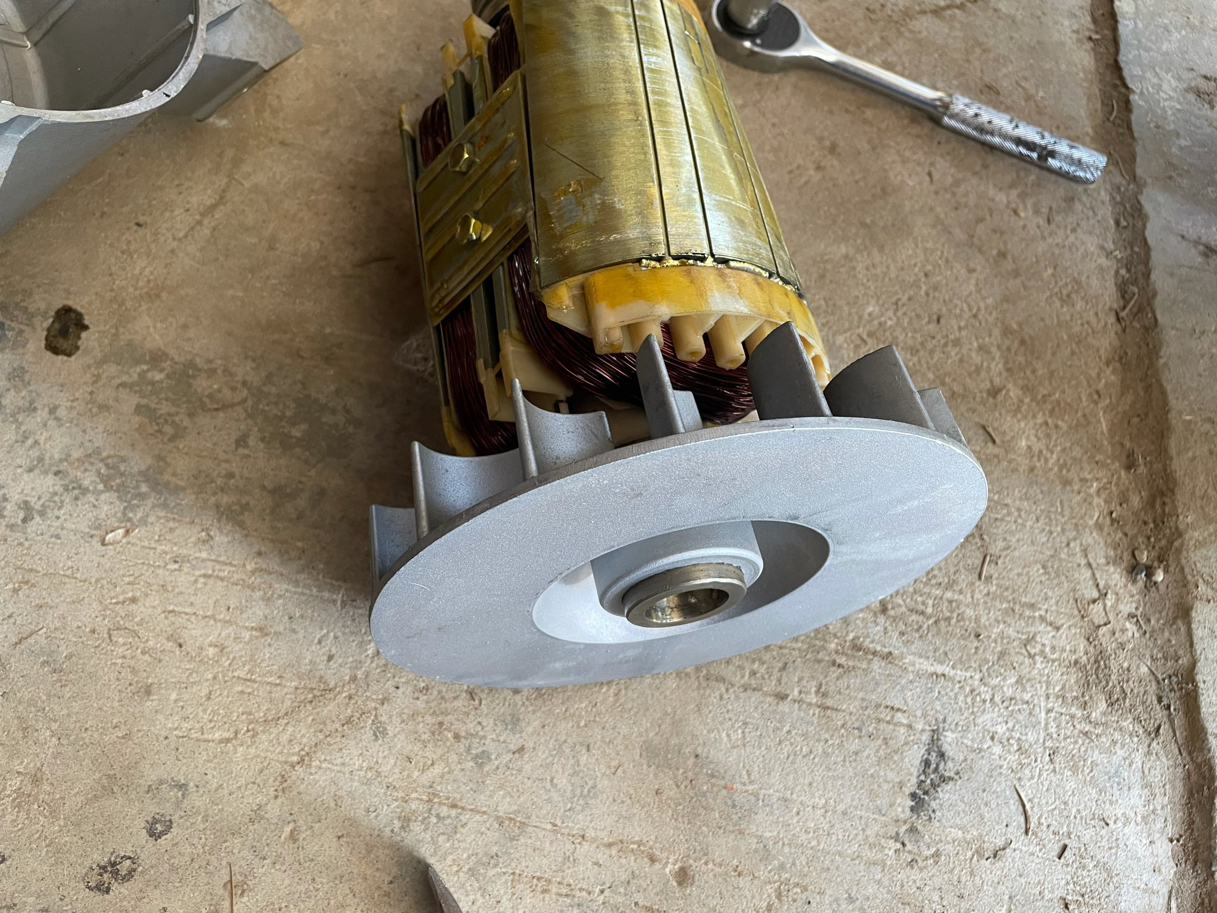

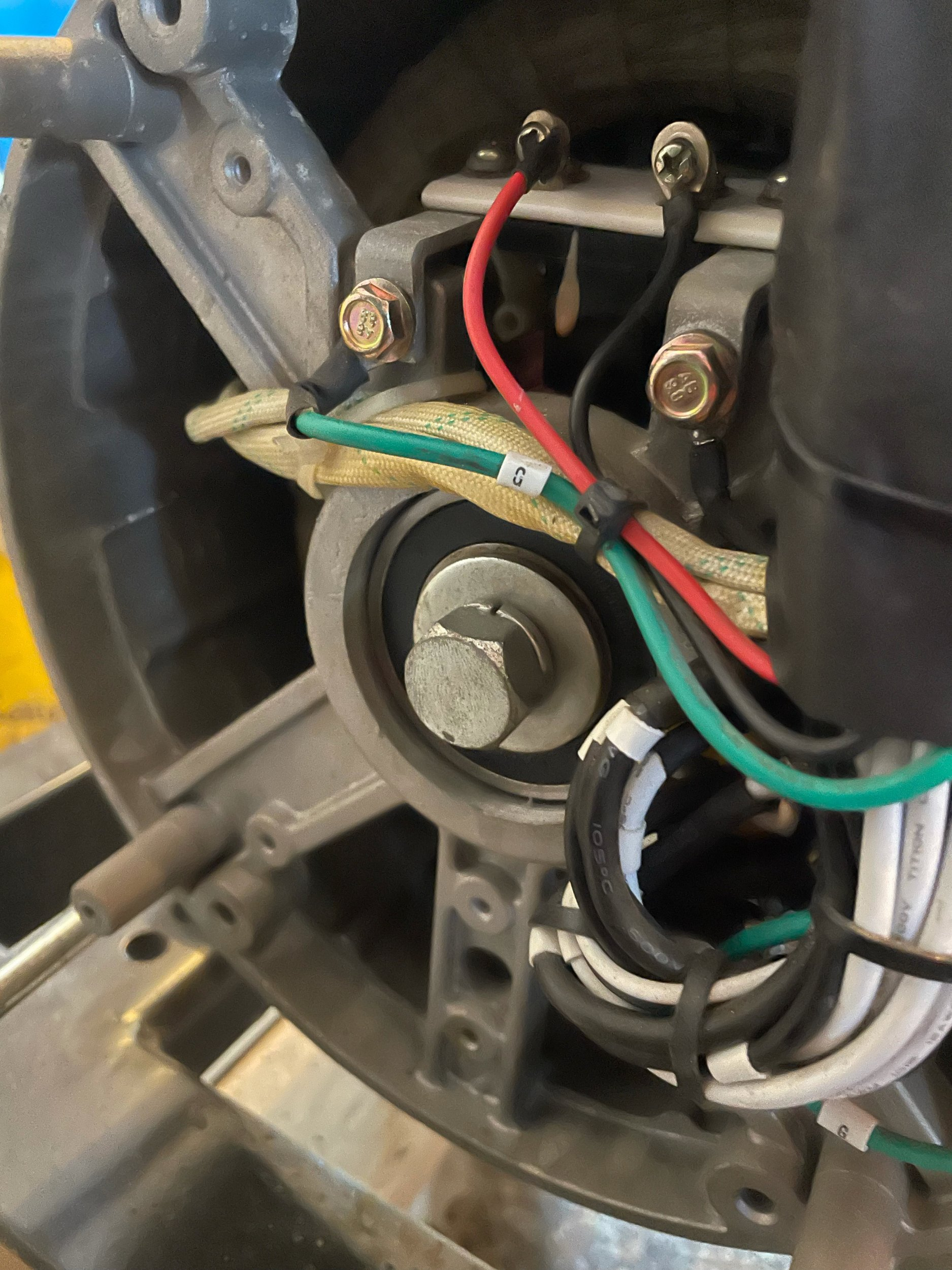

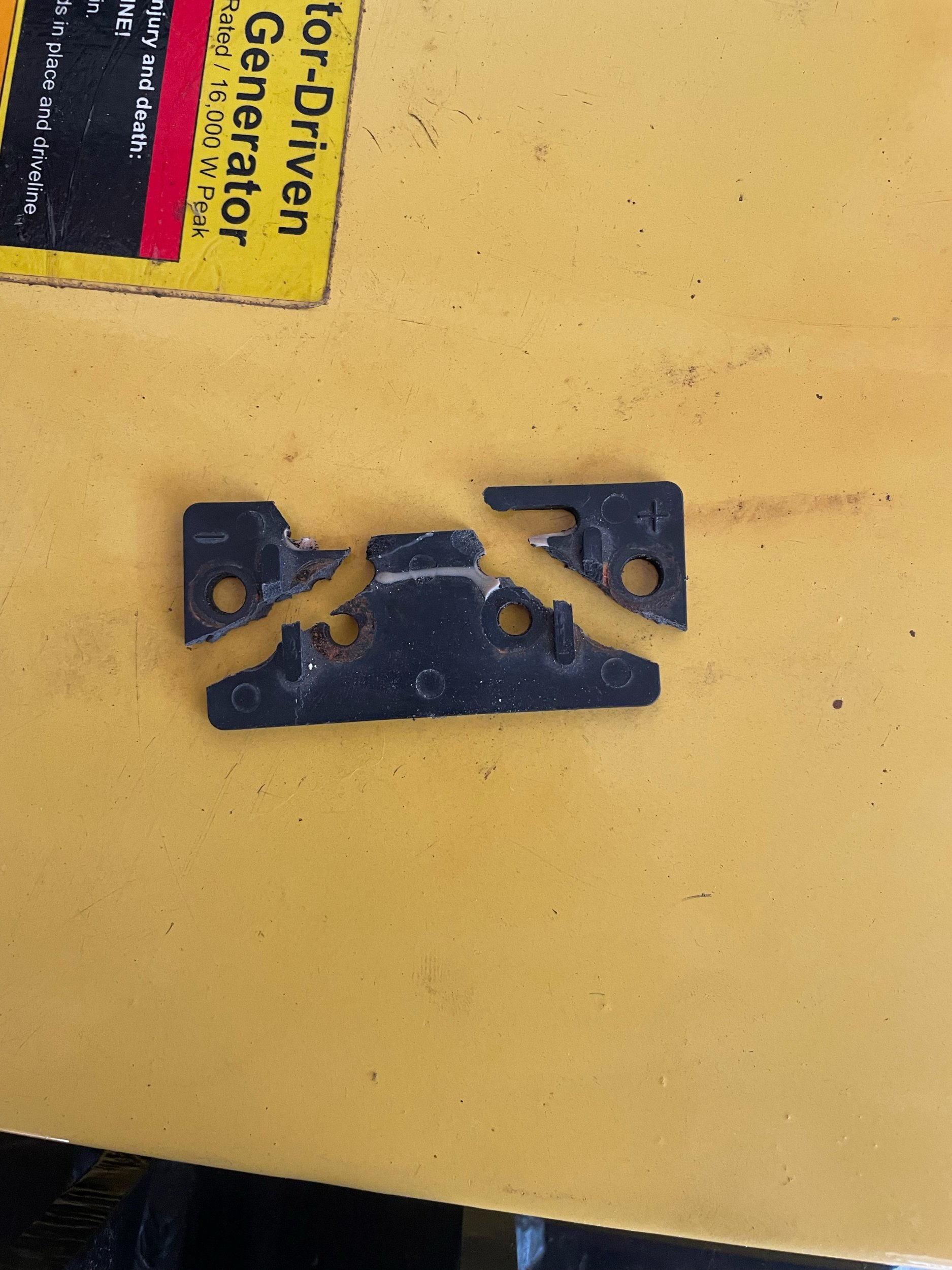

I would recommend removing the 2 bolts (image 2) that hold the brushes in part and moving them out of the way, I didn’t do this and broke the plastic mount piece and had to fabricate a new piece because my rotor and bearings pulled out with the pto gear box, (image 0).
There is a large bolt running through the rotor shaft remove it (image 2). This is what holds the rotor to the pto gear box. It’s just a taper fit on the end of the shaft (image 4). Hint: You could damage your brushes if you don’t and also pull out the whole rotor J.

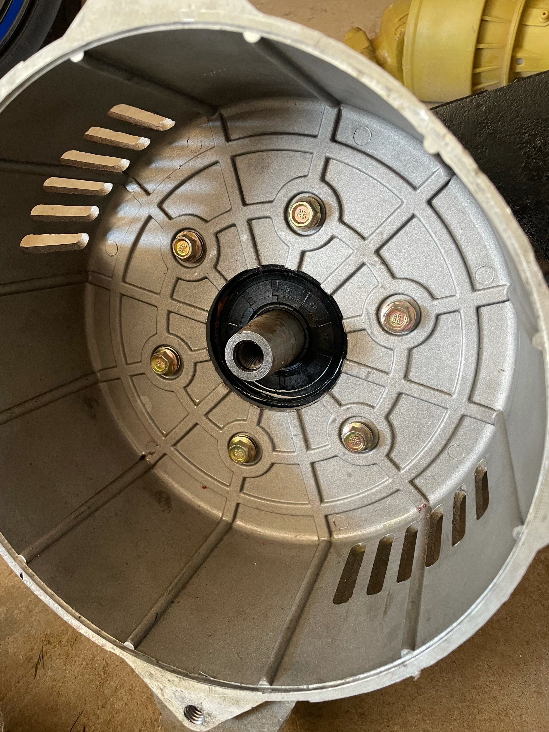

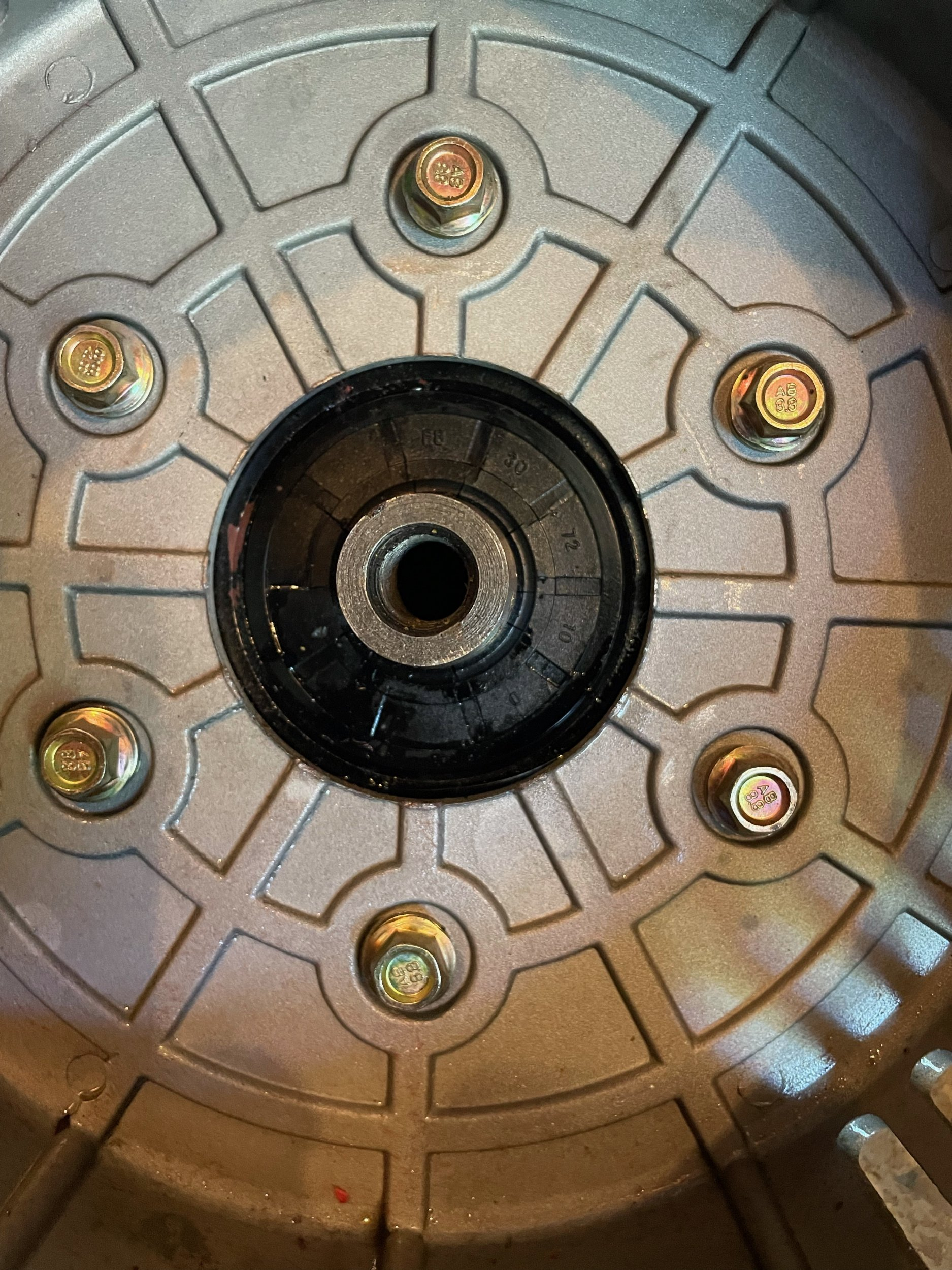

Carefully remove the front generator end with the pto gear box. The generator end is soft cast aluminum and dents very easily if you use a persuader “ aka: hammer “. Once off you know have access to the inner oil seal (image3). Mine was very badly dry rotted and cracked (image 1).

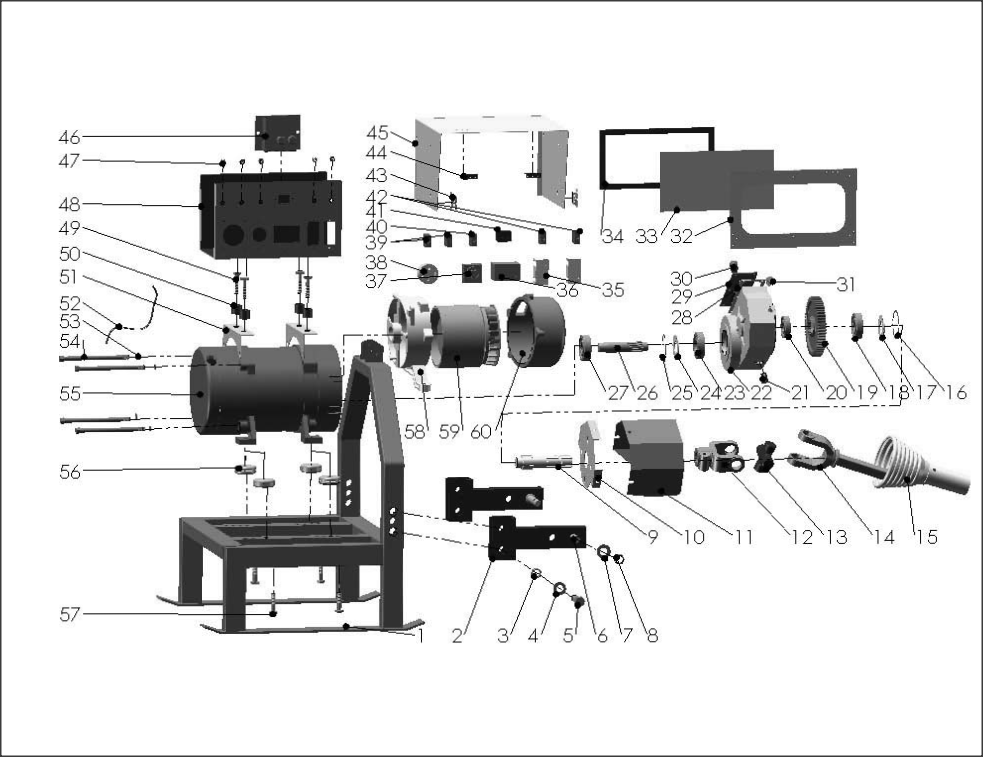

Enclosed is their current $1999.99 model 15 kW PTO generator assembly drawing - is this the same as you have?
Looks like a generic 35x72x8 seal should fit.

It looks the same. Your parts break down is a little bit different then mine but,,, My manual also claims to be a 35x72x8 seal but my inner seal was a 30x72x10. I believe the manual has the to p/n's reversed for the seals. It also doesn't show the bolt that goes through the rotor shaft and mine doesn't show the bushes or hardware that they attach to.
I do have the HF model. On mine the one thing in noticed it that the 240/120 switch controls the display and the plugs. On 240 it reads 240 volts/60 cycles and you can only uses the 50 amp plug. On 120 it read 120 volts/60 cycles the 2 20 amp outlets work. I can't operate 240 and 120 volt at the same time on my unit, it might be some kind of safety so you don't overload it. I never used any of the other outlets.
HF does have some parts but my first order was for the inner and outer seals, I got the 35x72x8 seal and a bearing. My second order was for the 30x72x10 seal and got a another bearing. My third order still on back order but the seals were easily found on ebay. I'm sure a good bearing shop could get them. HF was addressing the issue with their stock and sending out the wrong parts. As for the extra parts I'm just going to keep them, I might need them I might not.
