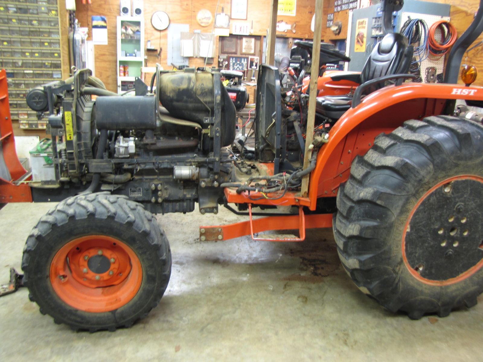

#3 Steering and wiring off.

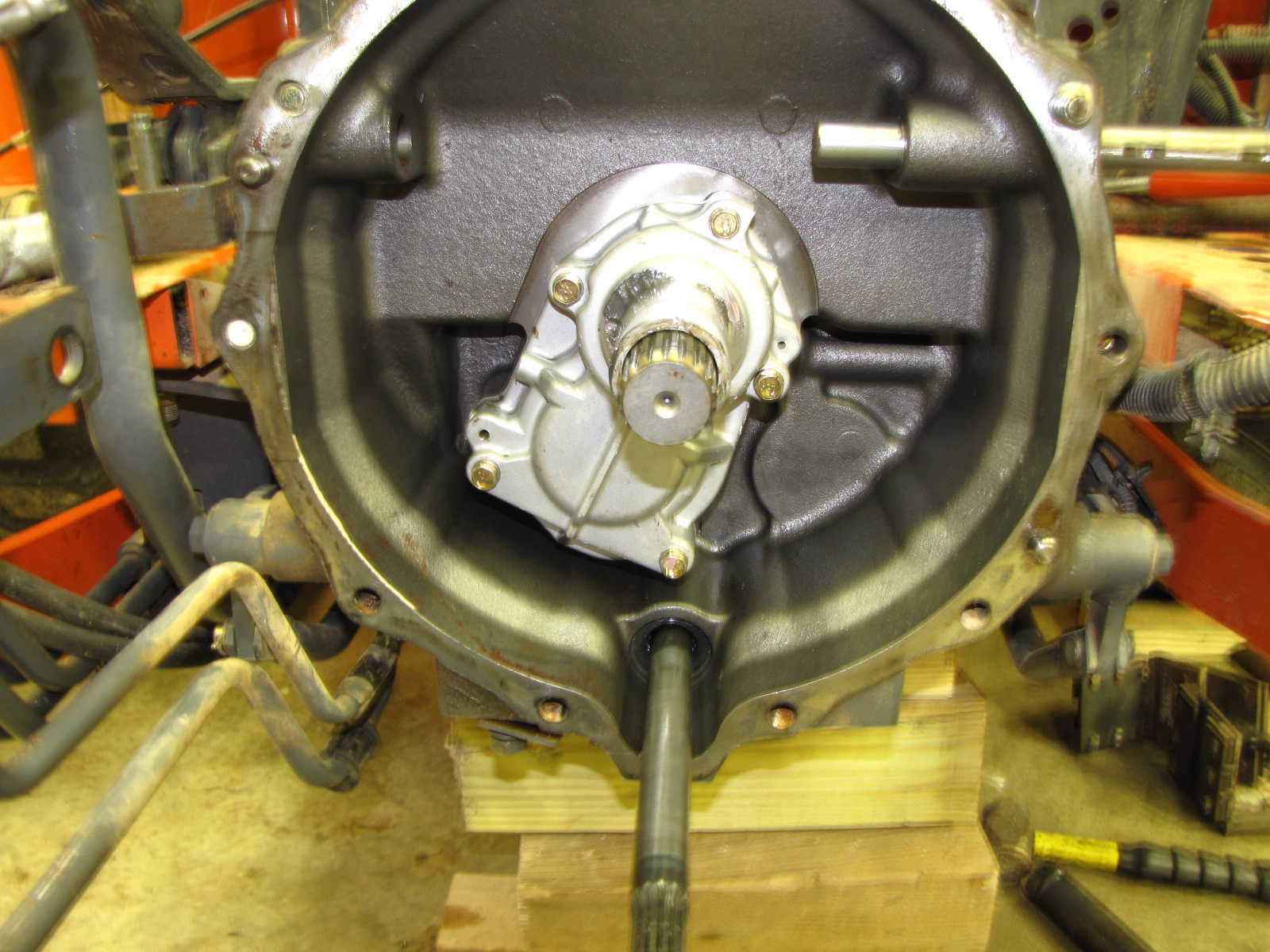

#1& 2 That was where I wanted to be. Look at #2 at the 4WD shaft, the longer silver part is just a spacer, but right behind it you can see another part. That part is a sleeve and the 4wd seal runs on that.Be very careful with it. There is rubber on the inside of it. Removing it without messing up the surface is hard to do, I would say to order a new one along with the 4wd shaft seal and I would replace, because you can't be sure it wasn't leaking.
#3 You can see the spacer and sleeve is out now the 4wd seal can come out easy after you remove a snap ring.

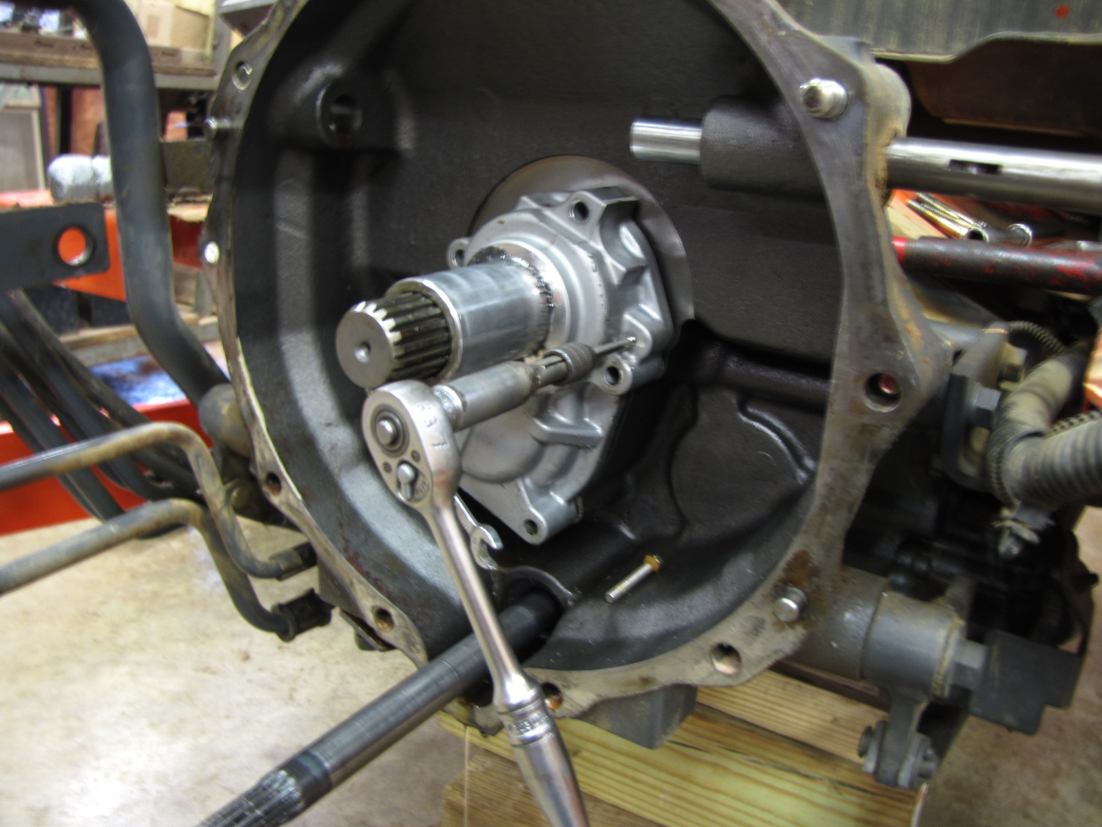

#4 To remove the housing you screw 2 bolts in to push the housing out. Note a wrech on one side and a rachet on the out.See next picture.
#5 That is housing #2 that was put on by the dealer @ the 550 hr time. It did not have threads in the hole so I had to use a tap as a bolt to push the housing off. Now the pisser is the SS housing was not threaded eather, so I tapped the new to make it easer for the next guy.

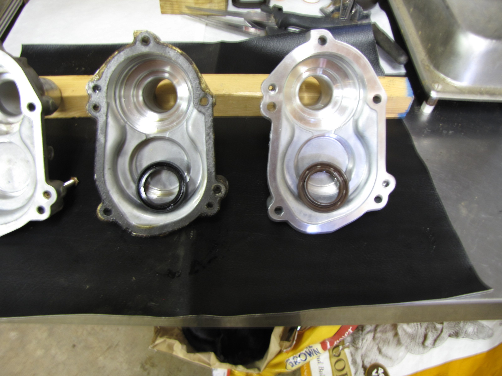

#6 Here is all 3 housings 1st one on left is the 1st to be replaced by me after but new seal in and warpped it. The middle one is the one I just pulled and the new one going on. I could not find any differents in the housing and couldn't find any reason why it would be SS. I must say I could not get to ID mic to check the bore where the new seal goes. I did kind of fitted it to the old housing and I think it would of fit.
#7 & 8 You can see in #7 the hole I was taking about, like how small it is. The last picture is just the old and new seals and that new seal fit like a seal should fit. TIGHT.... I think that fixed it this time. Everything all back together and running good. BTY one more thing for the ones asking about valve adjustment. I found 4 valves that were over the .008 max. I would guess they were aroud .010 to .012.
