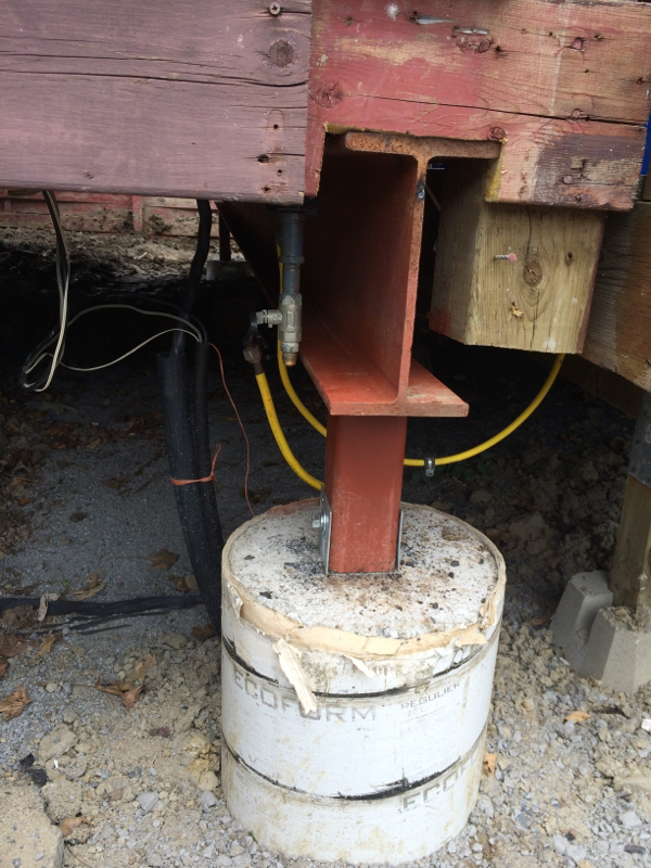

I spliced one together with a 30' span in my shop for the same thing. I also welded plates in the flat although I doubt it needed it.

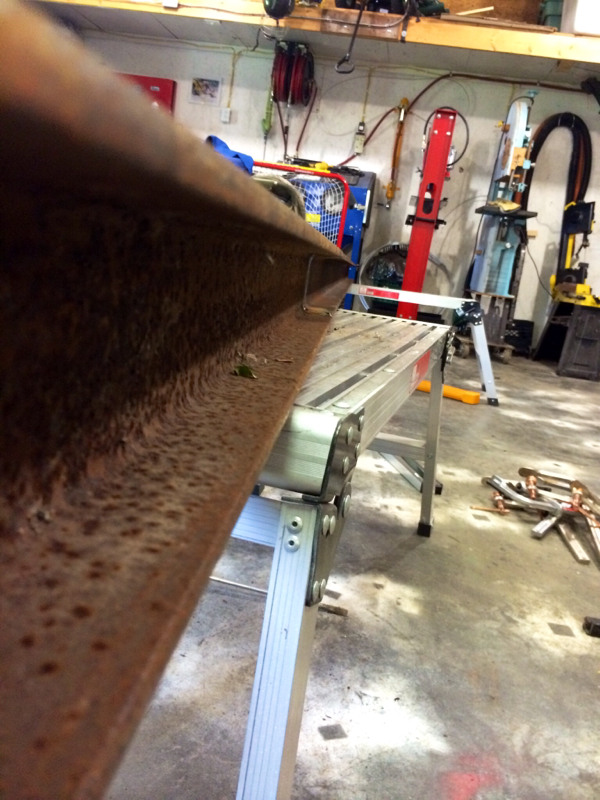

So a bit of a snag; may need to scrap project or get a matching piece. (I'm doing this for my fathers shop)
As you can see from the pics one piece is just a little taller than the other; same thicknesses.

You could weld a spacer on the shorter side without sacrificing much in the way of strength as long as the splice place on the top is nearly the same width as the top flange.

3) level out the trolley track and keep moving. That little offset in the flanges will weld up nicely with filler plates

Since you posted pic's, I'll comment. For 500 lbs. it will hold. Forget excuses, that's a water blister, a minor inconvenience as far as welding goes. As far as quality it has has some rather obvious flaws. Did your experienced welding friend inspect it and what did he say?
Why didn't you do a better job cleaning it up before welding? You burned hot but maybe too hot. It looks like you may have been going a little too slow for the heat and putting too much filler in one pass. Were you weaving or going in circles while welding? You left unfilled craters and undercut and worse is you left them on the edge of the beam. Great place for a crack to start.
I hate to be so critical but you've got good equipment and asked for advice before proceeding, did a good job lining/clamping everything up properly and in the the end it looks like you got in a hurry and scrimped on the most important details. Shouldn't fall apart??? That's just another way of saying good enough. Sorry, I don't understand.:confused:

I concur with this post. Bevel the .125 gap on the 1st pass to the backer plate, then fill the groove. Make the bevel 45 deg. on one side. Blade Breaker says it correct. I have done this type of welding many times before on other pieces of similar construction.

It will certainly hold 500 pounds, and considering all of the rust on the beam, the weld looks as good as you might expect.
If it were me, I would have spent 5-10 minutes with an angle grinder and ground off the rust within 1 inch of the weld area. That would have turned what was an acceptable outcome into something that high quality. Just a suggestion.
