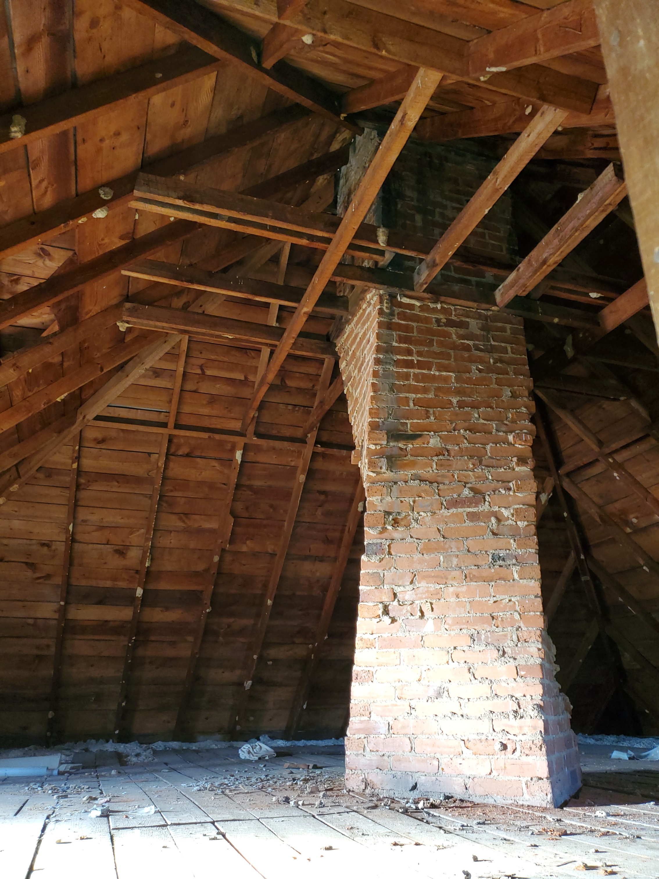

This is the attic I am thinking of using the spiral staircase. It is about 900 sq ft with a 11 ft ceiling. It would make a great bonus room or bedroom. I would have to add a dormer with a window large enough to get furniture in. Note: This is all wifey's idea right now... :confused3:

That's a really nice looking attic space. That spiral chimney is interesting!
A few years ago we went to Salem, Mass. and I remember one house we toured, maybe house of Seven Gables had a hidden door beside fireplace then a spiral staircase that was up against a chimney like that. I always liked houses with secret passages, rooms, etc.

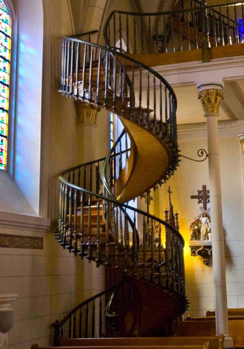

HERE'S a spiral staircase in Santa Fe, NM we visited. The story they told was a carpenter showed up one day (1800s), made the floating stairs and left without asking for pay.
