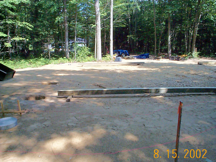

I guess I am far enough along on my pole barn to start a thread about it. I didn't want to start the thread back when I actually started the project because I knew it was going to take me a long time to finish it. I travel around the country for my work and when I am home I have a beautiful 2 year old daughter to take care of.
I started clearing the building site last fall (2001) when we moved to this location. I didn't have my TC33D then, I hadn't even hoped or dreamed of getting a tractor at that point. I was using my 16.5 h.p. Weedeater lawn tractor with a 17 cubic foot trailer behind it to haul away the trees and brush that I cut down with my chainsaw. Unfortunately I didn't think to take any pictures until this March. I had my TC33D then and took some photos of the stumps that I was removing. I have made previous posts on TBN that relate to this pole barn project. Instead of me reposting all of those photos in this thread I will make links to some of those previous posts.
I don't have time to post all of the pictures right now so I will start with a few and add to that later.
This first picture is the earliest shot I have of the building site.

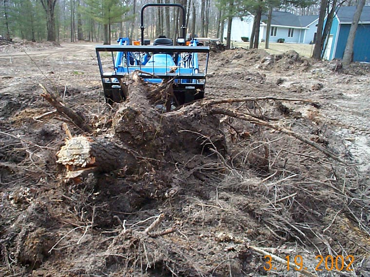

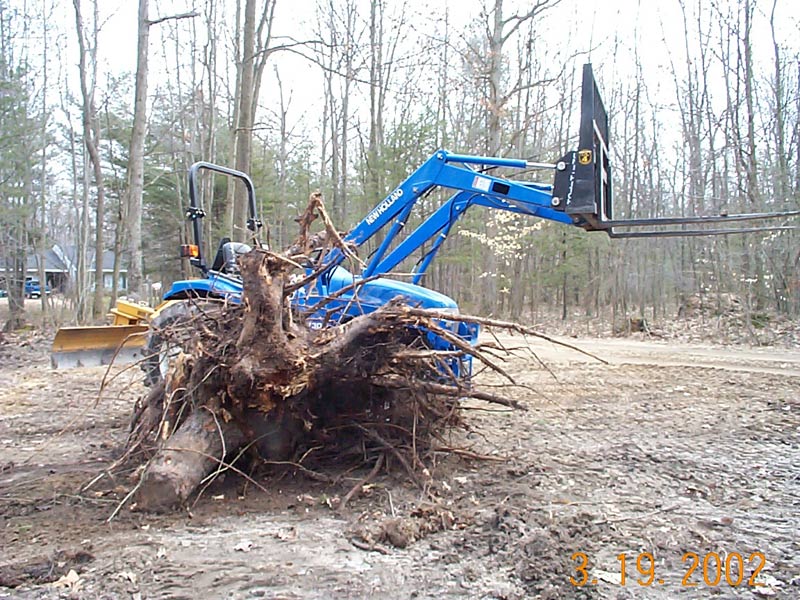

Here is a picture of one of the stumps that I got out with my tractor. That is my house in the backgound. I had two previous threads on stump removal.
<A target="_blank" HREF=http://www.tractorbynet.com/cgi-bin/compact/showflat.pl?Cat=&Board=projects&Number=119779&page=&view=&sb=&o=&vc=1>NH TC33D vs. Stump </A>
and
<A target="_blank" HREF=http://www.tractorbynet.com/cgi-bin/compact/showflat.pl?Cat=&Board=projects&Number=120670&page=&view=&sb=&o=&vc=1>Unbelievable? </A>

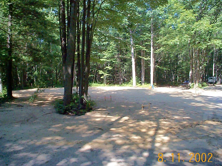

Here is a picture of the site right before I started digging holes. I removed all the stumps and dug and scraped away more topsoil than I care to remember. I had 260 yards of fill sand brought in for me to level out the area and bring it higher than the surrounding woods.

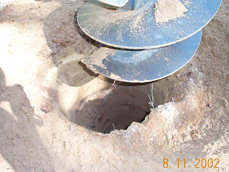

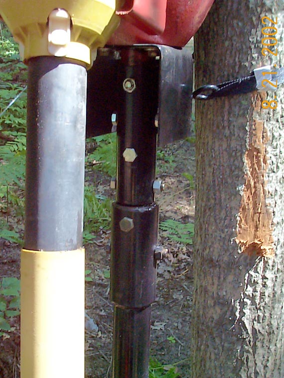

Re: Spencer\'s Pole Barn Project
Here is a shot of the hole itself. I used a Bush Hog model 2102 Post Hole Digger. I had a 48" long by 18" wide double flight auger. I installed an 8" extension on the auger so I could dig a little deeper. I still had to dig out another 6" to 8" by hand to get to the depth I wanted.
   / Spencer's Pole Barn Project
Here is a shot of the 8" extension on the PHD. It cost like 60 bucks but it was worth it to me.

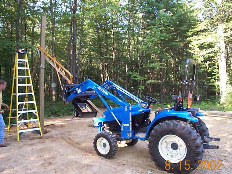

Luckily the inspector likes me so the job didn't get shut down. Here is a picture of the first pole being set.
