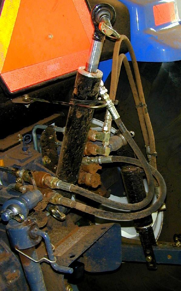

I have attached a picture of the hoses. The shorter one measures 18" and the long one measures 27". Those measurements are just the hoses themselves and do not include the fittings (except where the hose is crimped inside the fittings).

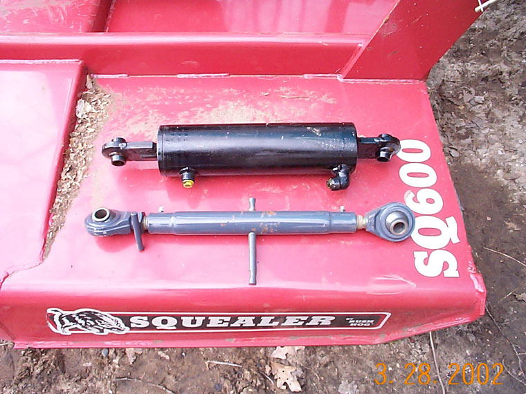

Another View
I am not saying that these lengths are ideal. They work fine for me but I am sure someone else has a better solution.
Brad Coleman, I would like to see a picture of your hydraulic toplink and hoses.

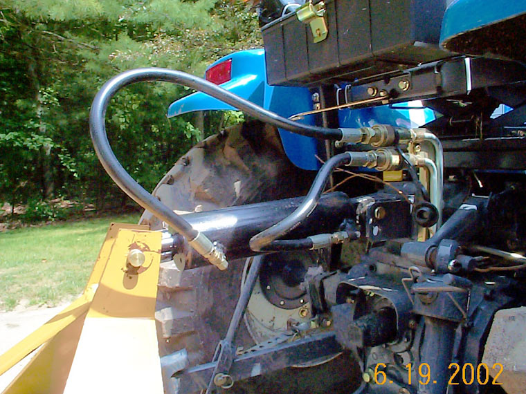

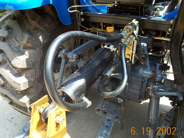

   / Spence, hydraulic top link questions #13
<font color=blue>Brad Coleman, I would like to see a picture of your hydraulic toplink and hoses. </font color=blue>
Here you go. Excuse the dirt. I've bush hogging and it is dry out.
--Brad

   / Spence, hydraulic top link questions #14
Boy that is dirty, I thought mine was bad. I see why you were able to make your toplink fit in that hook, it looks a little smaller in diameter than mine.
See attachment.
