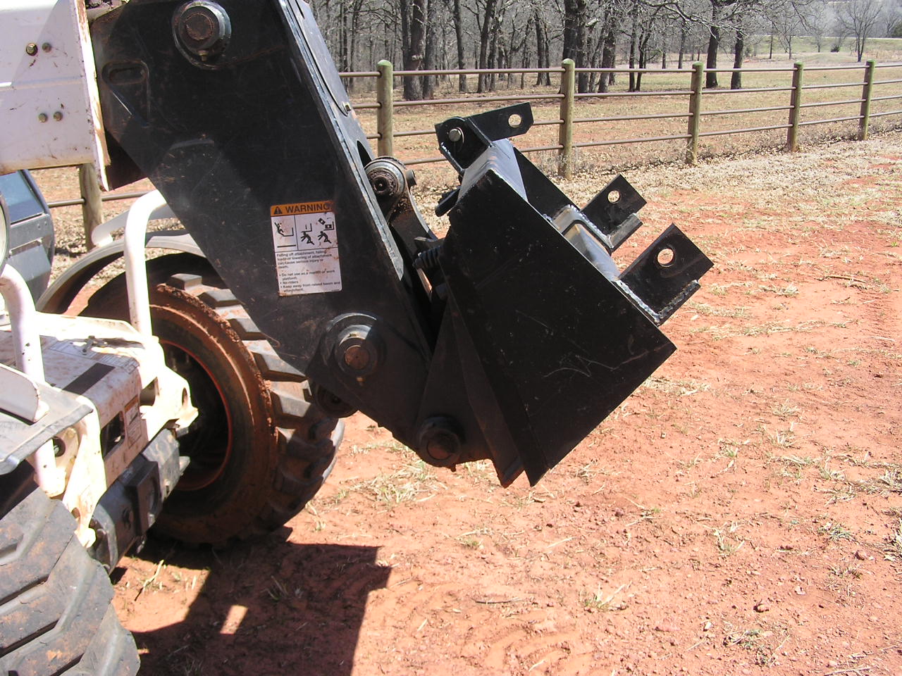

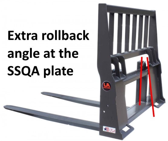

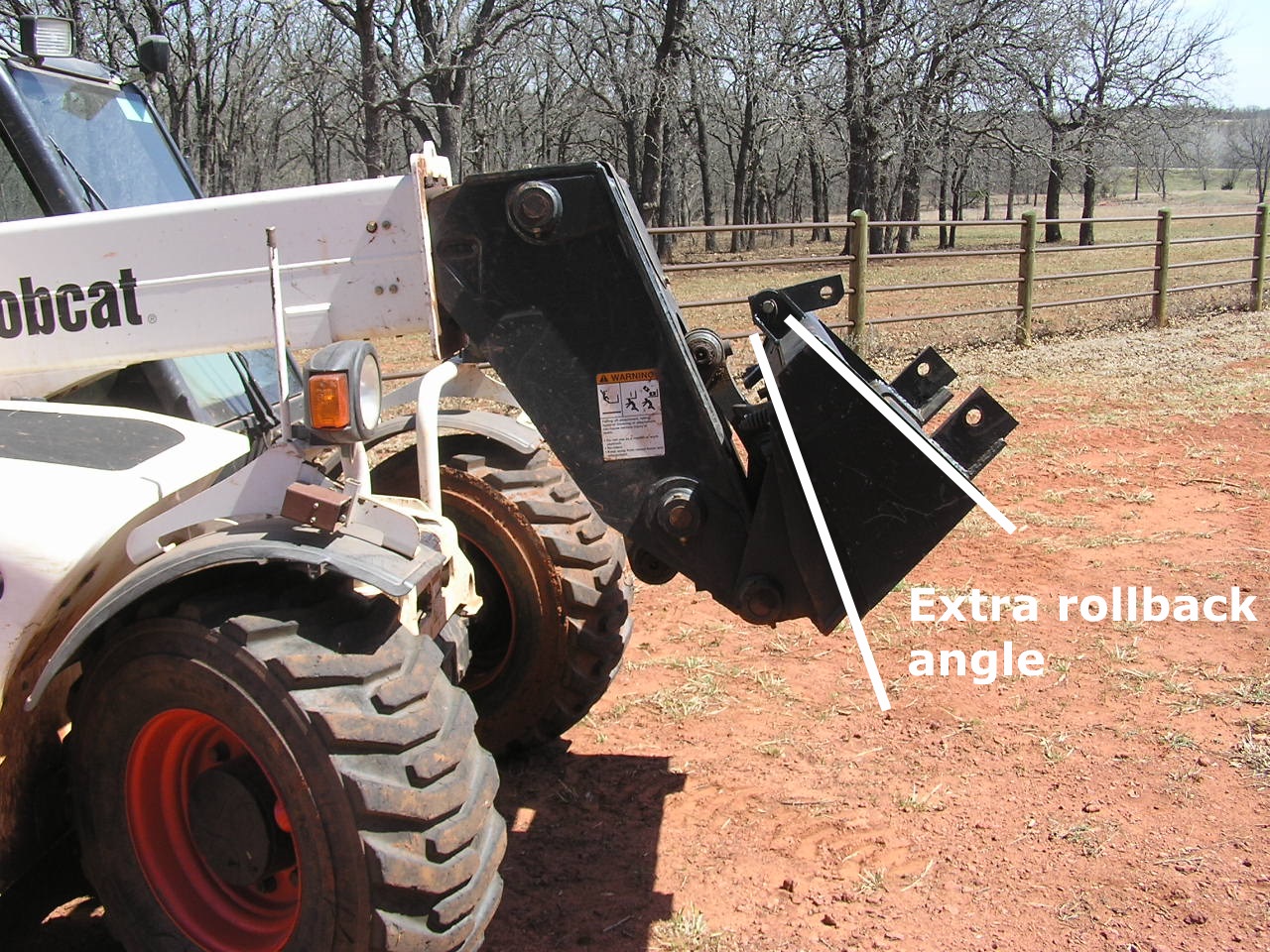

Jw585, do you wish you would have added more rollback?
Most of the builds on here have more angle, needed for some 3 point attachments.
My store bought 3 point adapter has a lot of extra angle built in:
This fork frame has extra:

Xfaxman,
I just built it from my head to use up parts/pieces etc. for the blade to push snow banks back. Well so far NW Pa. has not had a lot of snow
and I have not had a chance to try it to push snow banks. I did some small pushing of leaves/brush though.
I will have to see if I will use it with other implements to see if I need more roll back. (Perhaps the rake?)
Thanks for the Idea
