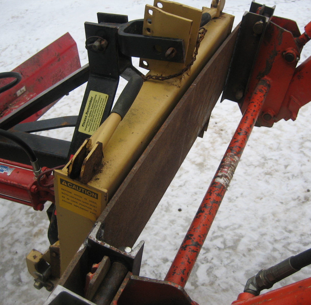

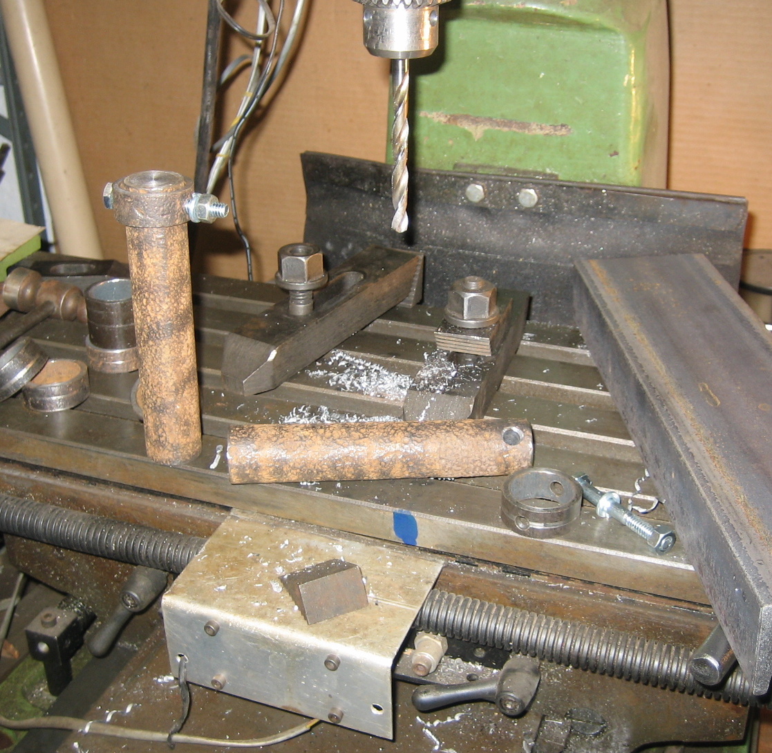

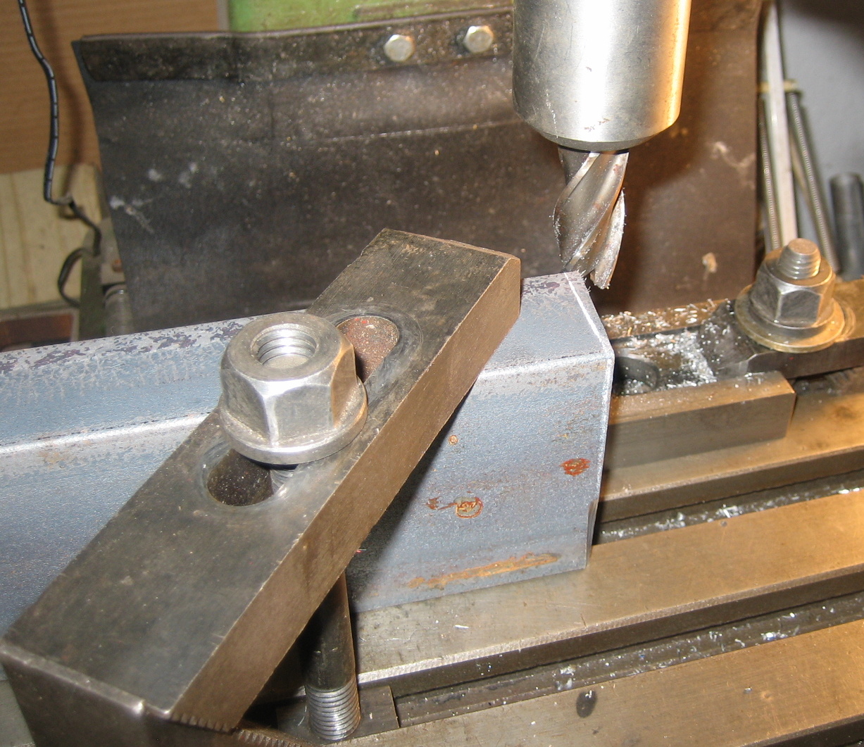

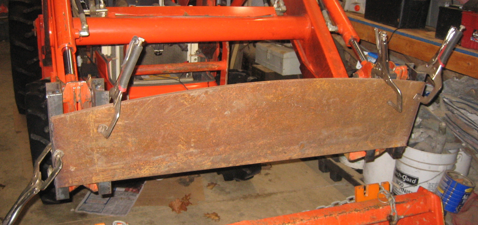

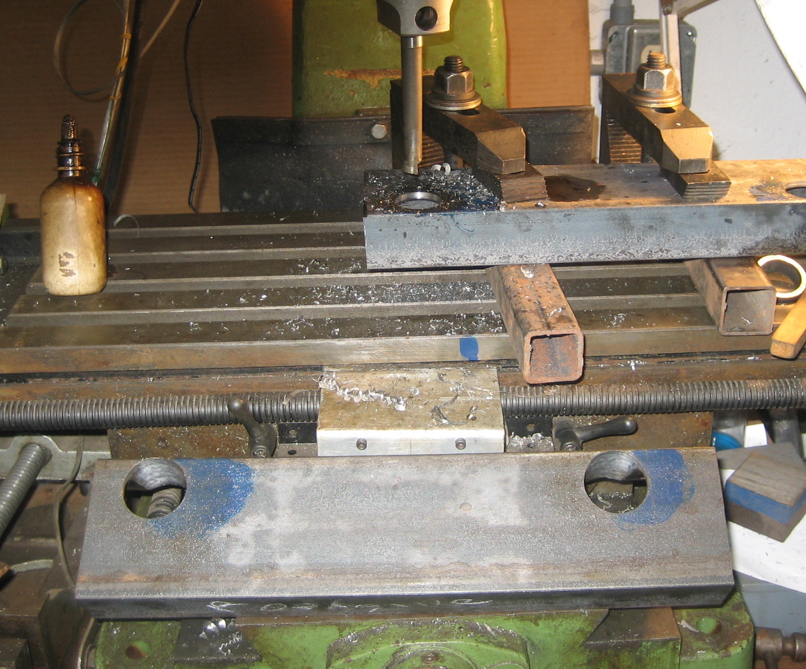

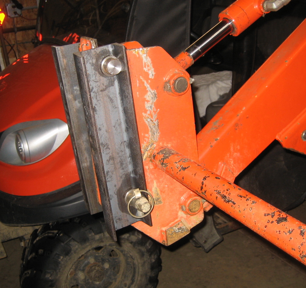

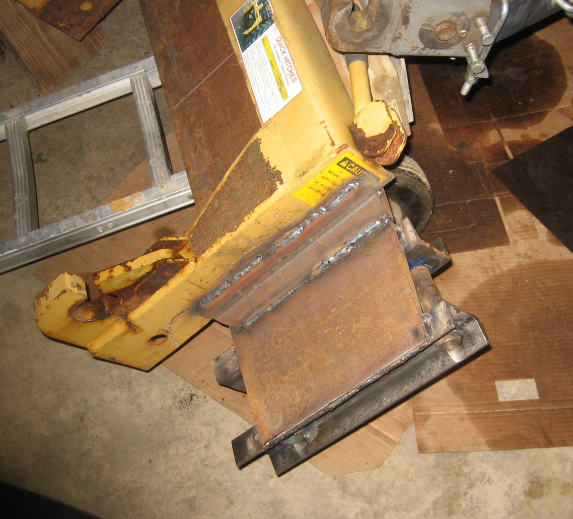

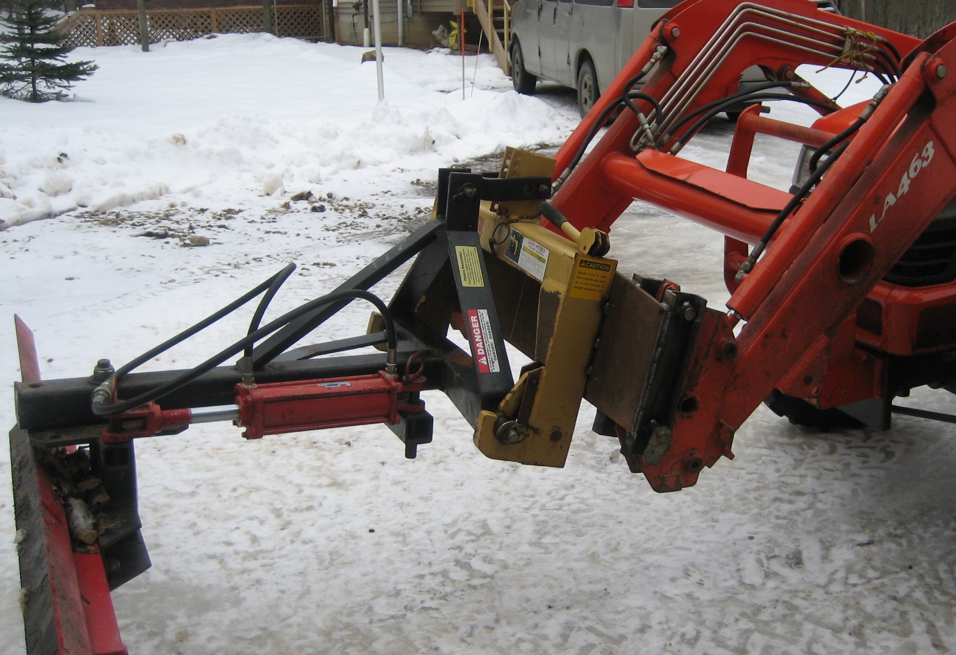

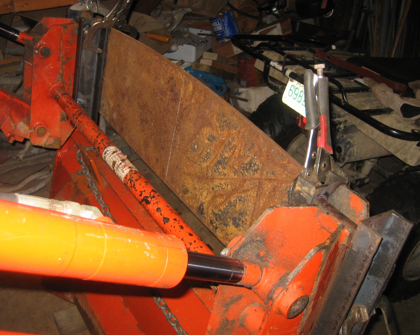

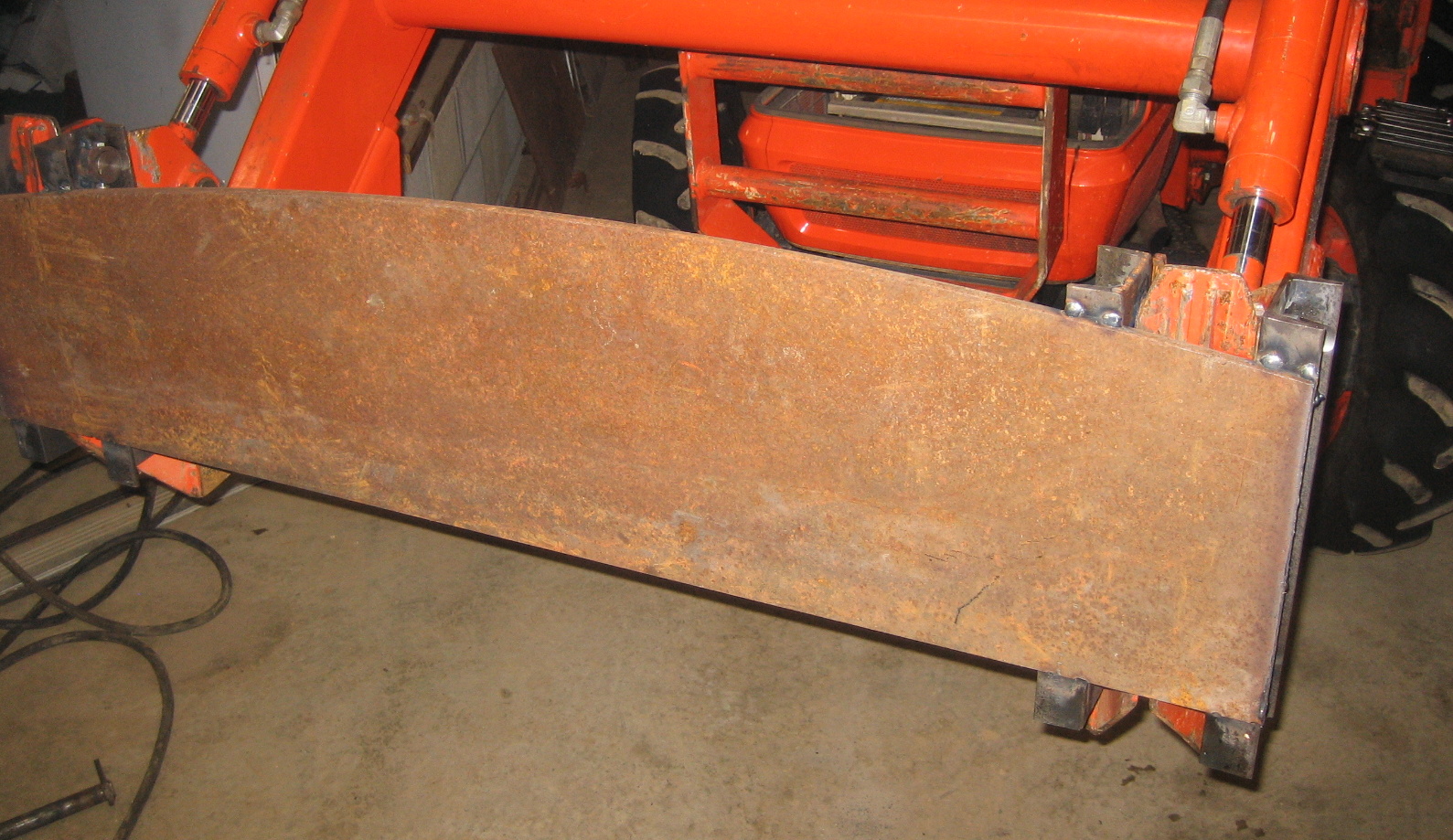

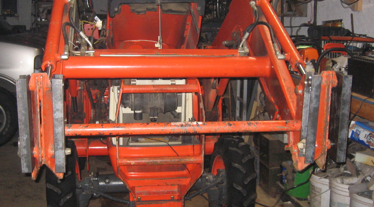

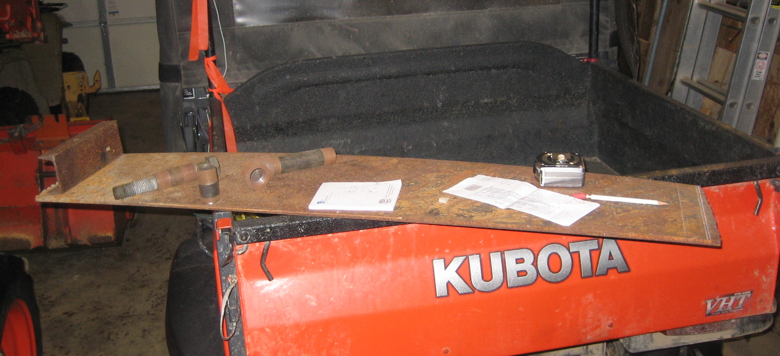

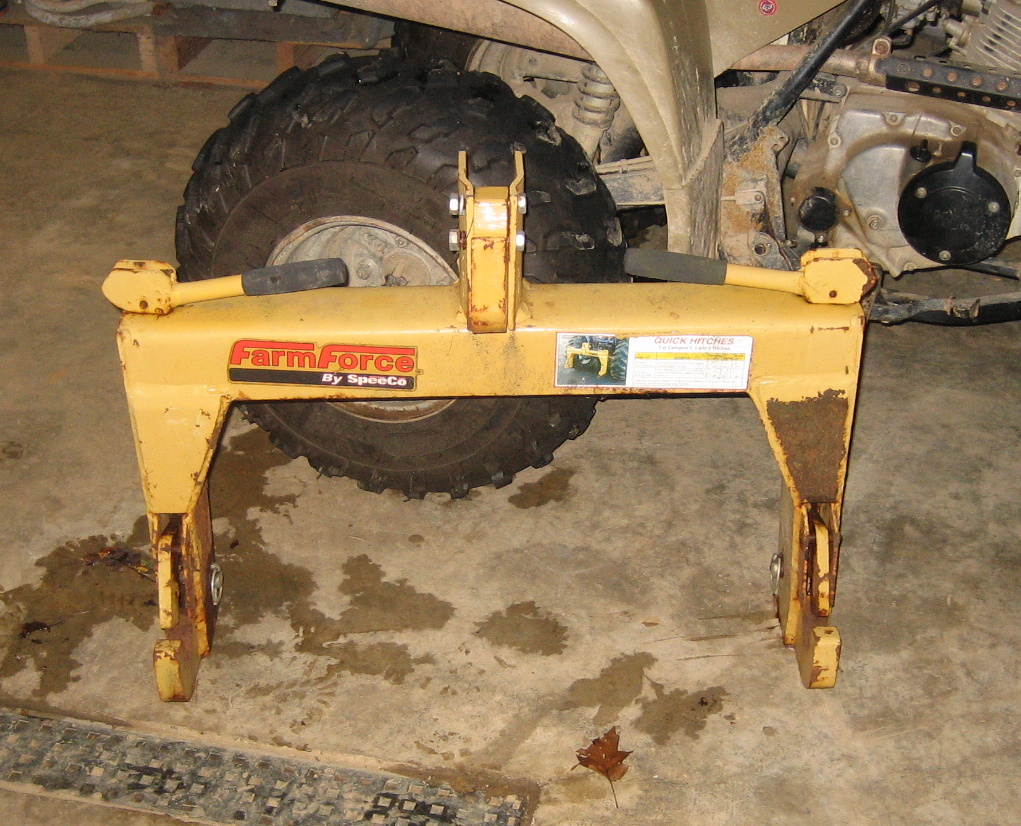

Well built this out of parts and pieces over the holiday's. Old Speedco quick hitch that I bought from TSC and really never used. It sat in the "Un-used "pile for several years, was going to sell it on CL or whatever.
Several beverages made the old mind creative so I put the machines in the shop to use!!!
Build me a front mount 3pt.
Now this is for pushing the snow banks back and not to use for regular plowing ---- Yeh no springs, overload loader arms blah blah blah
I measured the bucket bracket width and the pin spacing on the brackets.
Everything was made to fit on the ATI adapter I have.
Basics are:
Speedco hitch
3" C-channel
3/8" steel plate
1" cold rolled RB
1" black pipe for bushings
Tig, mig, stick welder
Lathe
Milling Machine
"Beverage"!!!!!!!!
Hope pics show!!

Thats a lot of leverage on the FEL, so be careful.
   / Speedco snow bank pusher #5
great idea
   / Speedco snow bank pusher #6
I have the same thoughts going thru my little head. Just hitting one solid object could ruin your day & tractor, but if you can be really careful, these have there place.
   / Speedco snow bank pusher #7
There is a reason front plows have trip springs.
