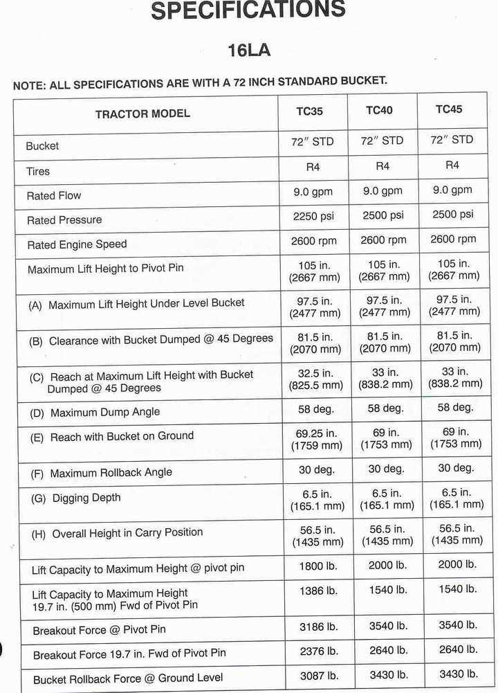

Troube in paradise. Dealer is having trouble getting a new Woods FEL for me, so I am considering the 16LA and taking a serious price hit.
Can anyone anyone point me to specs on this loader? The NH web site has almost nothing.

lift ht 105in
dump angle 58degrees
rollback 30 degrees
lift cap 1800lb on a TC35
breakout force 3186 lbs TC35
appx weight 1100lbs
clearance full height w/ bucket dumped 81.5in
digging depth 6.5in
It's a nice loader. Off and on easy. Joystick is integrated into tractor. Get the quick attach plate, bucket and forks - you won't be sorry.

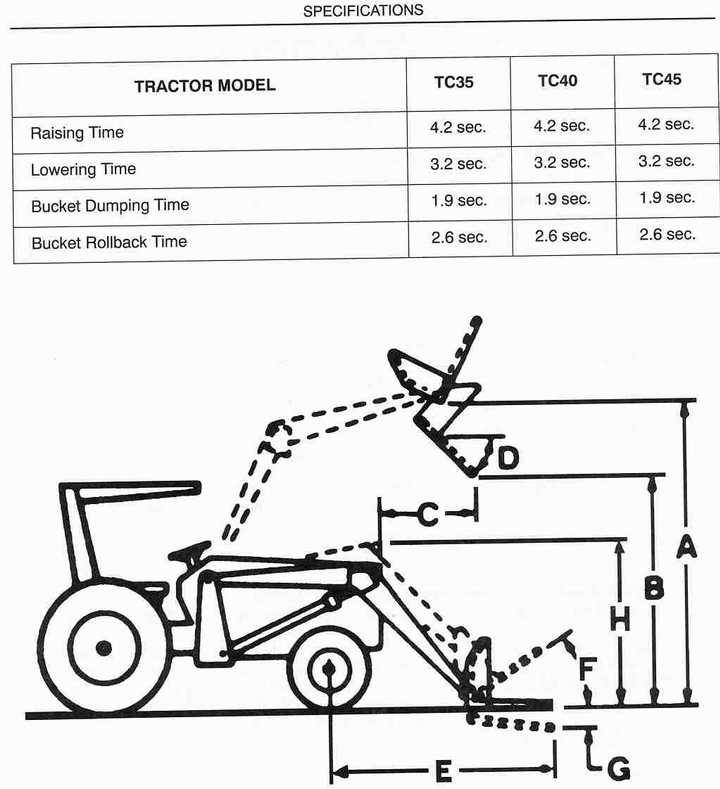

Here are the two pages from the Owner's Manual (attachment to this post and the next one). Mark covered most everything, but make sure you get the heavy duty bucket also. I think it is standard with the quick-attach, but if you opt to not have that, I recommend you stay away from the standard bucket. The HD bucket has holes predrilled for adding a cutter bar or tooth bar.
   / Specs on NH 16LA FEL #4
2nd page of specs...

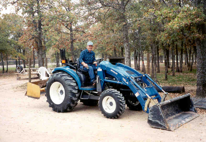

You're welcome! "Blame" accepted. /forums/images/graemlins/laugh.gif I don't think you can find a single person on TBN with a 16LA who has had anything bad to say about it. It's embarrassing how much I like my loader. It also sounds like you made yourself one heck of a good deal. /forums/images/graemlins/cool.gif
Just look at the loader in the attachment. Is that beautiful or what? ...it works better when you wear a blue shirt too. /forums/images/graemlins/smile.gif
