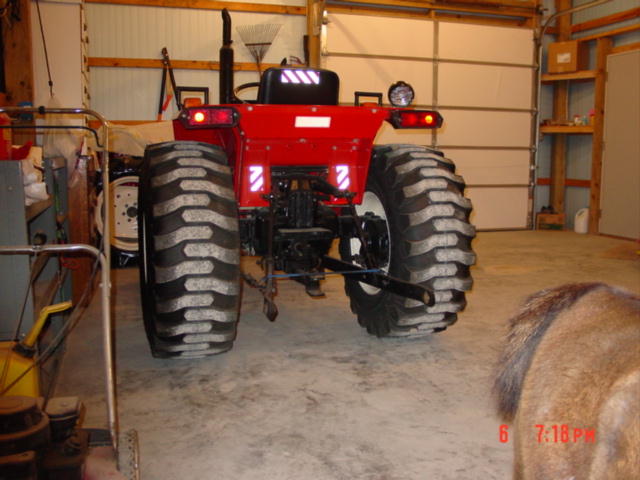

I have a guy make wheels for me. He will make any size any width any bolt pattern any offset. I have had several sets of wide wheels made to put industrial tires on my Yanmars. He is reasonable and good to deal with. The standard size wheels for a YM1401 should be cheaper than the Chevy wheels you mentioned.
