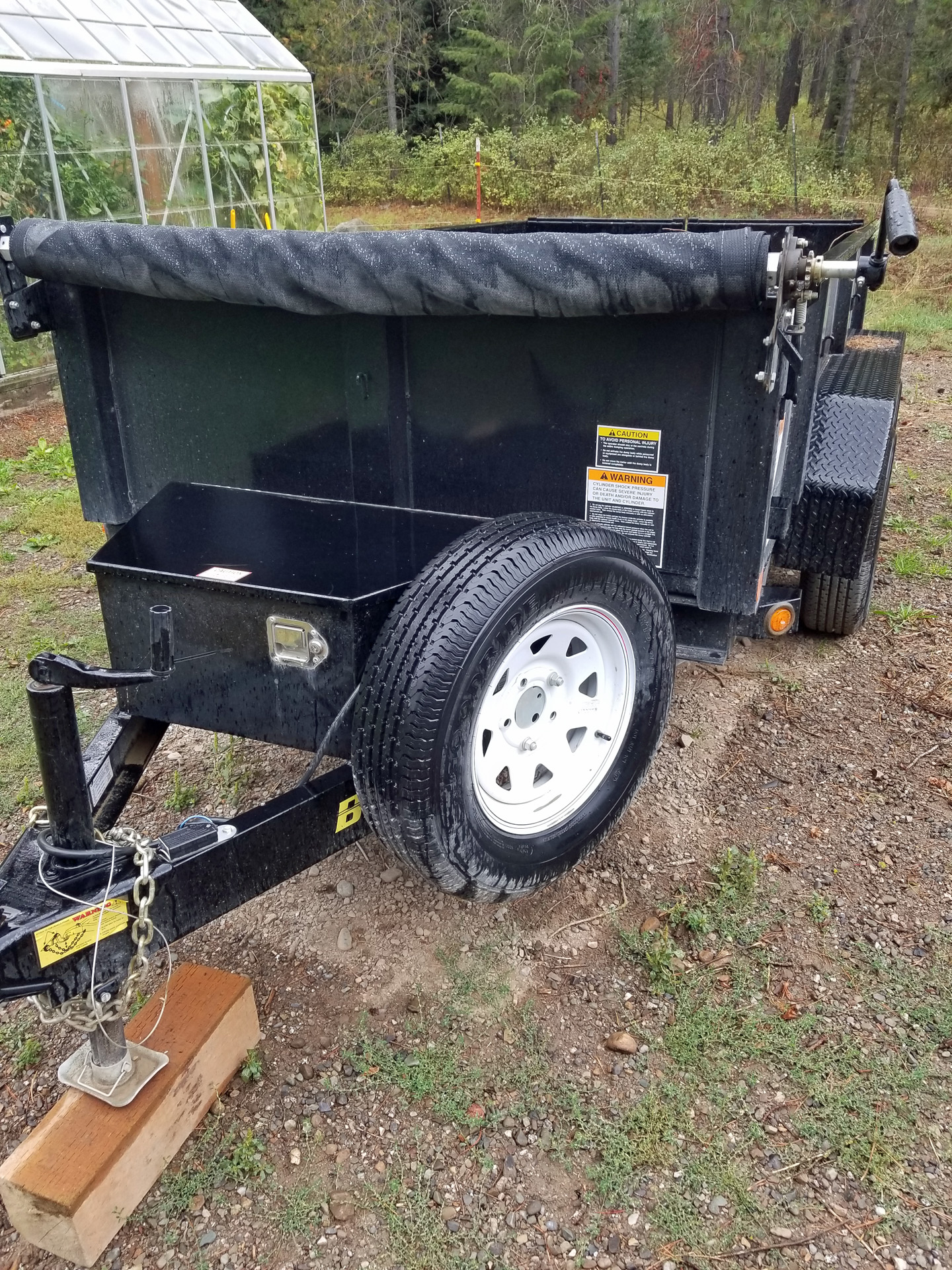

I added a side mount to mine. Its a welded mount purchased online. 20190918_085555-0.jpg

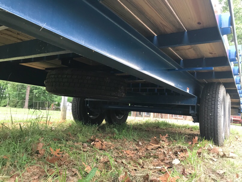

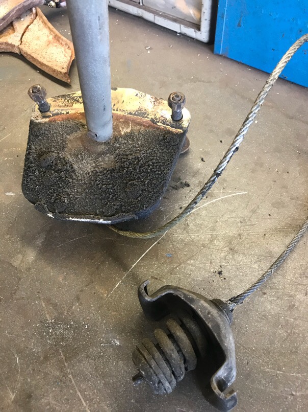

I got a tire winch off a wrecked pickup and mounted it under our gooseneck. Keeps it out of the sun.

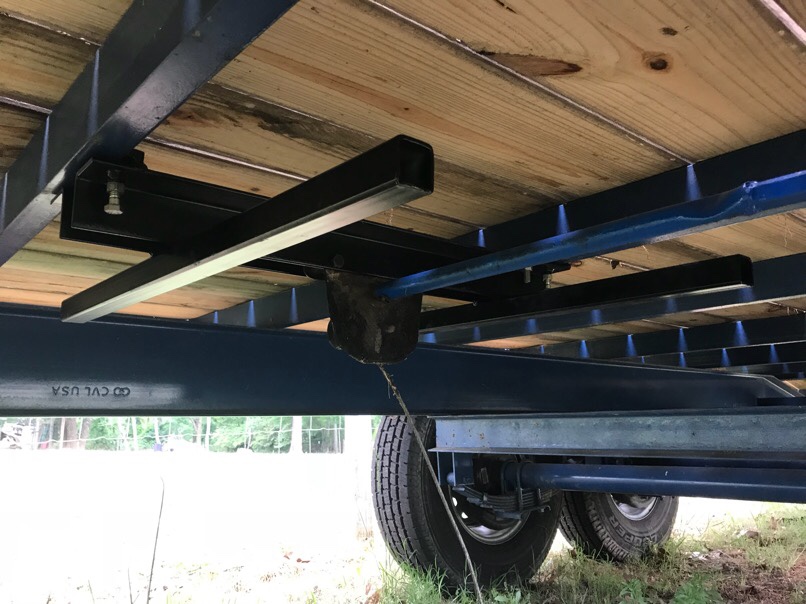

One thing I do different:
Rather than a hitch pin on the pivot, a chain across the bottom holding the latch could have a padlock on it, and also like a "cradle".
