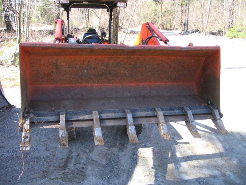

My 54" H&H toothbar has six teeth.
LA402 loader on a Kubota B2910...attached is a photo...six teeth seems like a good number, at least visually... /forums/images/graemlins/smile.gif

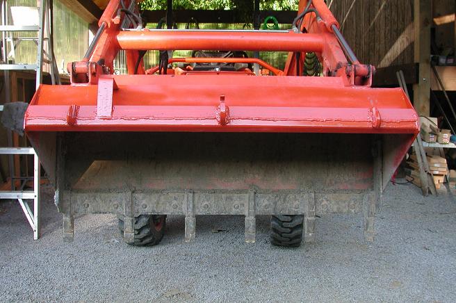

I have the 60" bucket on my Kubota B2710. My toothbar has 7 teeth spaced 9.5" on center.

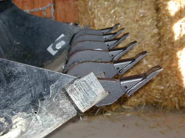

This is a 48" bar from Carver (actually W.R. Long). It has 6 teeth. I guess that extra tooth must make up for the price diff vs. Markham Welding...

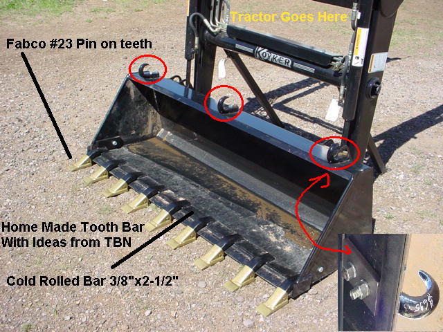

My 60" bucket has 9 teeth - (Home made tooth bar)
got the teeth on e-bay, they sent a couple extra teeth by mistake - so I used them all.
