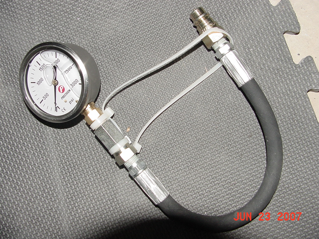

All you need a a 0-3000PSI liquid filled gauge, a short (24" or so)hose, and a male QD nipple that fits one of your loader or rear remote ports. Below is a picture of mine...
Now if you are talking about a "flow" gauge, then that gets a lot more pricey.
