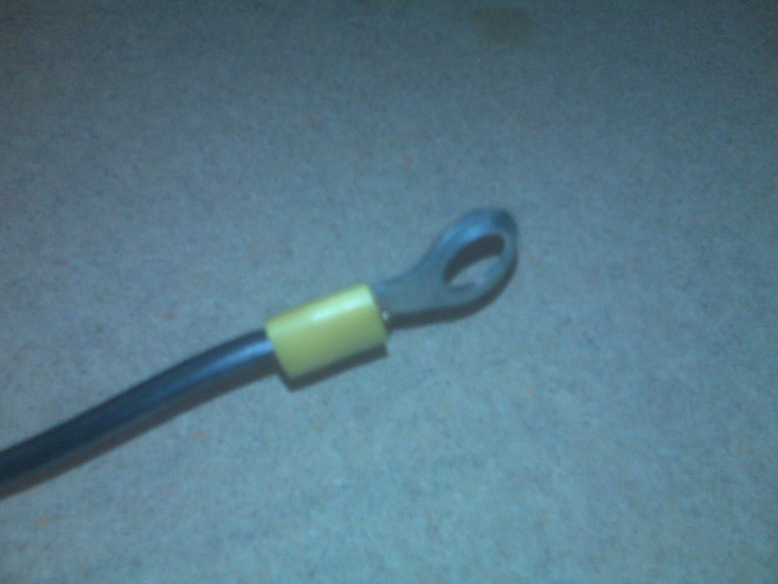

Can anyone recommend an online source when I can buy QUALITY ring terminals, connectors, etc. for 12 volt wiring? The big box stores locally seem to carry nothing but cheaply made crap that bends easily or the vinyl cracks when you crimp something. The attachment shows something I used as a battery tender hookup on my Deere, the ring terminal is bent badly and the vinyl is practically falling off after only a year. Thanks.

The best ones I have found are for marine use - one good company is Ancor. If there is any moisture exposure, the adhesive-lined heat shrink terminals work great - but they can't be disassembled, so make sure that's OK for your application.

Yes, marine with built in heat shrink. If you have a West Marine in your town they carry lots of this stuff.

Good quality (and I suspect the original patent holder) is AMP.
They are the ones used in aviation and most military applications.
