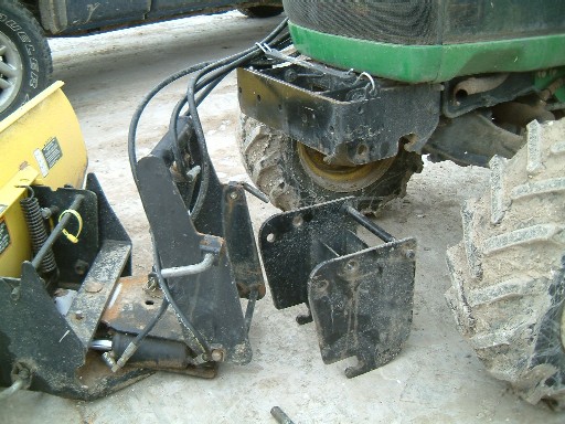

4100 Front Hitch, Quick-Tatch, and Blade with Quick-Tatch and Front Hitch removed.

Thanks Keeny!!! That shows everything I needed. It never fails to impress me, the amount of engineering and ingenuity that JD puts into its products. I plan on using those brackets to build off of for my own front blade. I just wanted to verify that all of JD's blade is supported by those 4 points and how.
That gets me off and running. Now to find the time to do it all.........

rp425,
Clean looking setup---did you fabricate the mount for the blade? Reason I ask, I have a 4210 with a 420 loader and a 54 inch power angle front blade on my old 318. Being retired I am too broke to buy a new blade to fit my 420, wondering how hard it is to make a mount for my older blade. Thanks.

JDgreen227 - I did fab the mount and it was not bad at all. I am in the process of changing blades along with a new mount that will incorporate a 7 ft. blade with dual hyd. cylinders. The 54" blade is way under sized for the 4110 with the correct weight and traction setup for winter snow plowing.
