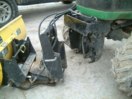

The following small pics are from the front Quick Hitch of a 2210 using a 54" blade. They will not be identical to the 4100/4110, but I hope the pics help:

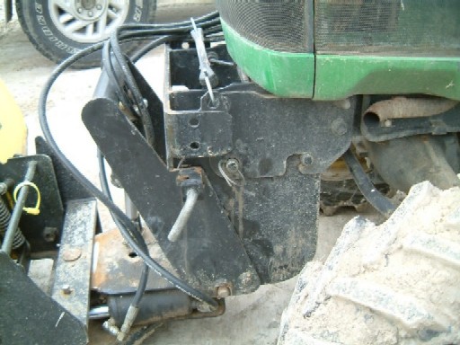

Close-up of Q-Hitch bracket installed w/2210 hood guard bracket.

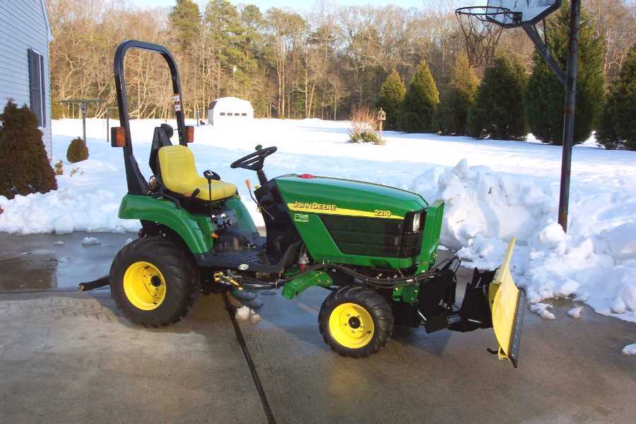

Tractor with blade installed.

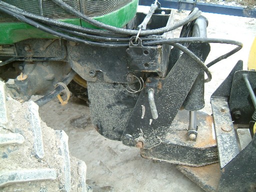

The 4100 is very similar. The "Front Hitch" is hung from the hole and finger on the under side of the grill guard. If you don't have the grill guard, you use the other set of brackets supplied.
If you have a MMM, you already have the brackets installed.
The Front Hitch on the 4100 hangs a few inches lower due to the higher front axle (bigger wheels).

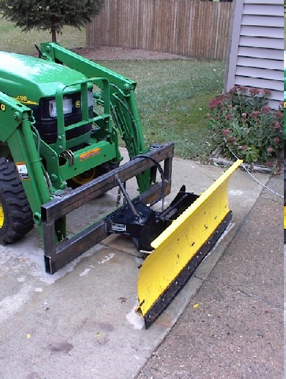

Forget the frame mount and go with a loader attachment. If you got the loader, much faster and more useful. See Picture.

I already have it attached to my loader. I just get a little nervous watching the loader arms vibrate and get pushed around while I am plowing. I have 1/2 mile of private road to attend to, so it's a lot of plowing 4.5' per pass. I just don't want to spring a loader arm or anything. So my thought was to re-fabricate my plow into a front blade and wanted to make sure that I wasn't going to affect anything underneath.

4100 Front Hitch, Quick-Tatch, and Blade

4100 Front Hitch, Quick-Tatch, and Blade, Other Side

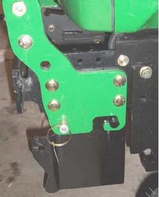

4100 Front Hitch, Quick-Tatch, and Blade with Quick-Tatch removed.
