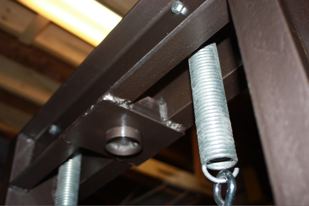

A 20T press I built. It was made out of scrap 6" x 1/4" steel channel.

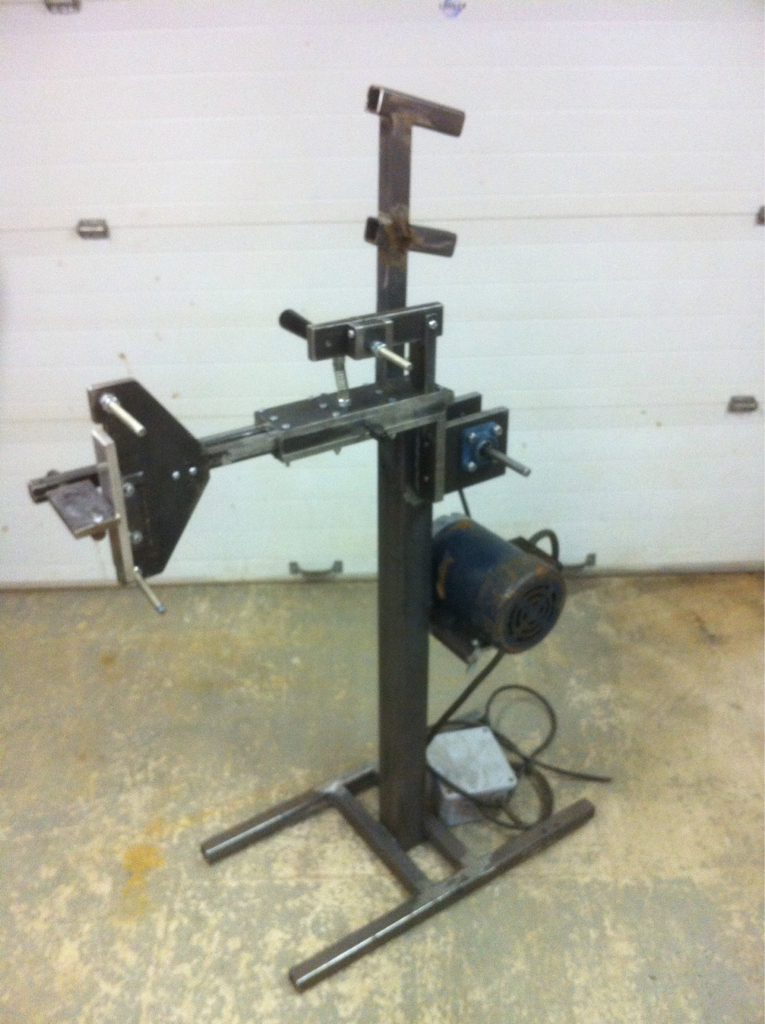

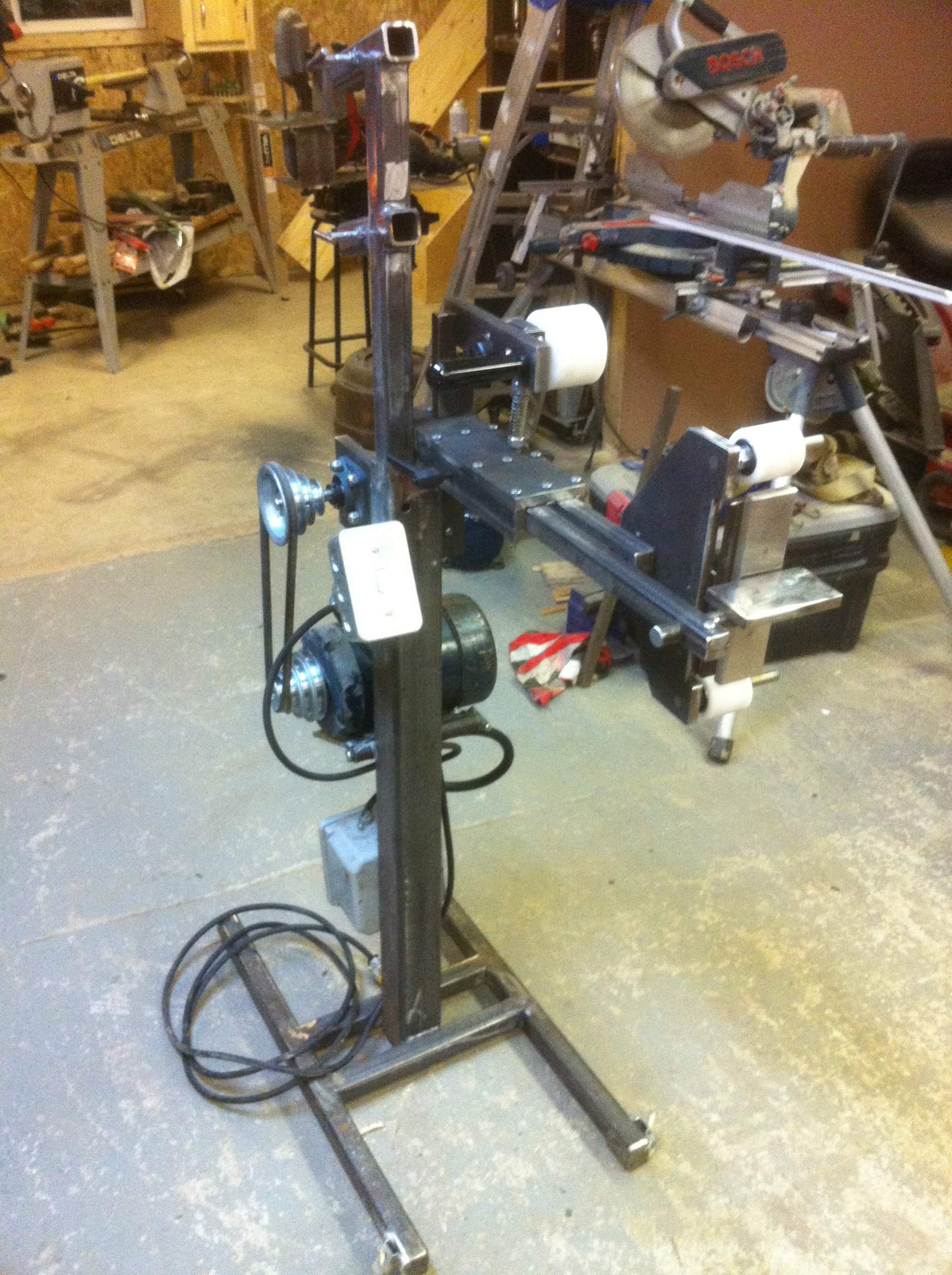

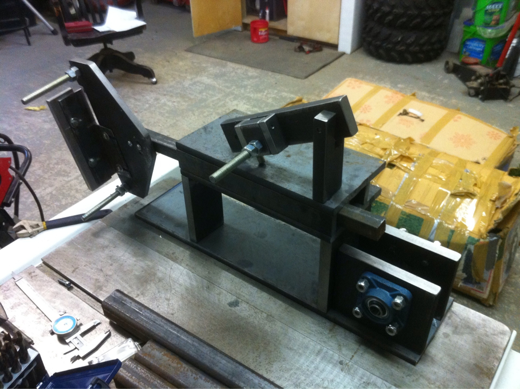

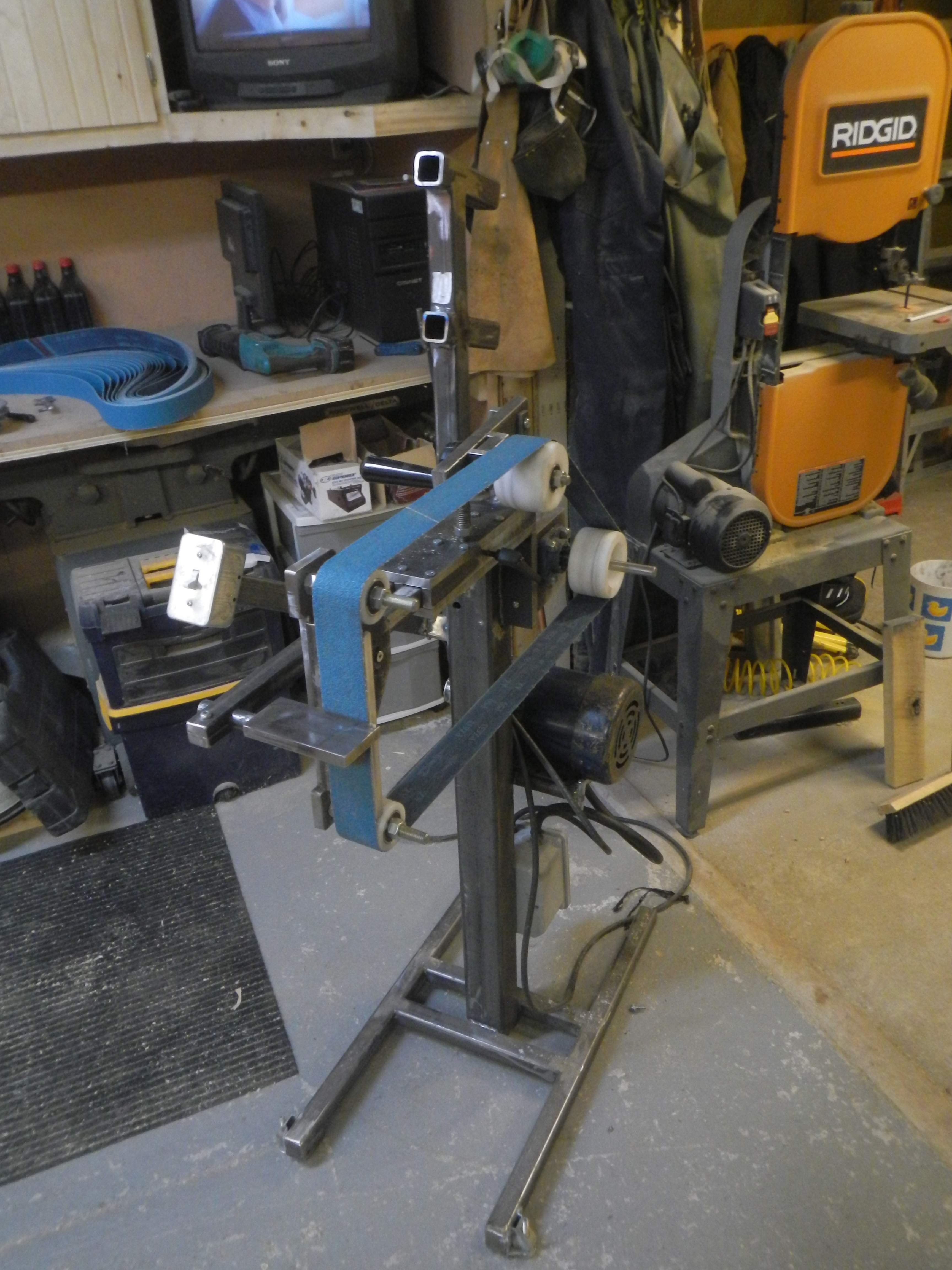

2" x 72" belt sander. Sander has a 2Hp motor and is on a stand with wheels. Very handy for cleaning up parts.

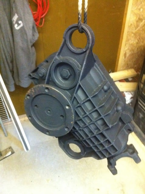

Tool stand built from a front differential out of a 95 Chev pickup. The base is a break drum off a big rig. Tools can be rotated by turning the yoke bringing the needed tool up to the front.

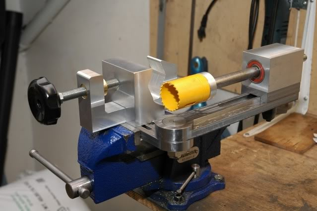

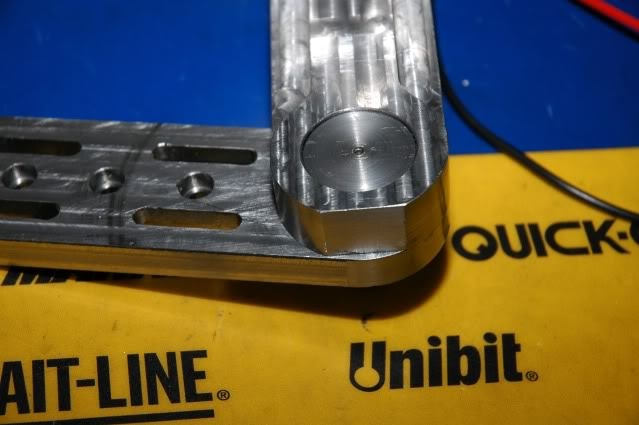

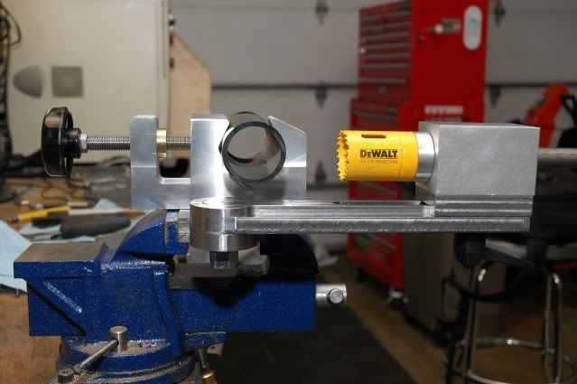

This is a tube notcher that a buddy machined for me. I didn't have my mill at the time so I got him to build it for me. It also has a shim back so you can do offset notches.

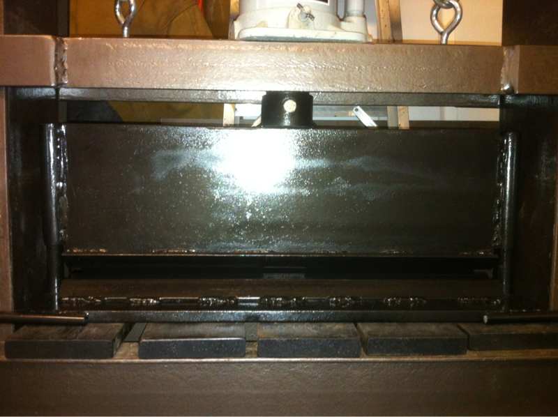

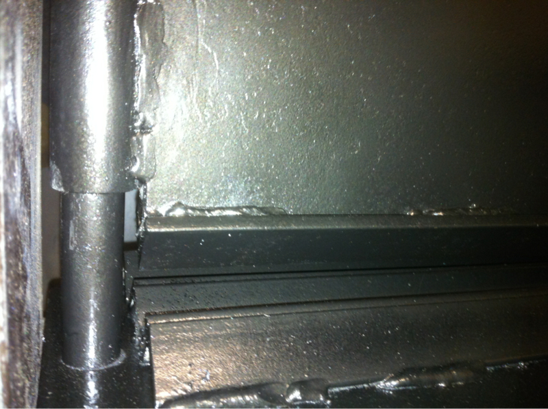

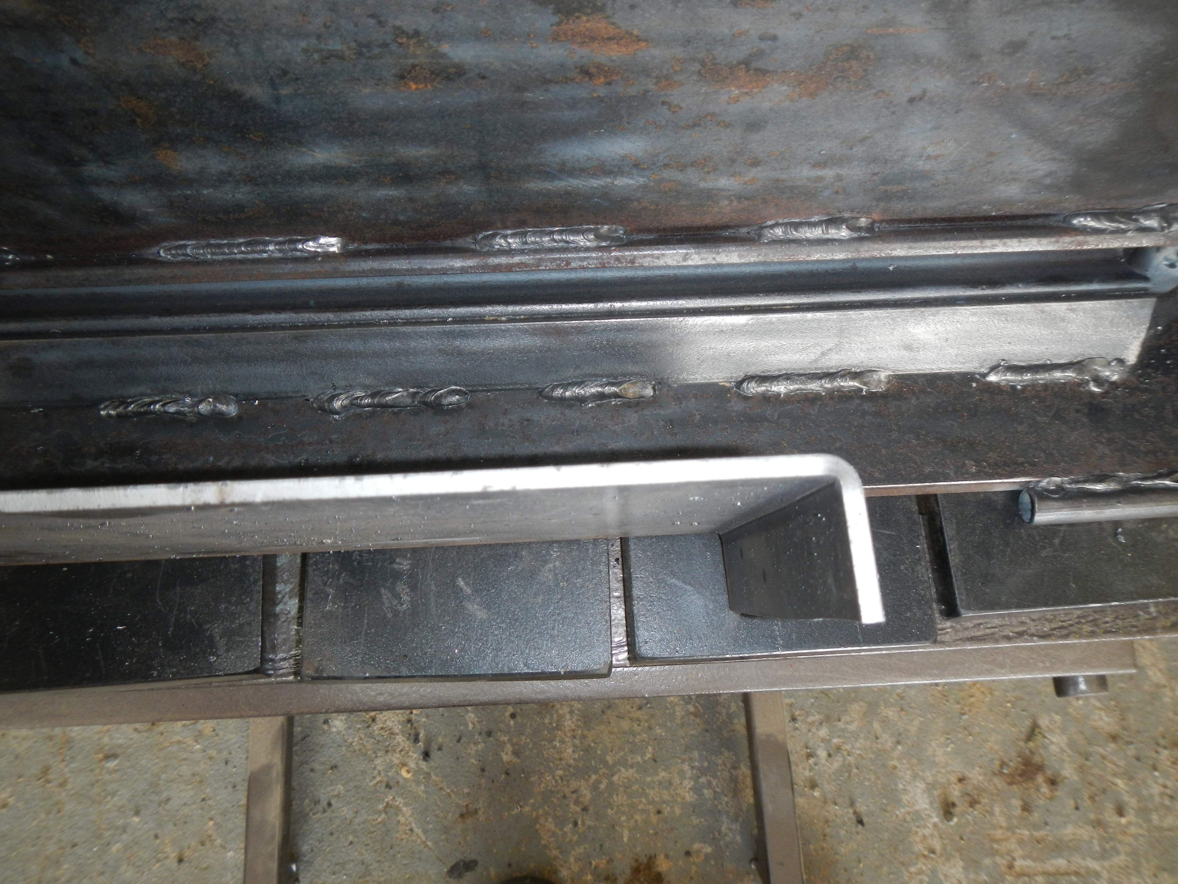

I needed to do some bends in some plate that I had and built this brake out of some scrap. Been meaning to build a better one but this one just works and doesn't show any signs of giving up just yet. It is made out of 1/2" x 6" plate and some heavy 1" angle.

What is the third position on the tool stand for? A belt sander?
   / Some shop tools I built
#11
Farmerford said:
Nice work!
Yes it is a cheap 1" belt sander. I never installed it afterwards. Didn't see the need with the 2" x 72" belt sander sitting a few feet away from it.

Why no finished pictures? Would like to see the belt sander.
#13
I will have to dig the finished pictures out and post them. These were all I had on my iPad. Here is a video of the building and first use of the belt grinder.

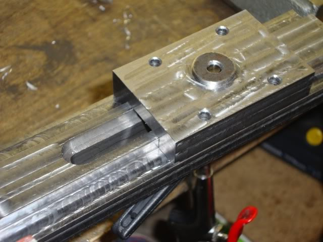

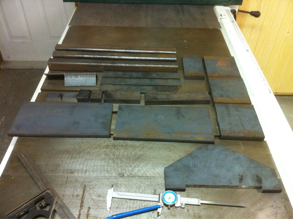

Here are the rest of the build pictures for the Belt Grinder.

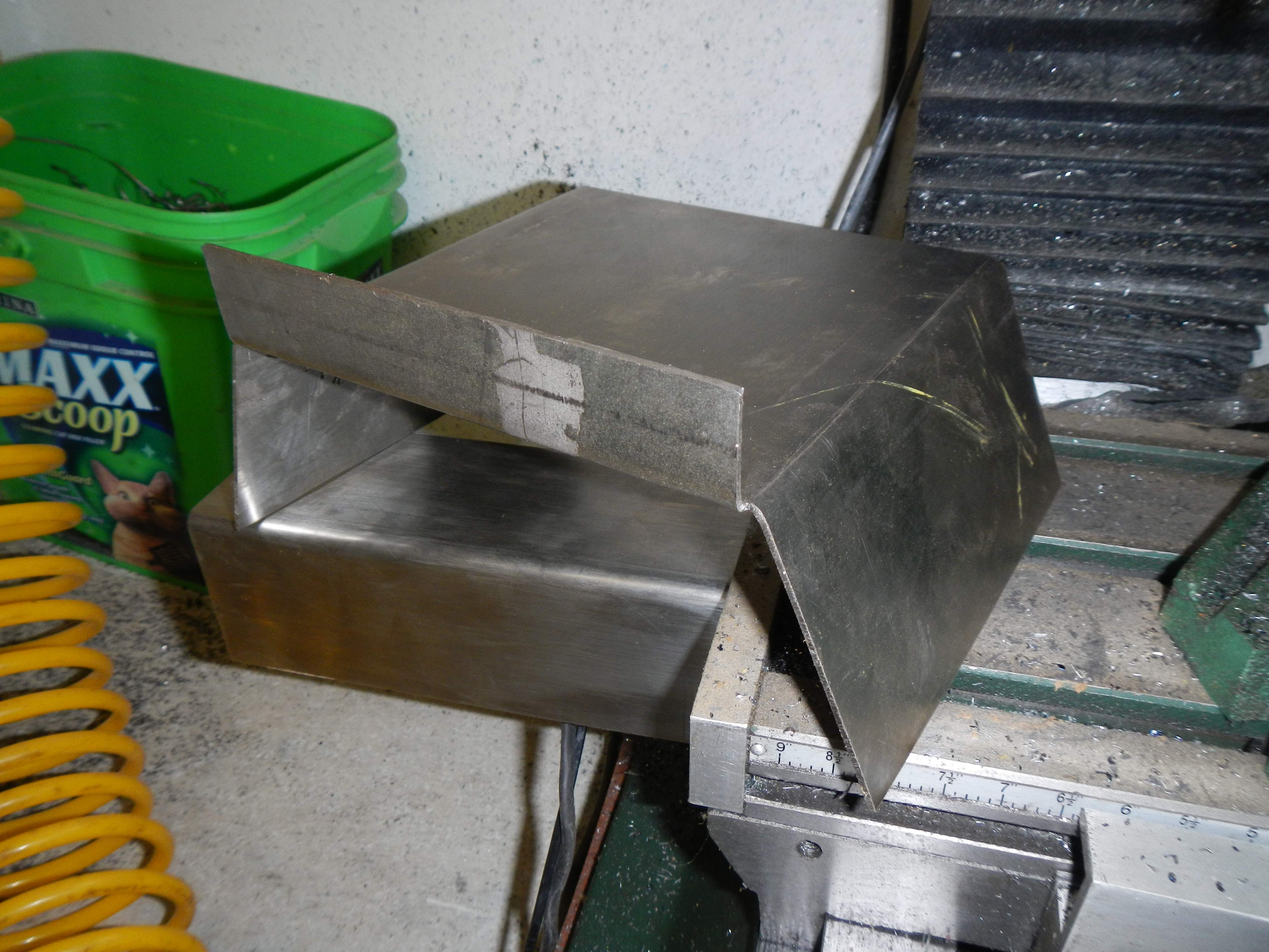

And the finish pictures of the press and some stainless steel stepper covers I made for the CNC mill.

By the number of 1" belts you have for the sander either you hit a huge garage sale or the lottery. Ellis builds one but I could not see enough usage to buy their expensive model. I always wanted to build a press but they sell them so cheap it is almost just the cost of the steel and jack. Besides 1" holes are hard for me to drill. I admire metal " artists " when it comes to building machines. Good work !
#19
The belts were an eBay buy. I got ten each of two different grits. The press was scrap stuff I had laying around so I only cost me a few dollars for the jack.
