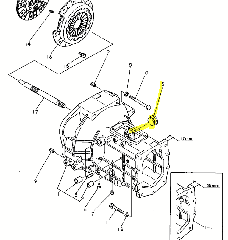

Some models have an access plate or remove a bolt to spray in there. Of course you are doing this blindly thru just a hole. Those old school Yanmar techs would know.
The YM2310 has item-5 as a Cap Housing, just like the YM226.
If you can remove item-5, you have access inside with a pen flashlight for a look-see.
Hint, this might be the same setup and clutch as the YM226. ;)
