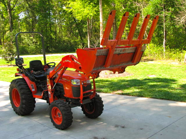

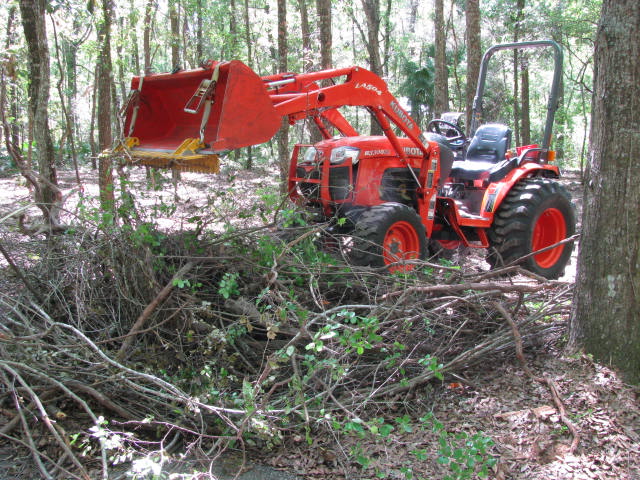

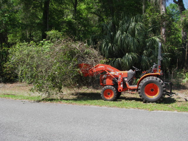

Will pallet forks suffice for moving piles of brush/branches?
If you will be moving debris regularly, like to a burn pile, spend the money for dedicated debris forks rather than making due with pallet forks.
COPIED IN FROM AN ARCHIVED JEFF9366 POST:
I am going to be CONTRARIAN and vote for purpose built Debris Forks and a Ratchet Rake for cleanup. This combination, alternating, works great for brush and vine cleanup. Usually have one or the other of these tools on the bucket. The combination is still MUCH less than a grapple and observes the KISS Principle.
The clamp-on, aluminum, 2,000 pound capacity Debris Forks from Payne's Forks were $800 in kubota orange. They have 14" of support under the bucket; stick out 26" in front for good pickup. Steel Debris Forks are less $$ but, being twice as heavy, you lose lift capacity. I have a LA504 loader on the B3300SU, so theoretically I can lift 504 Kilograms = 1,100 pounds under ideal conditions. Not close to 2,000 fork capacity. After 18 months of heavy use, aside from a few paint scuffs in the bucket where the screw pads contact, Payne's Debris Forks have given excellent service.
Well worth it for me, a heavy user.
LINK:
Paynes ALUMINUM Debris Forks
