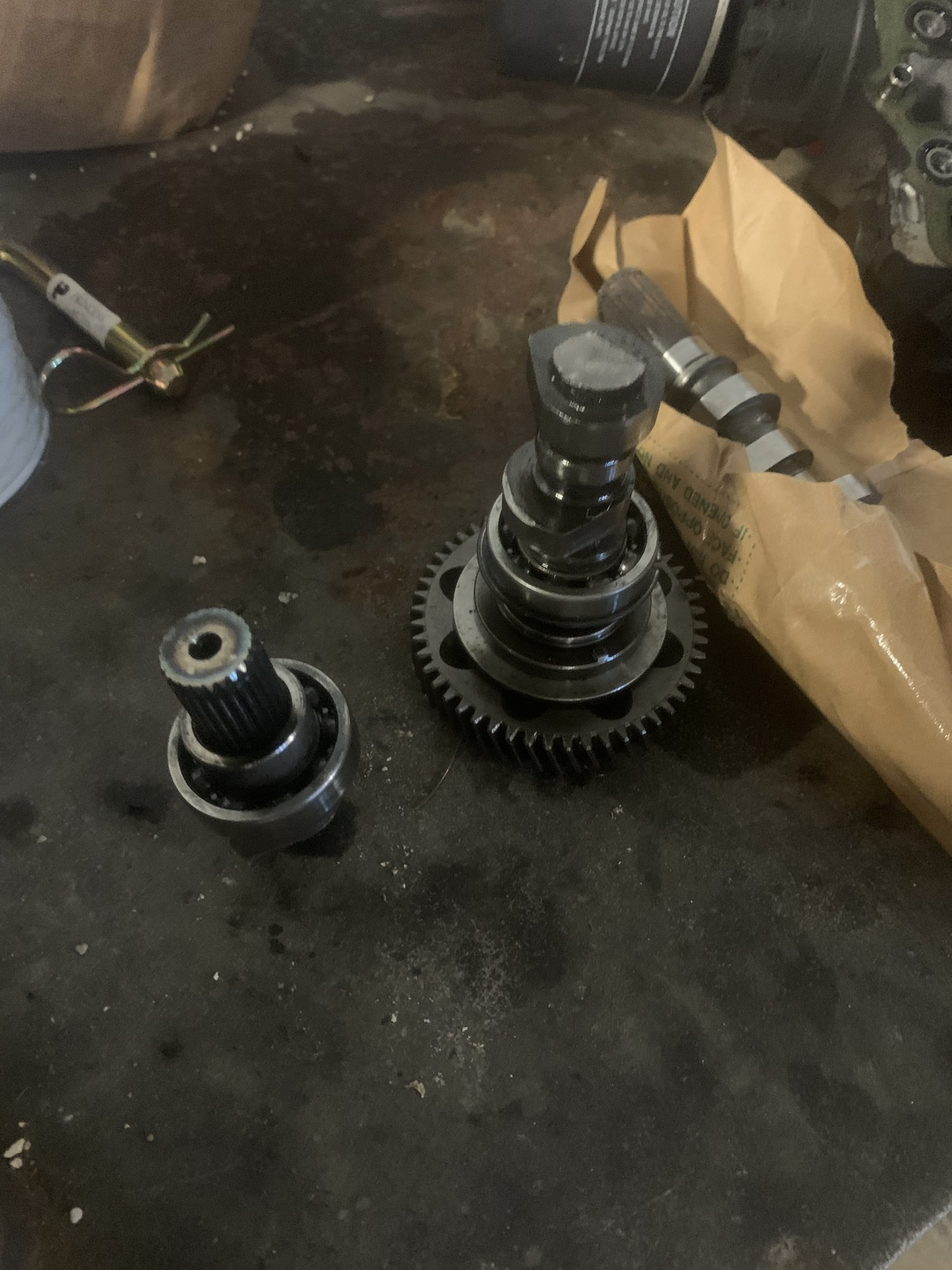

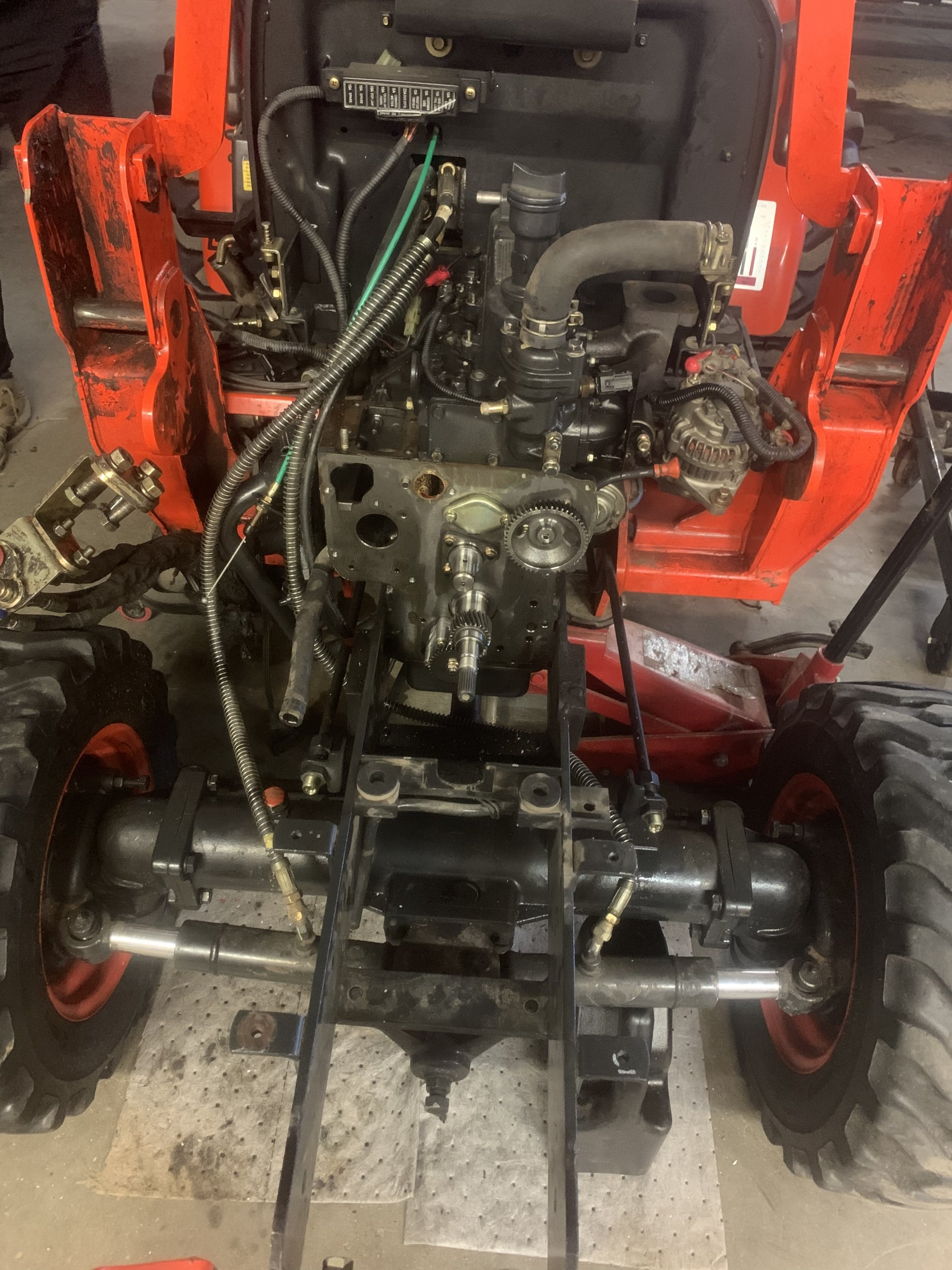

Wanted to give a conclusion for anyone that may have a similar issue. Ended up being the fuel crankshaft was sheared clean off between the 2nd and 3rd lobes. There was enough friction on it to continue to spin the 3rd lobe but it was way out of time. Almost invisible to see even with the high pressure injection pump removed. Local heavy diesel mechanic ended up diagnosing and repairing it for me. Had to remove the entire front part of the motor and he actually had to unbolt the front motor mounts and lift the engine to remove the timing cover. I’ve searched around and am aware of the injection issues the older ck20 had but don’t see to many issues with these camshafts. Also talked to local dealer and they hadn’t replaced any either. Hopefully it was built on a Friday and just a bad casting but I’m not sure I’ll ever know for sure. Hydraulic pump was free and is working great and it’s got a brand new injection pump so I ruled that out as well.

I’ve seen THAT once and on a separate occasion the key sheared..only 1x each in 35 years..
