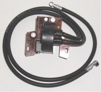

Yes, you can hook this spark tester in series with the spark plug. Simply plug the tester into the plug wire and attach the clip to the spark plug tip. You will be giving the ignition a "double-jump" which should prove just how strong the spark is.

Ill try that. I didnt think these small coils would have enough juice to jump two gaps
   / Craftsman / Briggs 18HP Running on 1 cylinder
#23
OK we now have SPARK~~!!!!:D
Im not sure what i did, but its working. I removed the flywheel to check the keyway and reinstalled, now theres spark.
Only thing i can figure is that the coil gap wasnt staying where i set it because one of the set screws was partially stripped (i didnt really catch this earlier).
I drilled and tapped for a larger screw, now its staying tight.
I bought some inline testers to confirm and all looks good!!!
