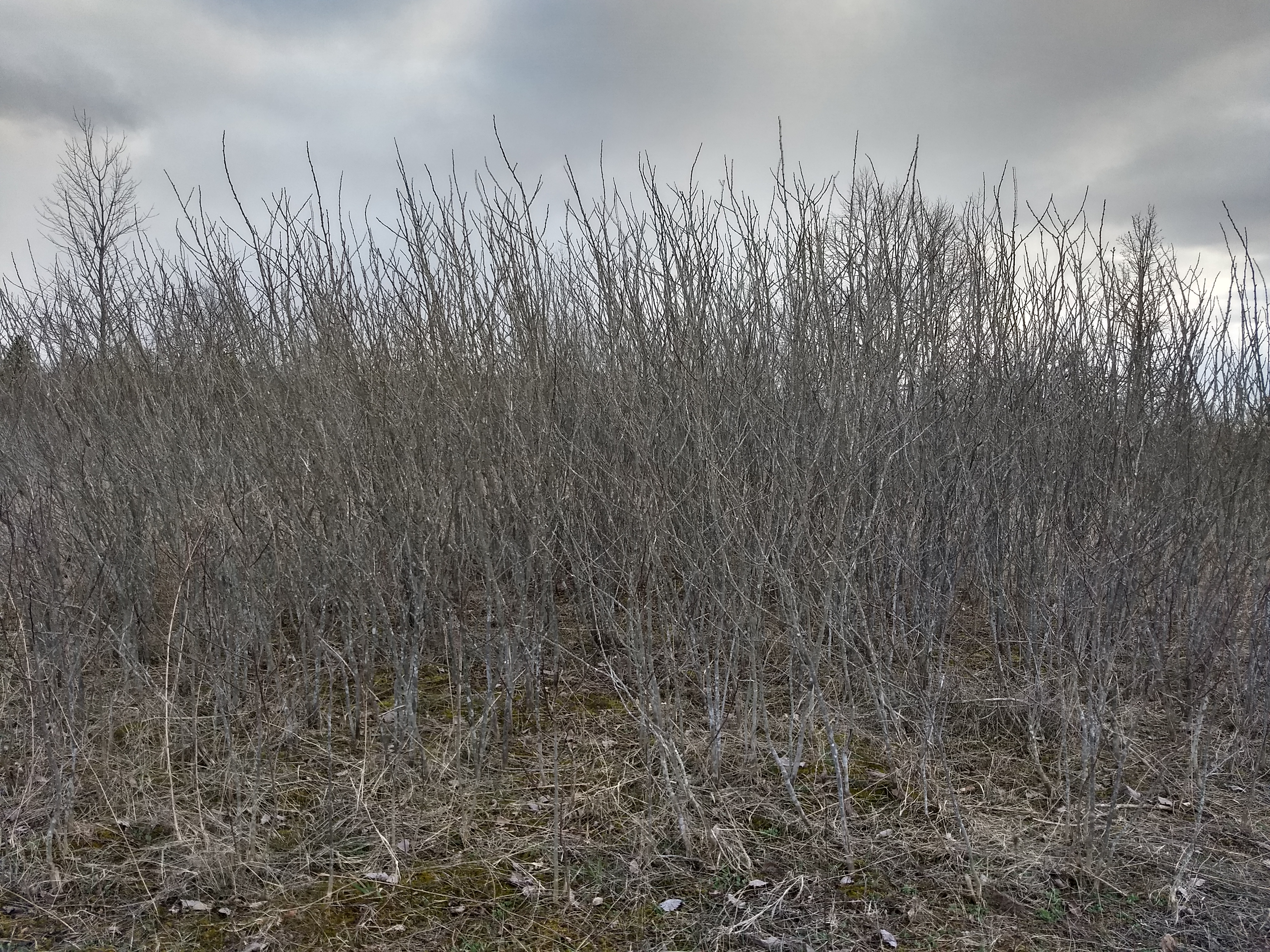

Hi,
on my lot I have lots of bushes of prickly ash which is fairly hard wood that grows about 6" apart. I have some bushes such as the one in attachment where the diameter of each tree is about 3/4" and they are about 7-8' tall. I have other bushes where the trees are about 2" diameter. I am looking for the best solution to cut these down.
I currently have a clearing saw that I can use with these, but it is a very slow process, due to the density/number of trees to cut (100s per bush), and that I have about 20 acres where these bushes are starting to spread. I also have a heavy duty 6' finising mower (Farm King Y655) with a reinforced 7 Ga deck on my tractor that I can use to cut young bushes going reverse and very slowly. The mower I have is obviously not an attachment that was designed for this though. I did look at rotary cutters for my tractor (Bush Hog BH215, Land Pride RCF2060, Woods BB60X and BB60.30), but these use very thin steel (10-11 Ga with), with no rear reinforcement at all (the Woods models with either a tube or Z channel at the back are better than the others though), so it would get badly bent if I was backing into these 8' bushes with that. Also, although they have a 2" cutting capacity, I would guess these are more designed to cut a lonely 2" diameter tree than a bush full of 1" trees that are growing 6" apart. I did look at other rotary cutters, such as the BH315, Land Pride RCF2760 and Woods BB60.50. These have thicker steel, but they don't seem to be really designed to back into tall bushes either, and their rated minimum required PTO power is between 30-35 HP, which I was told is too high for my tractor (I was told I was risking damaging my tractor of the gear box/slip clutch was rated 100+ hp).
So I was wondering, is there a better solution for what I am trying to do?
Thank you!

Spray to completely kill them and the root system and burn.
Yes, that would work for sure, but I prefer avoiding herbicides as much as possible. Maybe there would be a way to burn them though?
Once I cut a bush down it is fairly easy to prevent it from growing by going back with my HD finishing mower. I was more looking for a mechanical solution to cut the bushes down...

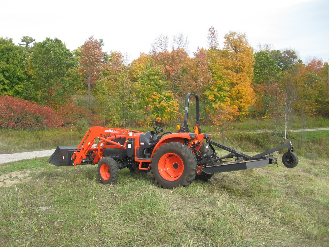

Get a Brown tree cutter:

A good heavy duty brush hog will cut that stuff, the best way with a tractor mounted brush hog would be to raise it up a foot or better then get after it.
Either by backing thru it or driving thru, I would back up the first time. If going forward thru it set you bucket 5-6 inches off the ground and curled most of the way back.
The best solution would be to hire a skidsteer with a heavy brush hog to mow it all down the first time,
then use your equipment to mulch up the pieces and stay on top of it.

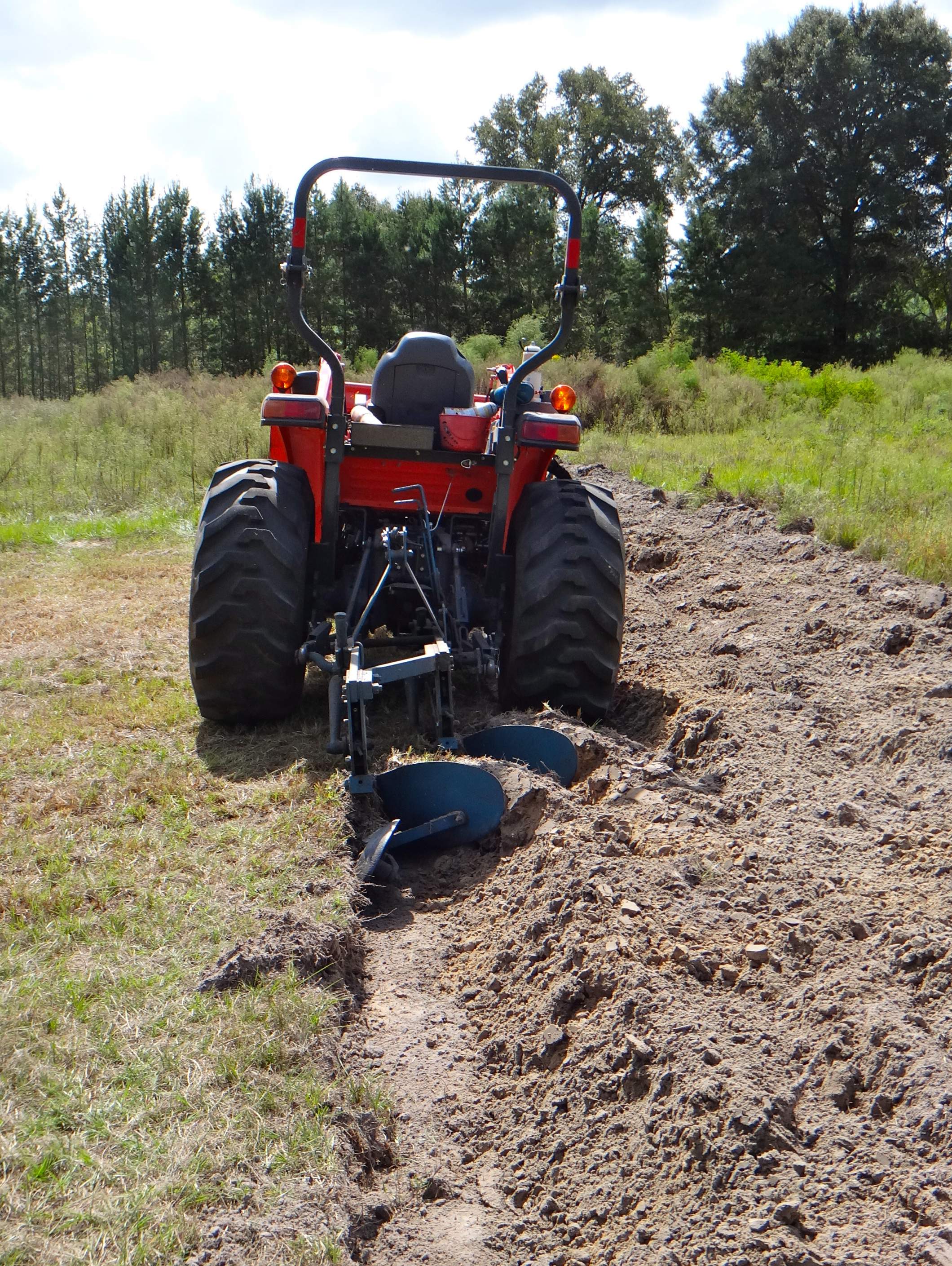

The traditional root eradication implement is a turning (moldboard) plow. Traditional plows INVERT the soil, so most of the underground roots are exposed to the sun, dry out and die.
Compact tractor plows come in 12" - 14" - 20" widths. You need a plow width at least as wide as the width of one rear tire width, as right/rear tire has to roll in the bottom of a plow furrow. Plows will penetrate about 1/2 of their width into the soil and invert from midpoint upward. Plowing beautifully is a tractor skill that takes quite some time to learn.
A double (two bottom) turning plow in 14" width will invert 28" of soil per swathe, plowing approximately one acre per hour. (Probably 1/2 acre per hour while learning plow adjustment.)
CANADIAN VENDER: Braber Equipment - Plows
