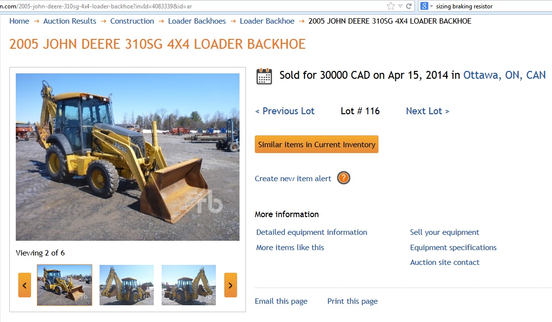

- My personal preference is to stay away from dealers. Whether they represent a known brand or not. You are buying an old machine and they come with no warranties. Most non branded dealers buy their machines at auction, no nothing of the history, and slap on $10k or $15k more than they paid for it at auction. Recently this machine:
Sold at auction for $30k, next day it was on Kijiji for $45k for sale by a dealer. I've seen other examples where I've been at the auction then see the same machines turn up on dealer lots, with nothing done to them.
