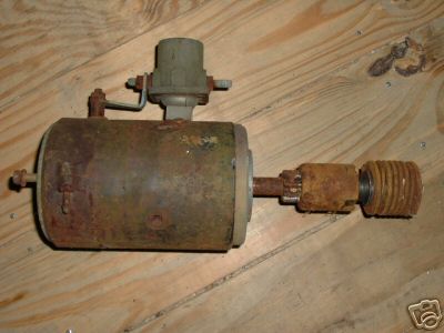

As for the starter, there should only be 2 bolts.. long ones.. they go all the way thru the starter into the casting. Caution.. do not remove the bolts from the starter housing, as the end plate is the brush holder, and is completely seperate from the field housing, and the bolts keep it lined up. If you pull the bolts out, and the armature travels more than an inch forward, the brushed pop out of the holders, and then you have to remove the brush guard , and cuss for an hour trying to slide hte armature back in while using toothpicks to hold all the brushes back in.
To remove my starter, I had to
1 loosten the bolts so they were out of the casting.. but still in the starter.( they only theread in about an inch into the casting.. Then removed the round thin sheath covering the brushes. I removed the block drain petcock, and then remove dthe bolts holding the oil filter canister.. but did not have to remove the cannister or the lines. The steel lines flex enough to get the inch or som of movement you need. When pulling the starter out, as soon as the starter is clear of the casting by 1/2 inch.. take a 7/16? nut and thread onto one o fthe long screws... this keeps the starter from falling into 3 pieces in your hand. Next, angle the rear of the starter toward the block.. in fact, let the rear edge of the starter contact the block,.. this is why you removed the drain petcock. The it should slide out.. if it hangs a bit, angle the starter down a bit.. but still towards the block. The bendix drive on these starters is actually fixed on to the end of the long starter armature, and engages the back of the flywheel. So when it starts, the bendix moves 'in' towards the starter, and then spins back 'out' towards the end of the shaft when the engine starts. The end of the bendix has a big tension spring on it.. and this is what has to clear the ring gear on the way out. Some tracors that have had the starter changed before have had the casting filed down at the 2' position, if you are looking into the starter hole. this greatly helps instalation and removal.. but it is doable without the filing, as the ford mechanics installed in in the assembly line, as is.

I have a pic of an old ford starter. it should give you an idea of what I'm talking about. Just picture it like this. The flywheel is situated between bendix on the end of the shaft, and the starter.. so you have to swing it out a bit to clear it.
In certain cases, the bendix sticks inthe flywheel, and you have to put the tractor in 4th gear, and rock it back and forth to get the starter drive to spring free.
I quick edit here. For some reason I thought wwere were talking about a 8n. The NAA-6xx 8xx starter is slightly different... but not too much. The mounting flange is different. My master parts catalog still only shows 2 bolts.. not 3, and uses a similar looking starter drive. Also.. the manual is not the fo-4 or the fo-19.. not sure what it is for a 6xx series. Also, not sur ethat there is a ford shop manual available for a 6xx either. But there IS a master parts catalog available. It covers the NAA 6xx and 8xx. I have one. and just looked it over. It only shows 2 mounting bolts as well. Though I don't have a 6xx to run out and verify that. These re-print manuals are not always 100% accurate.. etc.
Keep in mind this pic is of a starter from a 48-52 model.. not a 55 model like the 640.. but it is only slightly different at the mounting flange.

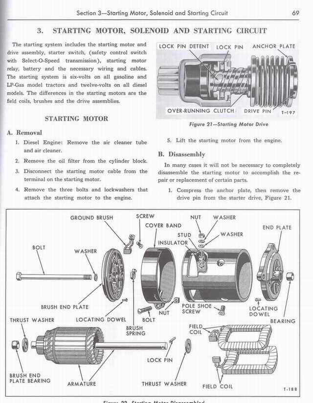

Kirt, my service manual says to remove the oil filter, electrical cable, and the three bolts and lockwashers from the starter where it attaches to the bell housing flange. It then says to lift the starter motor from the engine. That's all the instructions it gives. As you know, it may not be that easy. /forums/images/graemlins/crazy.gif
Hopefully by the time you read this post you will have your Service Manual on order. If not, the part number is: 40060090. I think that's a New Holland number. There are five pages in the manual that describe testing and disassembly/reassembly of the starter, brushes, bearings, and bendix drive. If you can't get the manual, I can send you these pages. If I were doing it, I think I'd just try to get it rebuilt at a starter shop, but that's just me. You might want all the "fun" for yourself. /forums/images/graemlins/grin.gif

Kirt, I think my manual was around $50, but that was almost 10 years ago. I'm attaching the first page out of the Starter Motor section which shows the complete assembly/disassembly. There are special tools for driving out bushings and I think a starter/generator shop would have these punches. If your starter is dragging, it might be bearings or it just might need new brushes and the commutator dressed.
I think you will like having that Service Manual. There are lots of pages about the Select-O-Speed transmission /forums/images/graemlins/tongue.gif, but the rest of the manual is pretty good. /forums/images/graemlins/cool.gif
