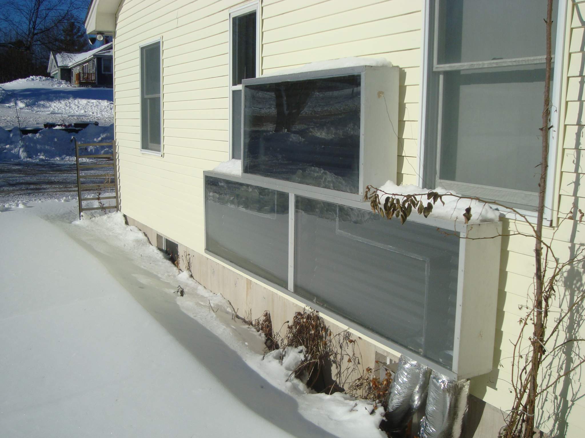

   / solar thermal heating #24
I built this about 3 years ago and it heats 3 lower room nicely on sunny days ...

--> I'd say probably not.
I think you would be better off with dividing the collector in two.
If the top of the collector was not interrupted by the window, I'd say an alternative would be to have plenums either along the top and bottom or vertical ones at the right and left edges, but the window makes either of those questionable.
You might think about adding a third layer of screen this might improve the thermal efficiency a bit, and would give a little more pressure drop that would help spread the air better.
Bear in mind that there is just not a lot of material out there on how air really behaves in these collectors -- about the best you can do is make an educated guess.
I'd think about doing two collectors with the dividing line extending down from the center of the window. The inlets for the two collectors could be a common inlet under the center of the window and down by the floor. The collector outlets could be upper right and upper left. It seems like this might give a better chance of getting good flow to the full collector?
I like this idea, It would be an easier sell, I think, to my wife.
, this level of airflow will give you about a 50 to 60F temp rise with good sun.
***Is this from the outside air temp? or what is already inside?
--> That's along the lines of room air enters the inlet at about 65F, and leaves the collector at about 120F in good sun conditions. You won't get that kind of temp rise in part sun, or in the early morning or late afternoon, and you don't want the temp rise to get so low that the air feels cool because its moving. But you also don't want too much temperature rise, as this means the absorber is running hot, and is losing a lot of heat out the glazing -- this is important as this heat loss out the glazing is most of the reason that collectors run at 50% or so efficiency rather than 90%.
With the fans pulling the air out, would i be able to then get away with using a heavier dampner, ie dryer vent as opposed to the plastic that you have used?
--> Yes, I think so.
Either pushing or pulling, fan forced collectors can use dampers that require more pressure to open than thermosyphon collectors.
You just want to make sure the inlet and outlet vents and the damper opening are not too small as this will cause pressure drop and less flow.
Thank you so much for all your info already. I was talking to the wife and she said "make sure you post that im skeptical and I want to see pictures of what it will look like on the inside".
I went to build it solar and she has a much better idea, ty again. I am also going to try to find wooden cover for the fans.
--> On the making the collector look better front:
- If you have clear glazing like SunTuf or glass, you will see the screens, and to some degree the color of the back wall of the collector.
The screens actually look pretty good -- kind of a nice soft look.
The screen collectors (I think) look better if you don't paint the back wall black, but choose some medium dark color that matches the house.
On my barn screen collector, you can in the pictures that it does not have the "big black square" look because you see the siding color a bit through the screen. The collector would likely be just a bit more efficient with the black back wall, but (for me) the aesthetic gain outweighs the small efficiency increase.
- Another option is to use twinwall glazing. I think it has a really nice look, and you don't see the internals of the collector through it. If you are in a cold climate it also adds a bit of efficiency. If you can find a good local source, it does not add all that much to the cost -- a good price is about $1.80 a sqft. I'd use 10mm thick or thicker.
greenhouse cover glazing materials at reasonable cost
Shipping is a killer on this stuff, so local is best if you can.
- The trim around the outside of the collector makes a big difference
on how the collector looks. I kind of like the PVC wood or deck wood, as they look pretty good, and they have a good life.
-- Couple of examples of (I think) nice looking collectors:
This is my new solar water heating collector glazed with twinwall:
A Simple DIY Solar Space and Water Heating System
The page is not done yet, but there are a few pictures that show the look.
This is Knick's collector:
A $1K Solar Water Heating System that Looks Great
twinwall with a nice frame.
The fans should I be looking at bathroom vent fans or a different type of fan?
ty once again.
**when you use the screening do you also use baffles to control the direction of the air flow. how do you control the flow with the al soffit?
--> the vented alum soffit and the screen collectors work the same way. The vent holes in the soffit act the same way as the holes in the screen.
I guess that the ones I've seen (not that many large ones) did not use baffles, and I'm not sure how you would use baffles with flow on both sides of the screen/soffit? They tend to rely on the pressure drop across the screen or soffit to distribute the air. Again, I've not seen anyone who has actually done the work to see exactly where the flow does go, but it does make some sense.
