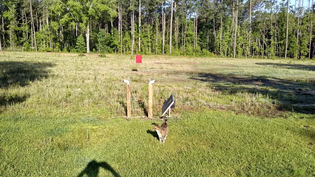

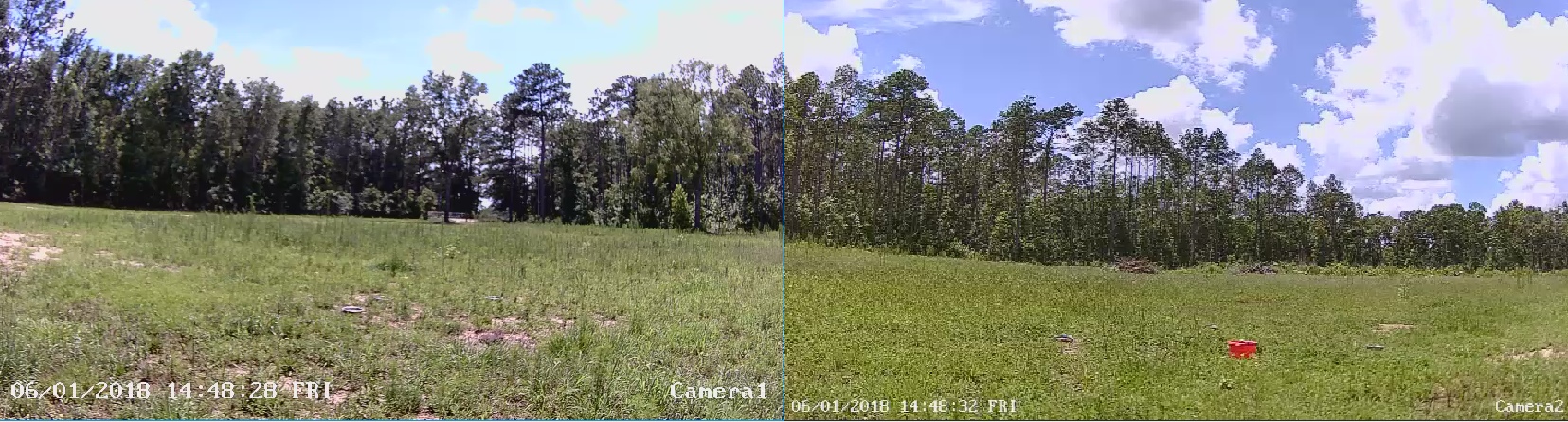

The reason I asked about wifi is you can set up a wifi camera so the app will notify you over your network to you cell phone. Don't ask me how it works but it does. Even when I am away from my network it will notify me of activity if I have that setting turned on. I have a couple of wifi security cameras on my network that have built in 16GB SD cards. They record motion detected videos I can download from the camera through the network and they will also notify me of activity if I set the app to do so. The problem with such a setup for your purpose is they would likely get seen and stolen.
Here are my two cameras I use primarily to monitor wildlife but they are set up to provide a panoramic view of the front of my property, including my gated entrance. I could probably have them on a smaller solar panel but by the time I found the bad connection causing my battery to go dead I had upgraded to a group 24 deep cycle battery on a 100W panel. ;)
