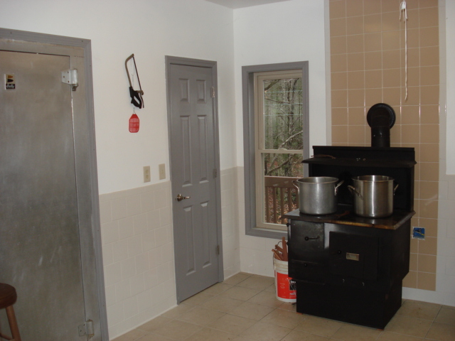

Which is why before the first solar panel ever went up, we have gravity fed spring water system, the "stack" (and it's WIDE and DEEP :D ), an auxiliary kitchen I built on the back of the garage with walk-in cooler ( we process our own meat here on the farm ) ( and another reason electric power is handy from time to time....let's one chill the meat when nature isn't co-operating ) that has the wood cook stove, and we've heated the house with wood for 30 years.
Pic of part of the AuxKitchen.....wood stove, pantry, walk-in cooler door.
(6'x6' walk-in, by the way, is powered by a 12,000 BTU Samsung window AC with a "Coolbot" controller...will take the room down to 33 degrees )
