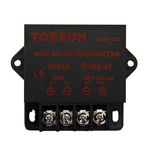

Now, I tend to cheat some. I can take a charged Ryobi power tool battery and a DC-DC convertor of 24VDC to 12VDC and power things twice as long nearly. It's more incredible this way as 20VDC lithium power tool batteries are plentiful.

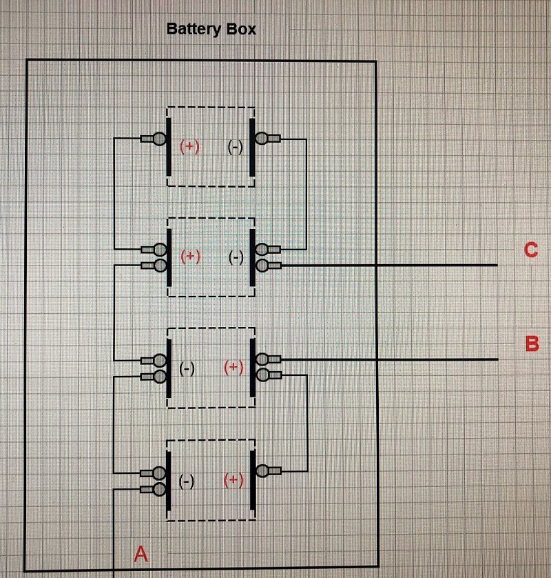

And you can setup a battery bank to be DUAL output power of 24VDC and 12VDC simultaneously too.
point A= 12V for legacy components
point B= 24V for modern components
point C= ground
