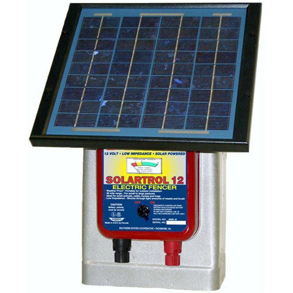

Hello Fellow TBNers:D
I put up a solar electric fence earlier this year around 2-3 ac of veggies to keep the deer out. It worked great. I put it up rather quickly in 1/2 day and decided to take it down for the winter as I plan to rotate the garden spot next spring.
I did not want to leave the charger at the field since it is 1/4 mile by trail from the house and I don't get down there much in the winter except for the weekend.
I currently have the charger on a shelf in my garage but thought it may be better to leave it outside so the sun could keep the charge up. This is the first solar charger I have had so I don't really know if it would make that much of a difference, after all it was at Southern States for a couple of years in storage.
Does anyone know which way would be best, or does it really matter.
It is the same as the pic attached.
Thanks
David

does the manual offer any help on storage? If not, then consider the battery type used (it does have a battery, right?)
NiCad, they develop memory if not fully discharged and fully recharged and they don't like to be on charger all the time.
NiMH, like NiCad, but without memory problem so much.
LiION, no memory and like to be kept charged.
good luck!
/ Solar Electric Fence Storage Question #3
That charger, like most I've seen, uses a Gel type lead acid battery.
Here is a link to the OEM for your charger that describes the storage procedure.
Parker McCrory Mfg Co
good luck!
My first choice was to check the manual. However, I put it up where I knew I would not forget where it was. I have not forgotten where it is...I just can't remember where it is:(:eek:
Second choice TBN:)
