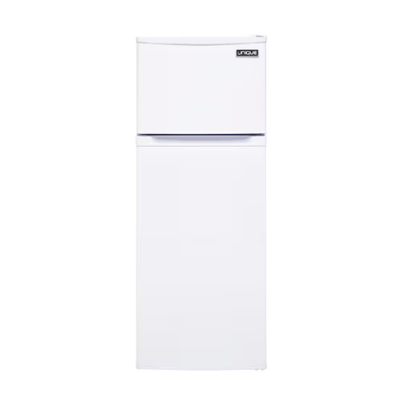

So now, 12/24V Solar Fridge direct, runs all summer weather being topped up evenings or not. Draws 4.5A@12V while cooling. Compressor kicks in 3-5 time/hour (depending on Door Openings and Temp) for 5 minute/cycle.
Very Happy with the results. Best $ I have spent on the system.
Unique's UGP 170L DC solar powered fridge/freezer allows you to enjoy the natural beauty and soundscapes of your surroundings without the never-ending whine and smell of a gas powered generator. Designed for optimal energy savings and easy, dependable use, this 170 L (6.0 cu. ft.) refrigerator boasts a DC compressor and super-efficient insulation with simple effortless controls.
  1. Operation: DC Power, 12V / 24V
  2. Total Watt. Hr. Draw (24V DC): 520 Wh/ 24 hrs (set to -14C freezer/+4C fridge performance in a +25C ambient)
  3. Total Amp. Hr. Draw (24V DC): 19.8 Ah/ 24 hrs (set to -14C freezer/+4C fridge performance in a +25C ambient)
  4. Power Consumption: 52 W on 12V/24V - Average Run Current: 4.3A on 12V & 2.2A on 24V Fridge Temp. Range: -4 C to +10°C Freezer Temp. Range: -15°C to -6°
  5. Interior LED light - Operational error code warning system - 8ft electrical wire cut end included
  6. In-line fuse for protection - Thermostat - 4 heavy duty glass shelves & 3 door shelves - 2 bottom crisper drawers
  7. Curbside Shipping: This item will be delivered to your curb or the receiving area of your job site
