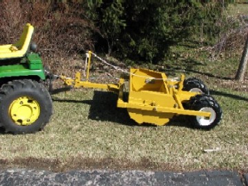

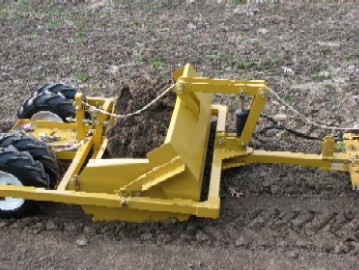

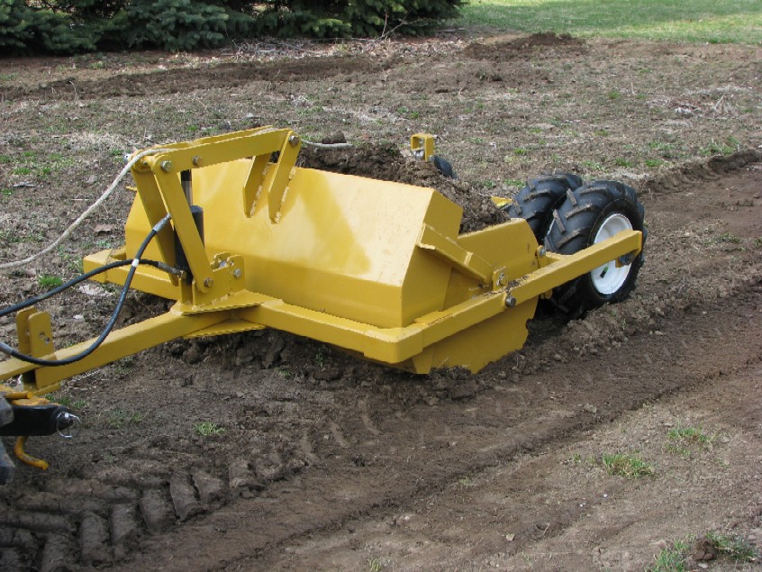

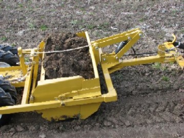

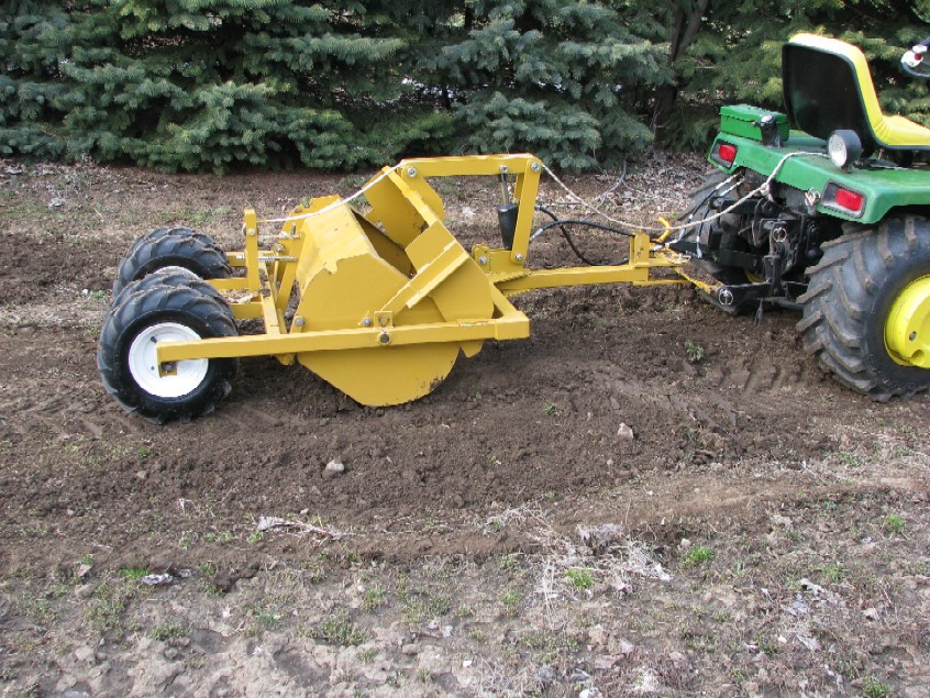

I acquired a SoilMover-Scraper copied and built by MJ from an original SoilMover sold as allied equipment for John Deere garden tractors in the late 1960's. The roll-over bowl style scraper was raised and lowered by a rear hitch on the tractor. A cable hooked to the tractor, operated the apron (gate) to open and close the scraper bowl.

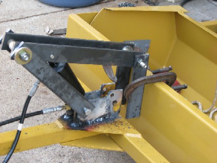

After trying it out, I was dis-satisfied with the apron control and decided to rebuild the apron controlto be operated by hydraulics. I have a John Deere 420 which has 3 hydraulic functions, including a three point hitch and two other controls. I removed all of the cable mechanism and sat down at the CAD system and designed a new actuator.
The 36" wide scraper has an approximate 1/3 cu. yd capacity and fill in 15 to 20 feet. The new hydraulic gate control can spread from 1-2" to 4" deep and is now easily controlled.

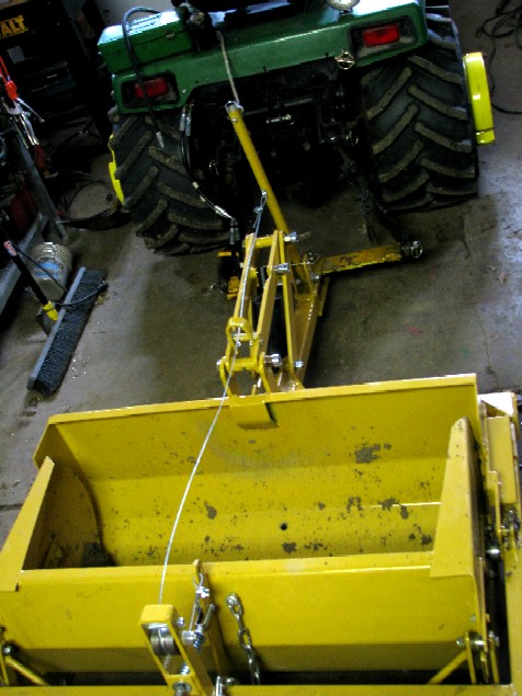

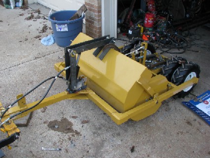

This is what is looked like before hydraulic apron control. Note the cable attached to the upper 3 point hitch.

That is great! Have you found that you can control the digging depth easily? You control that with the 3pt? Since the dump is mechanical rollover function, how do you control the spread of the dirt? I know that the apron would hold it back, but it would still dump with the bowl upside-down.
Great mod to a useful "toy."
Mike
/ SoilMover - Scraper

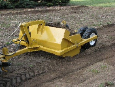

The cutting edge of the bowl rolls over to a dump position stop. By gauging the height of the 3 point, you control the height of the cutting edge, which controls the depth of the spread of the material. It takes a little practice, but you can spread form 1 to 4" deep, depending on the material your moving.

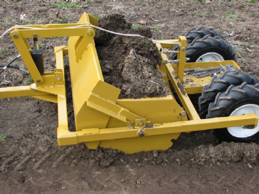

I posted several larger pictures as requested. Anything specific you would like to see?
Cutting edge is 36" wide.
Holds approximately 1/3 cu. yd. heaped.
Can spread from 1 to 4 inches in depth - depends on the operator and the soil.
Also removed the bowl trip rope and added a cable and a trip latch lever - see the last (right) picture. The trip rope doesn't "cut the corner" now, so you can dump going around a corner.

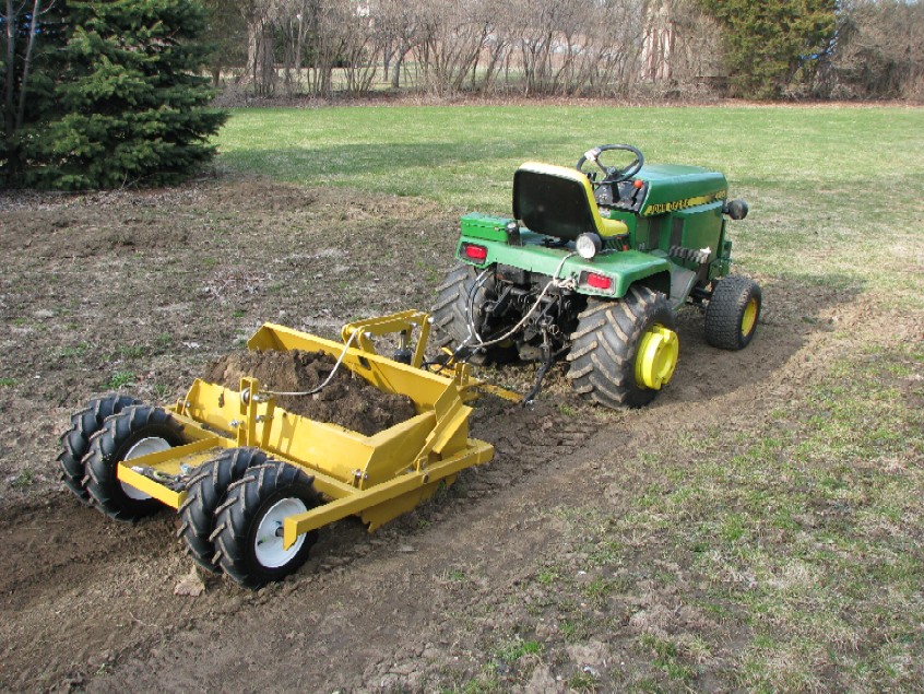

The tractor is an old JD 420 with a replacement 24hp Honda engine. Traction is not a problem with reasonable - 1-3" cuts. I haven't tried it in solid sod yet - too wet. I believe that it will work best if you scarify the sod first - BUT I will let you know in several weeks. It loads a heaping scraper in 15 to 20 feet in a mix of weeds, clumps of grass and moist earth. I also will try pulling it with my JD 455 diesel.

I had an opportunity to really put the SoilMover to use today. I moved about 2 1/2 cu yds of earth / topsoil from a "hump" to an area that required leveling and seeding. It took approximately 45 minutes to move the 2.5 cu yds about 200 feet and spread it over the area to be seeded and I never had to souch a shovel.
I do need to remodel the dump latch lever to something more easily accessable - perhaps a left foot pedal or a hand lever mounted to the fender deck. John
