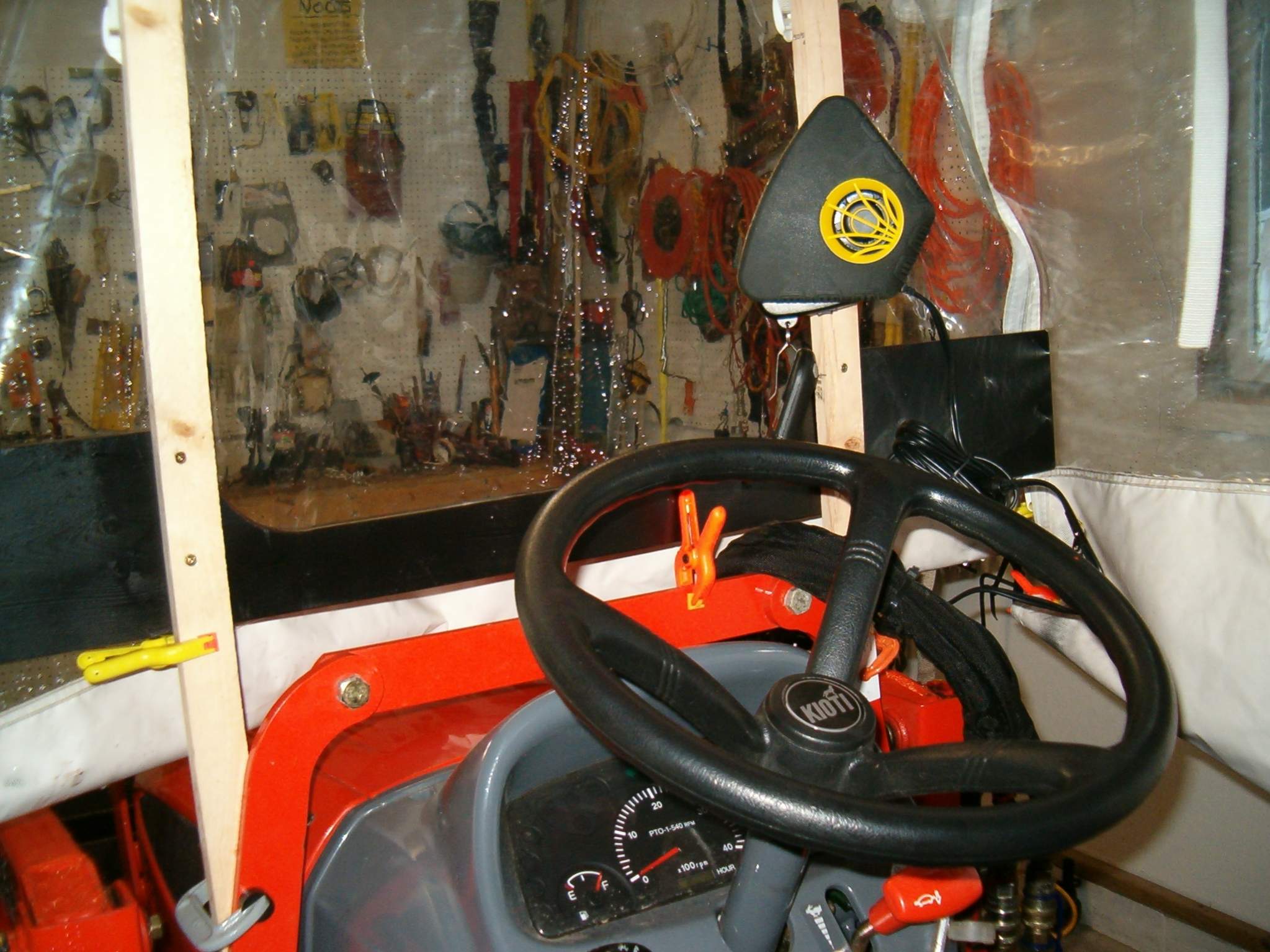

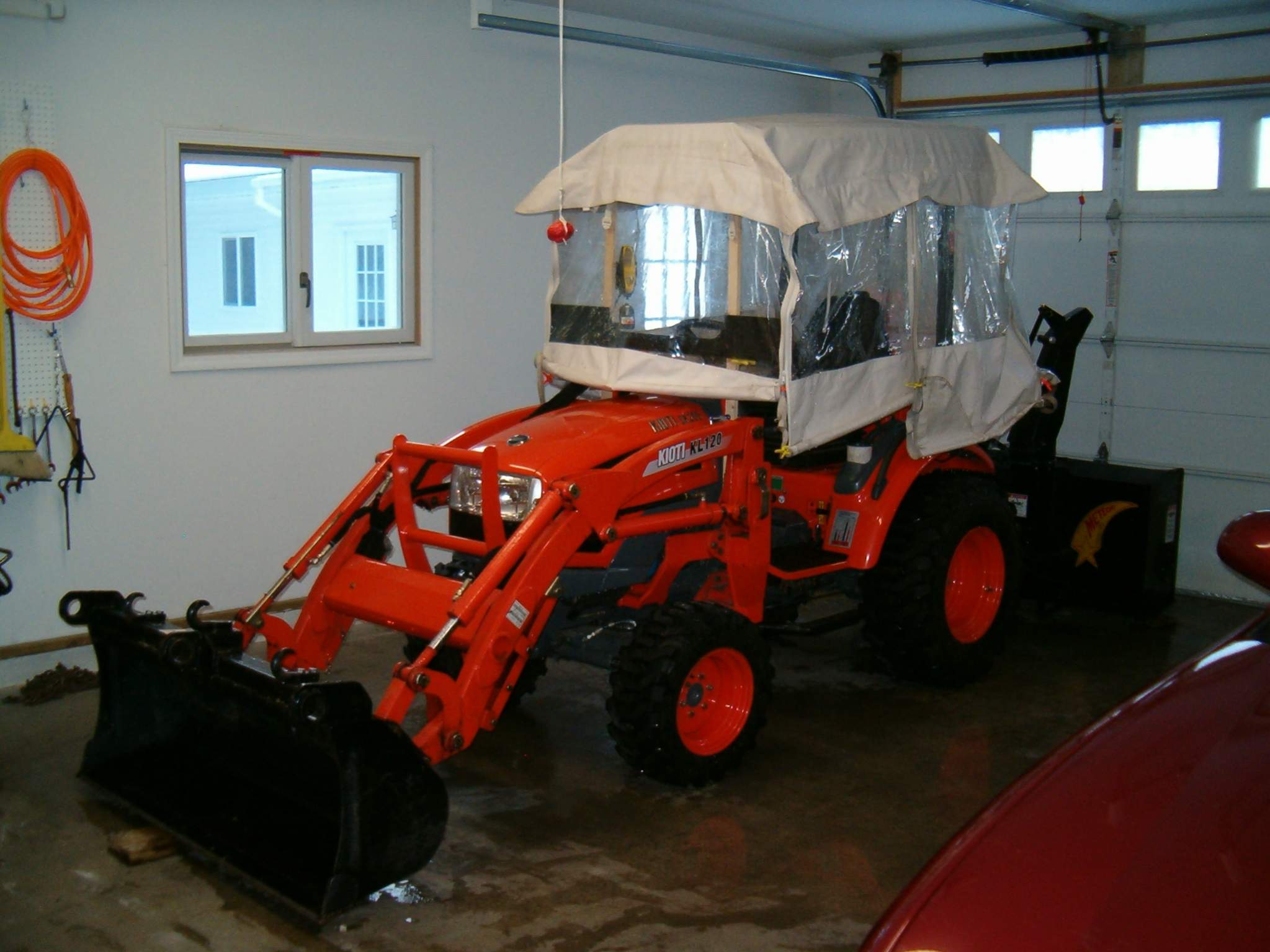

OK, first of all your store bought cab costing over $1600 is very nice but I'm not seeing that much difference between the one you are considering and my home made model shown below in the picture. I admit mine is uglier but I can live with it because I have no more than $200-300 bucks invested in mine and I can stand alot of ugly for that kind of money. My model is nothing more than a top consisting of a Kioti ROPS mounted top, a golf cart cover and a couple of wood or aluminum front supports running from my FEL cross brace to the Kioti front area roof deck for support. I wired in a lighter and plug in an automotive heater ($35.00). It is a bit drafty but it keeps the wind and blowing snow off my face when I do my snow blowing. No windshield wiper but a backhand to the window panel area expels any sticking snow. I have had this model in use for four years now and live in the U.P. of Michigan. In the summer the top goes back on the golf cart for dual use.
Ugliness can be beautiful.
rimshot
Thanks for the pic's Rimshot, I had considered making one. We have a lot of Amish where we live and they make stuff like this for there buggy's.
Definitely food for thought

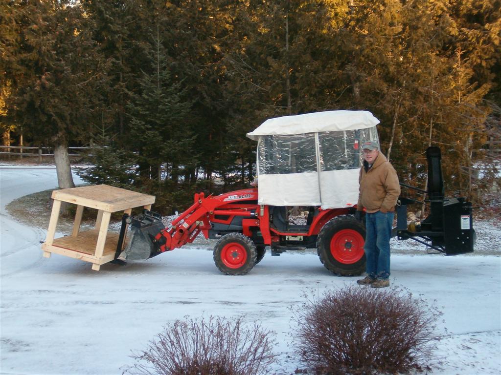

I just finished putting a golf cart enclosure on my EX3200 and it fits a bit tighter than rimshot's does. I bought it last year for my SC2400 and used it twice on that tractor and it kept the wind and snow off of me. Total cost was about $80 from northern. I'll post a few pics of it in the next few days.
/ Soft cab for CK35HST Advice #12
Here's a few pictures of what my soft cab looks like on my EX3200. For the total cost of $80 it works very well. EX3200 Front view.jpgEX3200 side view.jpgEX3200 Rear view.jpg
