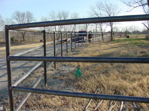

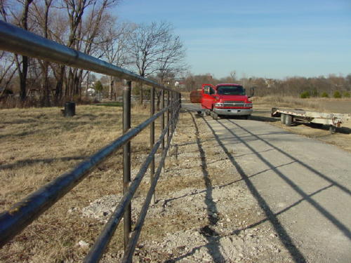

For about six months I've been working on a couple of different things. One of them is a way for the less experienced but just as energetic homeowner to do their own pipe fence.
I had a great idea. It was wonderfulemousosis.
Then a bud had a better idea.
Here's his. But please understand he would never had this idea without mine to inspire him, darn his hide!

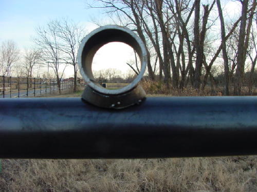

I had this thing where we cut a piece of pipe one and an eighth inches and then double notched it to make that joint his does with a simpler to make and even more flexible piece.

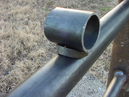

   / So you want to do your own pipe fence??????
You see with this piece one can have two and three eighths posts and two and three eighths rail or even two and seven eighths posts and two and three eighths rail or two and three eighths posts and two and seven eighths rail.

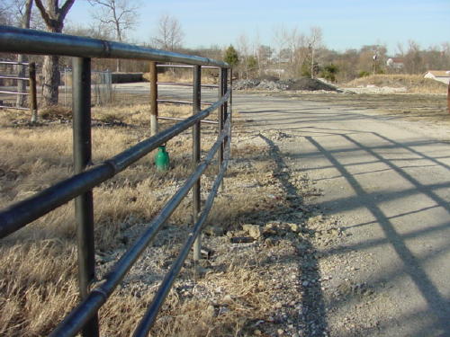

Here you go. A four rail five and a half foot high two and three eighths (two inche schedule forty pipe) posts and rail fence.

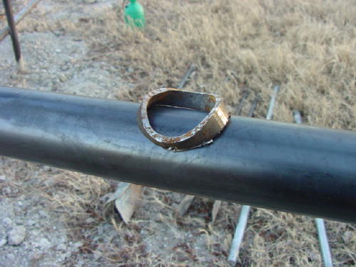

close up of joint all welded up

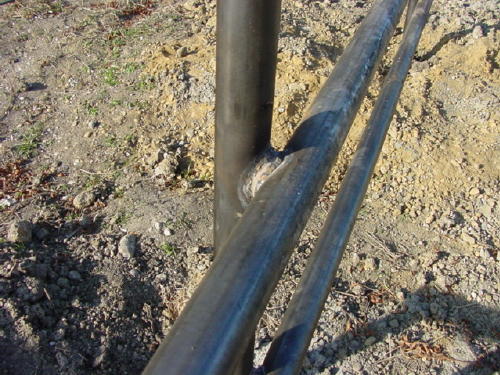

another view
Let's put things into perspective. Around here a four rail new black pipe fence like this goes for fifteen to eighteen dollars a foot if it's done the regular way where each rail is cut in and welded between the posts.
Same job, same amount of welding, no cutting or fitting to speak of and since the piece provides as much of a welding area as the cut in joint does, just as strong. And the contractor can charge twenty five percent less and actually put more money per hour in his pocket.
But for the do it yourselfer with a welder and some initiative it is no longer an intimidating nightmare of learning to use a torch besides learned to weld.
The first question that's always asked is, "how do you do gates and corners with the rails on the side?"
Nothing but a thing dahlin', nothing but a thing. You do the corners the same and you use the same gates.
I use the eye. But most folks use a string line to lay out their posts. The beauty of this system is it's made for the the stringline.
You set your end, corner, and gate posts on side of the string. You put your line posts on the other. That means your rails end into the gate, end, and corner posts just like regular pipe fence does.
Now I had to make up some helper tools, mostly because I'm too much of a hardheaded one way son of a gun to have help hang around long.
There's not much to it. And everyone who's seen it, competitors, friends, customers, think it looks as good as conventionally done pipe fence, and the savings? Well, that's sorta like the ease of doing it, down right nice in it's own way.
