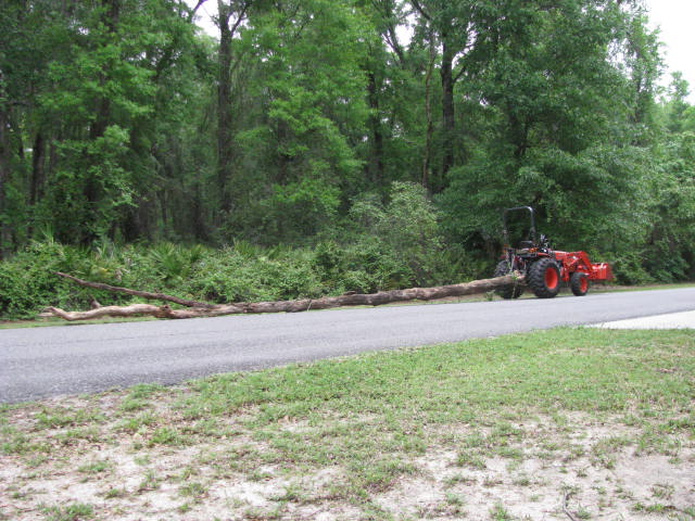

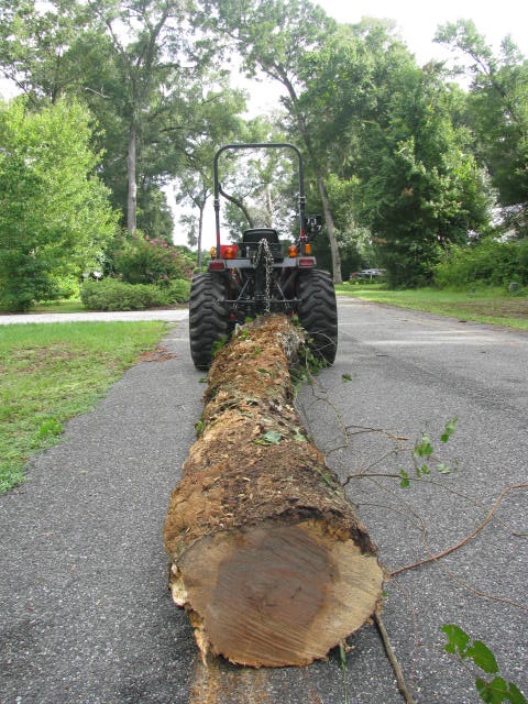

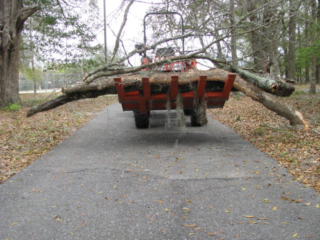

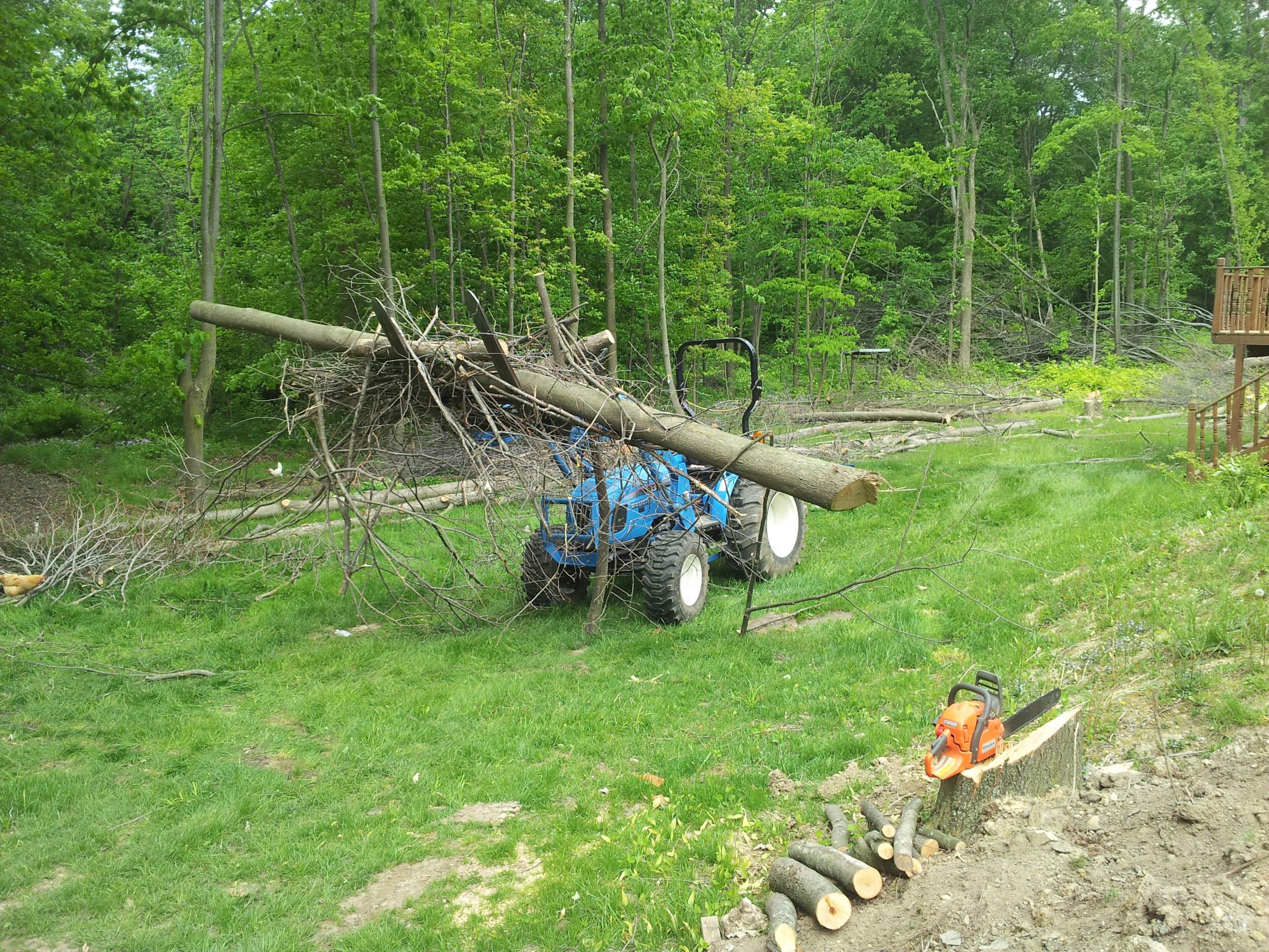

I do not weight my tractor permanently with wheel weights nor filled tires. Permanent weight has major disadvantage of compacting the soil/lawn and minor disadvantage of increasing fuel usage. Consider repairing a puncture in a filled rear tire....
When I need weight I mount an implement on the 3-Pt. hitch. Ballast on the 3-Pt. gives improved traction, and weight behind the rear axle relieves stress on the front axle when you are working with a max load in/on bucket, which for me is log sections ~ neither filled tires nor wheel weights relieve front axle stress.
On occasions, you cannot pick up a max bucket load without rear ballast. Instead of the bucket coming up, the tractor will kneel and you are really stressing it.
If you think you need more permanent tractor weight buy a tractor with a heavier frame.

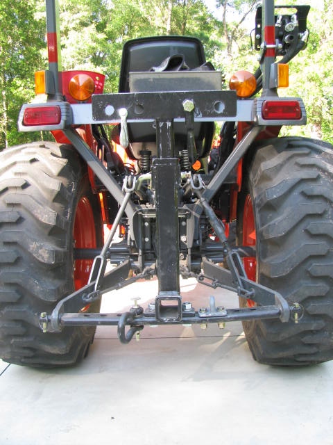

My 60" wide tractor moves through the woods well. I have rarely feel desire for a winch. I skid using an Omni Hanging Tree mounted on an Omni Cross-Drawbar Stabilizer, which Omni calls a combination hitch. You drag logs CAREFULLY to an accessible area with chain attached to the (TSC) cross-drawbar, then raise log with Hanging Tree to transport safely. Had I to do it over I would consider a Northern Tool Log Hog*. Omni now offers a Log Boom, I see.
(If a log being dragged encounters an immovable object [boulder, rock ledge, burrow etc.] while the tractor is powering forward, the tractor can go vertical on its rear wheels in a heartbeat. A heartbeat! )

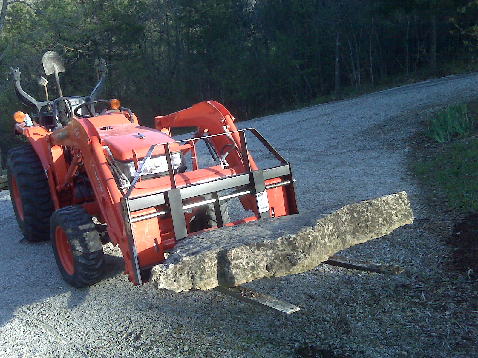

In general, weight helps traction. Wheel weights, and loaded tires are the ticket for pulling ground engaging implements, but not very helpful when using the FEL.
Without a rear counterweight, my tractor can only lift a bit more than half the loader's rated weight. It's listed as lifting 2,640lbs to max height, at the pins. It was getting very light on the rears when lifting the 1300lb slab for my counterweight, and slightly lifted the rears a few times. Add the weight of the pallet forks, and it was lifting something like 1,700lbs....but it wouldn't have been safe on anything but the flat concrete I was on.
Check your manual, and it'll probably give you an exact figure for what the recommend for counterweight. Here's mine:
Why is your tractor rated to lift 140# more than mine? ;)
