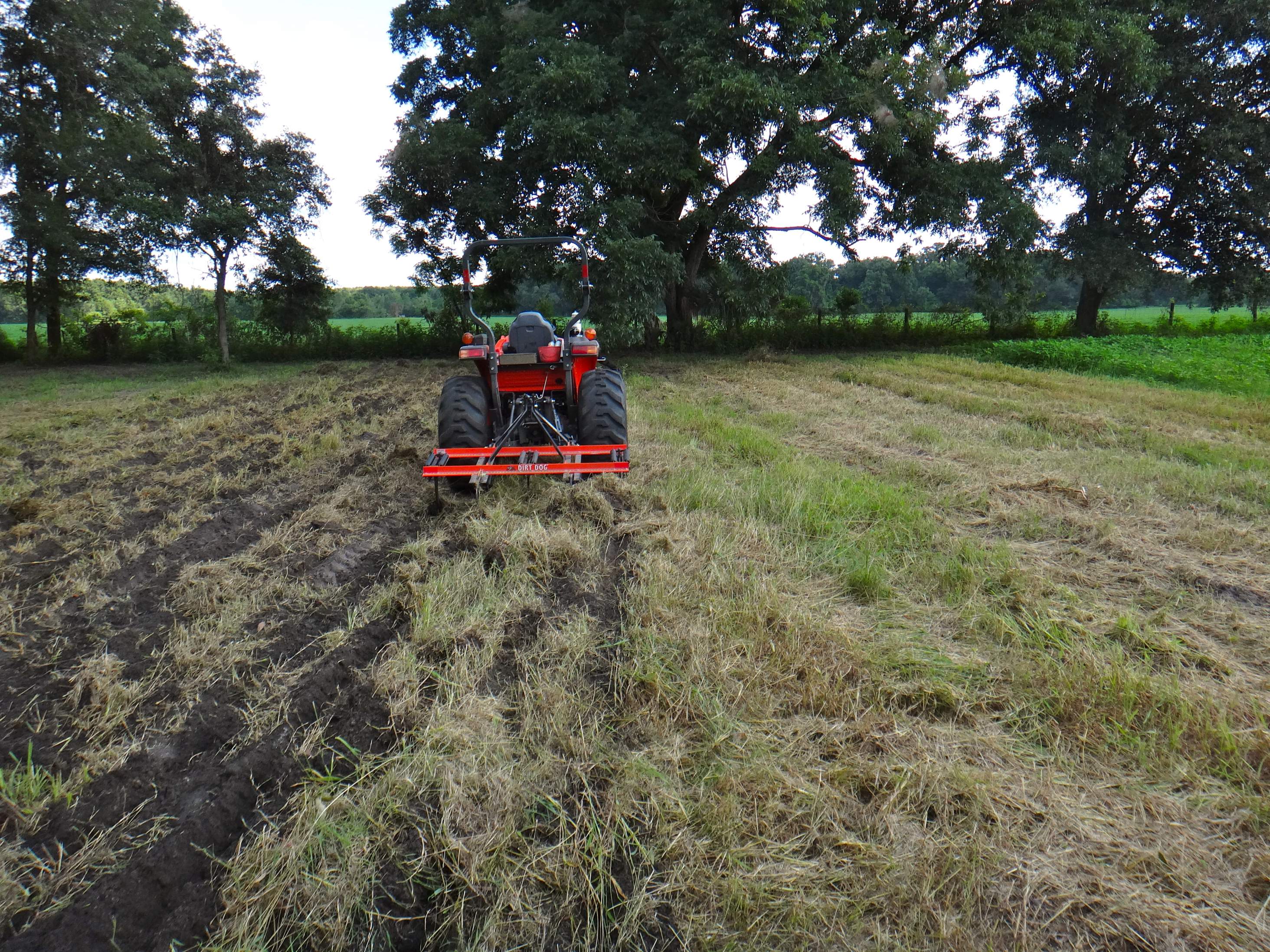

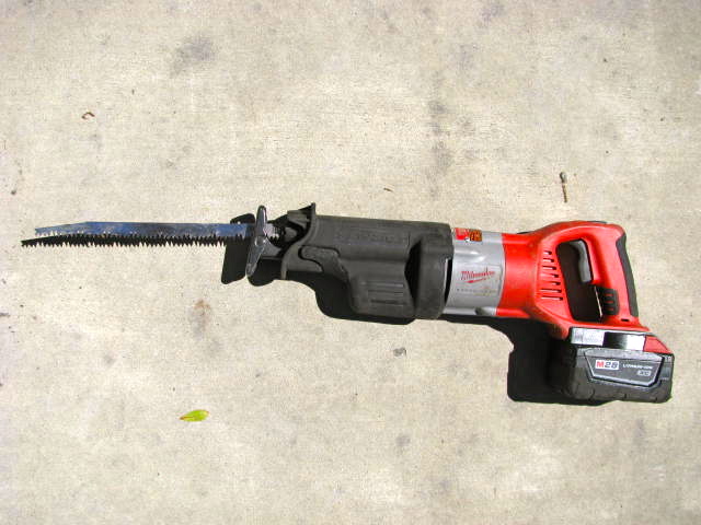

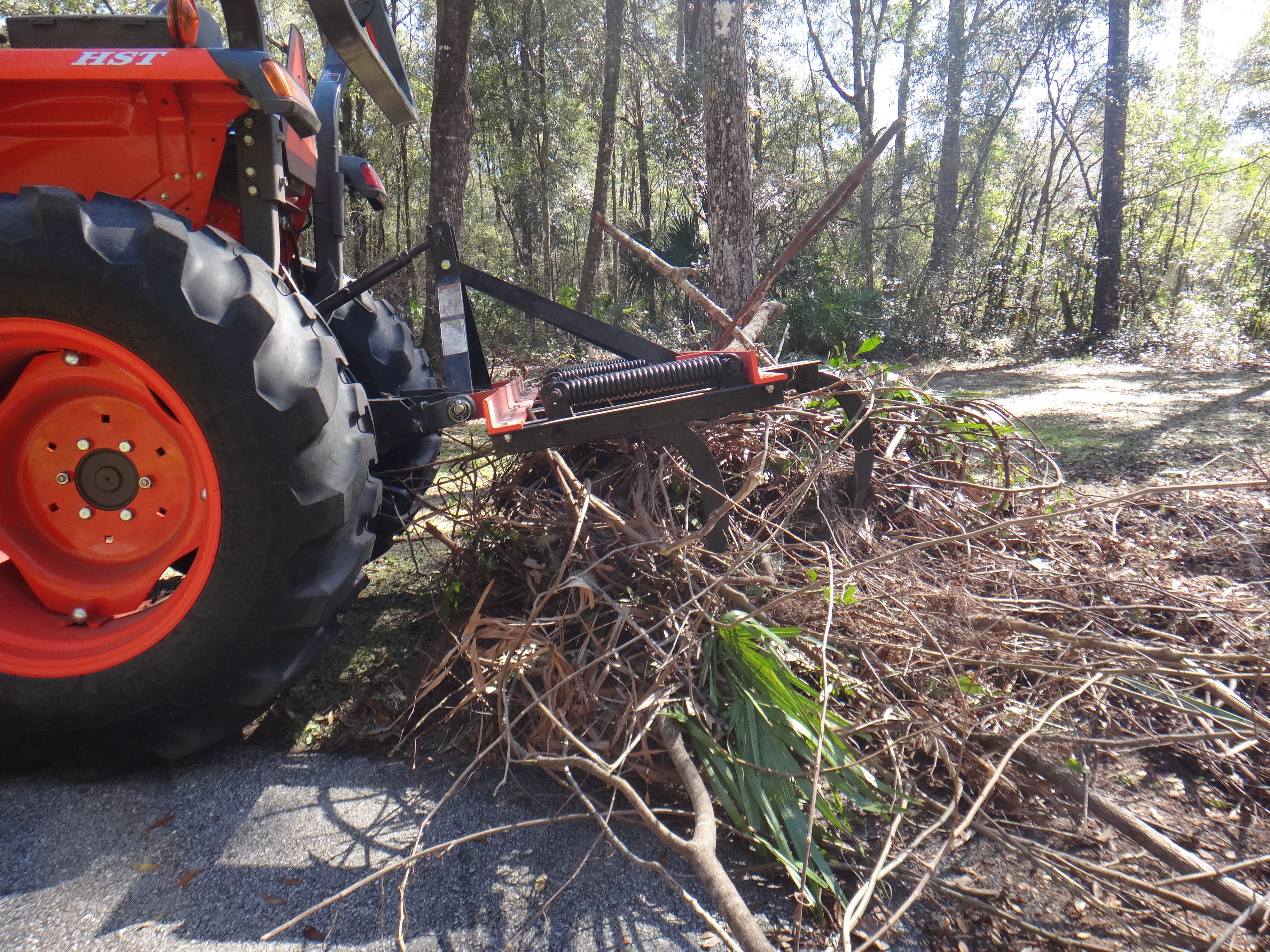

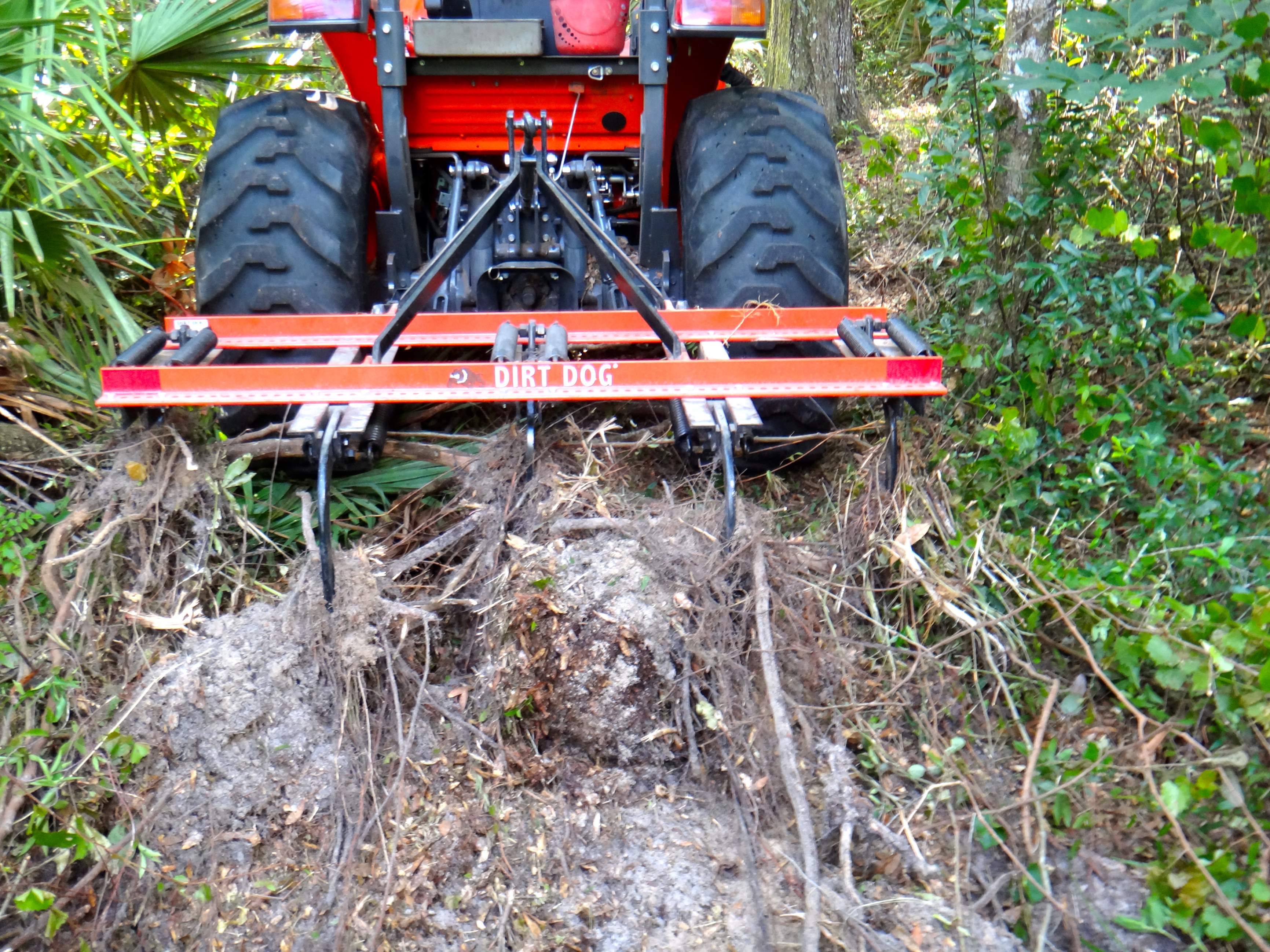

I work in sandy Florida Oak jungle regularly. A 60" wide tractor, pulling a 60" wide Bush Hog works fine for me, where a 66" wide tractor would be too wide.

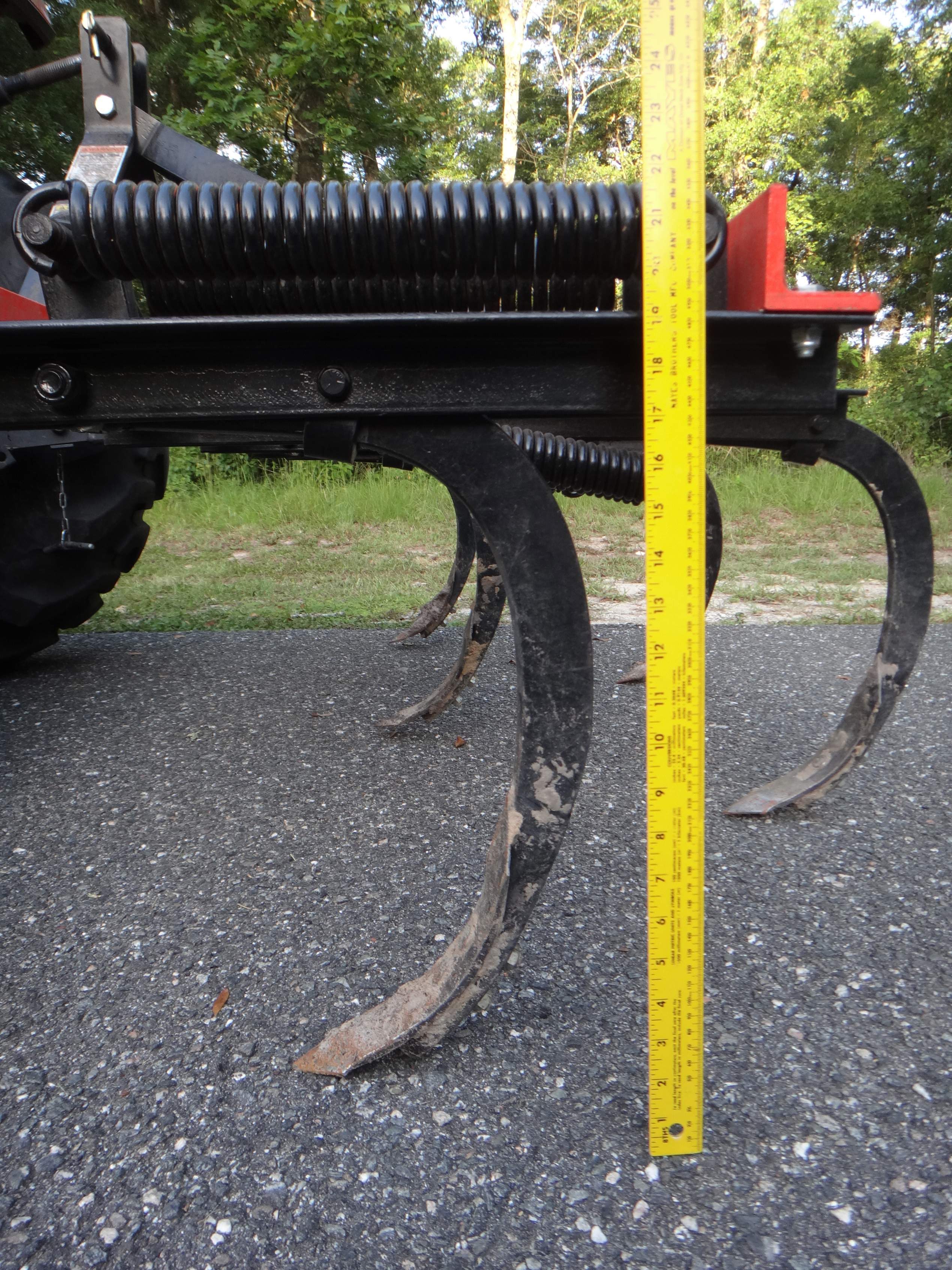

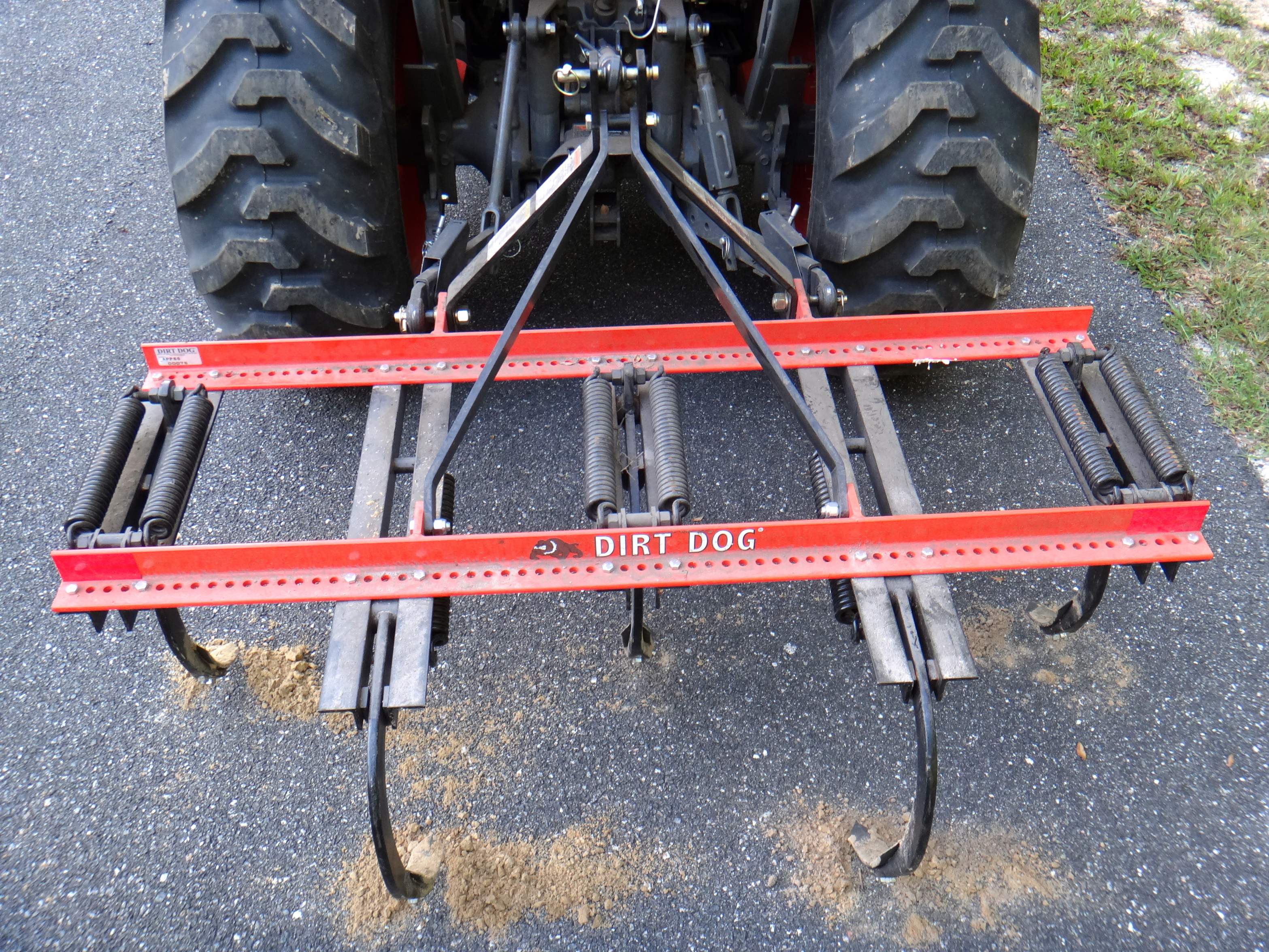

The tools I use for clearing are a pro-grade chainsaw, a battery powered reciprocating saw, a Ratchet Rake bucket attachment and a Dirt Dog (brand) All Purpose Plow, which is more commonly called a Field Cultivator. I use chains to tow downed tree trunks.
I burn the debris.
Bush Hog is for post-clearance maintenance.
No compact tractor can be used in a swamp or bog. Tractors bog easily. For digging in bogs you need a track mounted mini-excavator with a long-reach arm.

Yes, 12" to 14" ground clearance is hugely better than 9" ground clearance, reduced to 4" ground clearance with MMM attached. Subcompacts are fine as MOWERS; pretty limited at real tractor tasks.
Tractor manufactures have at least one entry which is relatively heavy, but has an engine just below 25-horsepower, which is where strict/expensive diesel emission controls become mandatory. Kubota's entry is the L2501.
Subcompacts are around 1,400 pounds, bare tractor. "Cheaters", like the L2501, are typically around 2,600 pounds, bare tractor. This is an important category for you to research.
