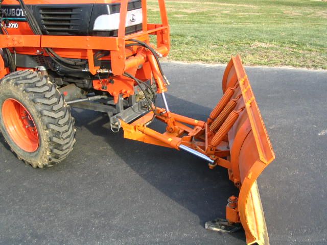

Kubota L3010
Old Meyers snow plow mounted to Kubota L3010. Fabricated sub-frame to fit tractor utilizing loader mounts. Also added hydraulics to raise and lower (float)blade. Also added power angle.Also made some structural changes to plow "A" frame.

Very nice use for an old Meyers plow I might add. Were you lucky enough to get a good price on the plow itself?

Yes! I paid $150.00 for the plow itself. I spent as much on the hydraulics(hoses,cylinders etc.),but I'am pleased with the outcome.

Nice job on the plow hookup. I've been considering doing the same with my 6.5 foot Fisher from my S-10. Although it would be in the bucket. Did you find your plow setup in the WantAdvertiser? Sometimes I see a lot of them in there for cheap money. During the summer months is the best time to buy one.

No! I was rummaging through mostly junk section of a local equipment dealer,when I stumbled on to the plow.

Hey botaman2- NICE JOB!!!. I picked up a 7' Myers plow 2 years ago from an ad I saw on a car at the Plainfield Central School car show- the guy lived about 3 miles from my house and he delivered it for $50 /forums/images/graemlins/grin.gif /forums/images/graemlins/grin.gif /forums/images/graemlins/grin.gif. I've been planning to make a similar setup to yours, but I would sure like to see that setup up close- ????
